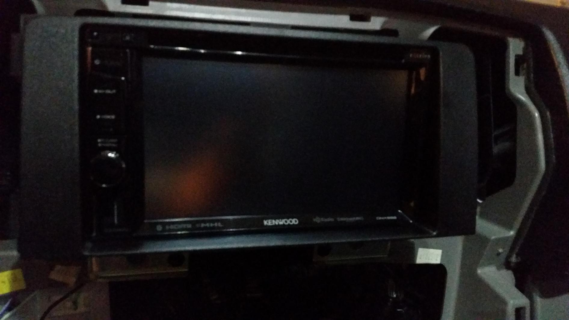

I'm using the metra 95-8210 dash kit for my Kenwood double din. Right now, this is how it fits. Its as far back on the radio as it will go. Is that large lip at the bottom normal? Or am I missing something? The silver center dash piece fits over it perfectly.

I bought the 95-8202. It fits perfectly. I think you might trim off the upper and lower parts of the 95-8210.
Ya I bought the 8202 also and it had gaps still on the sides. Ended up cutting the bottom lip off the 8210 and got it to fit much better.
I have same dash kit, but top of the line JVC head unit. When HU not powered lower lip looks just like on your picture. But my deck has option of tilt. In settings I select 2nd option for angle and once deck gets some power it tilts up and lower lip dissappears. Have you powered your HU? You may have same option of tilting.
PS. After looking closer on your deck I see that it has slot for CDs where mine is hidden behind motorized face plate. This makes me think that your faceplate is not motorized and doesnt have tilt option

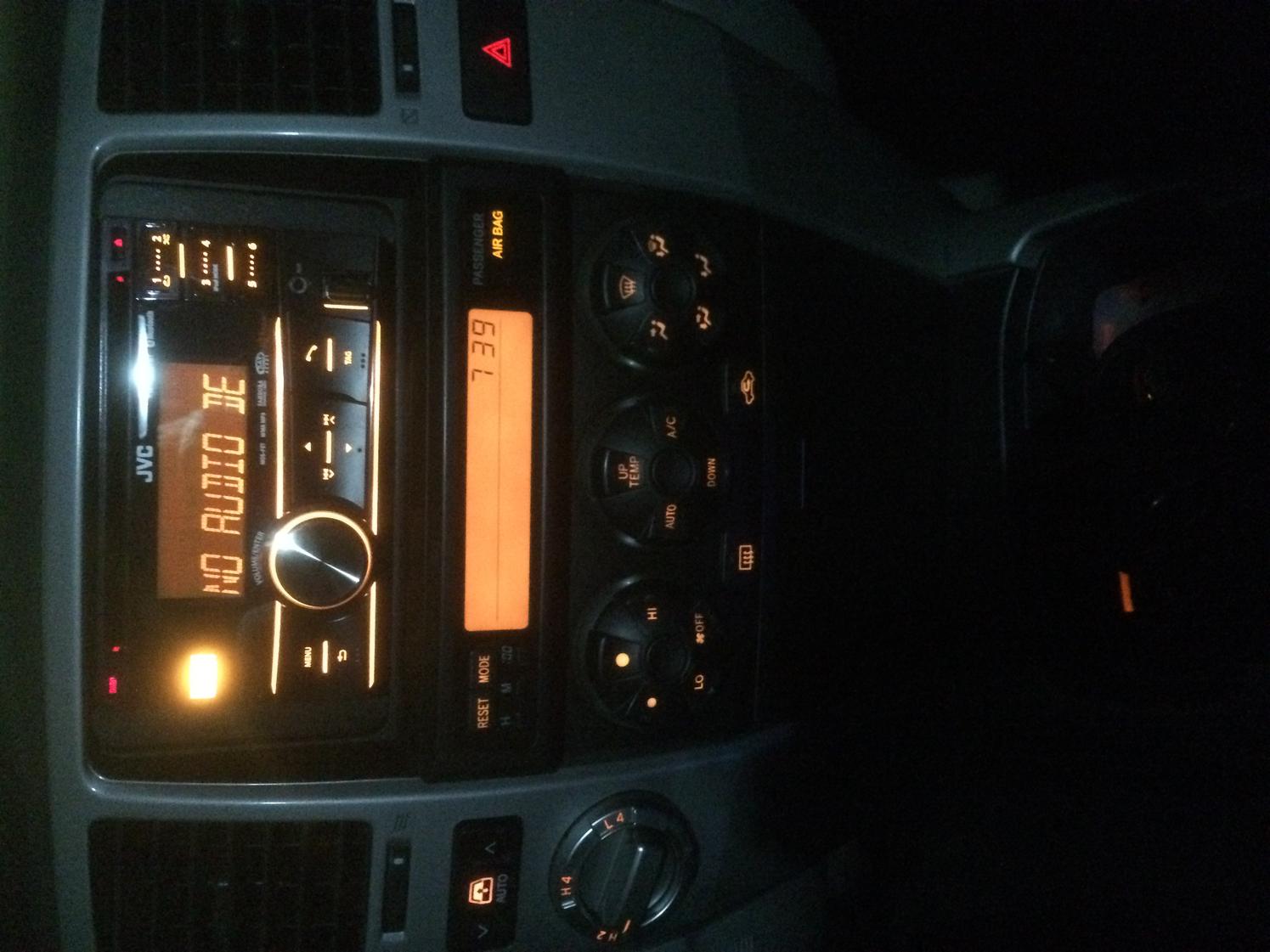

I used a Metra 95-8202, and it turned out well -- no lip, and no gaps. As you can see, I went with a DD JVC unit trying to go for stealth as to not attract attention -- but one that put out great (non-amplified, for the time being) sound. It does just what I wanted it to do and color matches nicely.

^Yours looks nice and looks stock esp with how the buttons stick out along with the matching orange buttons.
