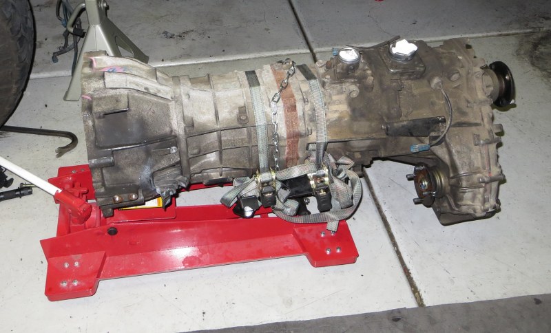

Hey guys,

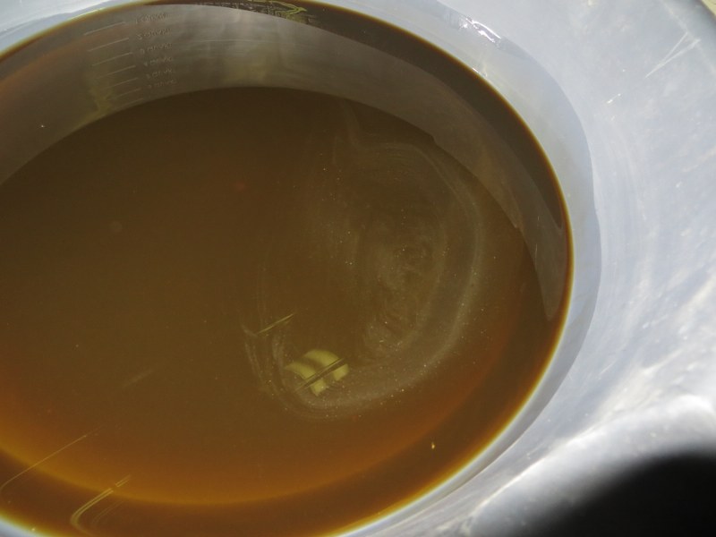

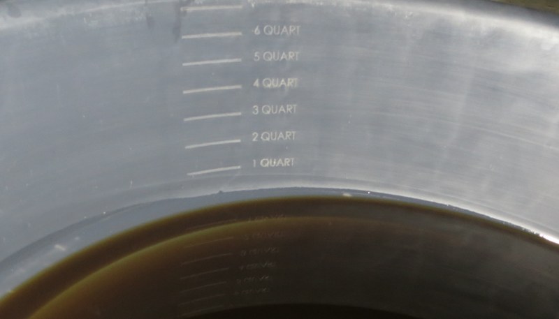

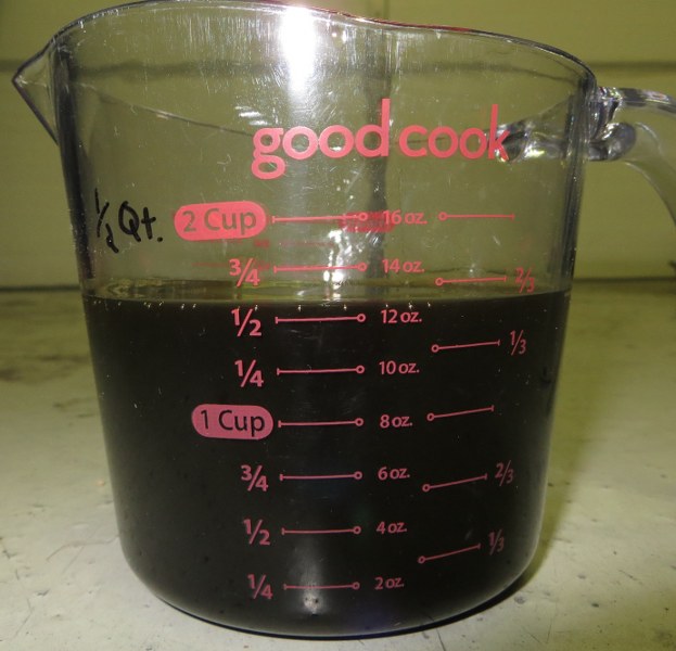

Just drained the oil out of the t-case on a new-to-me '99 SR5 5speed, and found it was very low - about 13oz (less than 1/2 quart). No scary metal chunks or shavings, but some fine stuff - roughly what I would expect from a healthy unit to be honest...
I assume the bearings (among other items) aren't too happy. So the question is what to look for, and what definitely needs to be replaced? I'm very mechanically inclined, and plan to fix this the right way.

It didn't appear to be leaking, but then it didn't have much in it to begin with.
I would hope no one is dumb enough to not properly fill, so my best guess is that it could have a leak.
I'm in the process of pulling the trans to do the clutch, so its coming out anyway.
Fill it back up and drive it. A transfer case isn't like an engine, where low oil will cause a loss of pressure and ruin it quickly. They're designed with a pretty wide range of acceptable fluid levels in mind, and the fluid is also part of the cooling mechanism. That's intended to handle the worst case scenarios (crazy stuff like towing at max capacity in 4WD in Death Valley in the middle of the summer), and the truck has probably never seen that. It's unlikely you've done any damage at all.

I've already got it out (clutch job). It is not my daily driver, so at least I have that going for me. It never leaked a drop in the few months I've owned it, though it looks like it could've been leaking judging by the fine layer of grime on the tcase - but its not soppy wet like I would expect (some of that is just the PBBlaster I sprayed on bolts). The only thing out of the ordinary I found was that the 4mm vacuum/breather tube at the top was disconnected.
Problem is I don't know if it has a leak or not, and I'm already this far into it. I would kick myself if I have to yank this monster again because it indeed has a leak.

You don't have to pull the whole transmission out to get the transfer case off. Just drop the driveshafts, pull the shift lever and unbolt it. I would just put oil in it and drive it, there are a lot more abused transfer cases driving around perfectly fine. If you are really worried look around for a good used one and stash it until you need it

It's cleaner than mine was when I did my clutch two years ago, and mine doesn't leak. I do change it every 50k and maybe it is down by the width of my little finger when I do. Sometimes fluid comes out. (Due to temp change, I assume.) Don't go fixing a leak that isn't there. You are probably looking at what is left of a factory fill. Put in some new fluid and drive on.

For the record: before I drained it I could stick my pinky all the way in the fill hole and could not touch oil.
While I possess the necessary equipment and manuals to rebuild this box, I am leaning towards replacing input and output shaft seals (precautionary), and running it. The relatively good condition of the drained oil also makes me hopeful.
