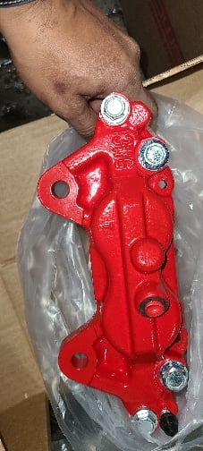

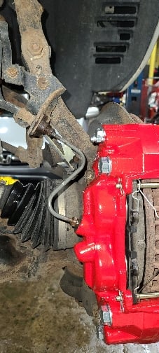

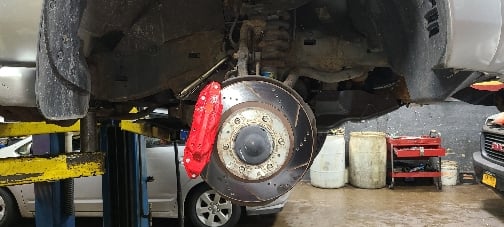

The brake hose was find! The front passenger caliper was frozen not letting the wheel move free.
Yesterday I drove 55min on the highway and no vibration.
I had power stop front brake kit. I replace the calipers and brake pads with power stop caliper and pads

That's great I'm pleased it got diagnosed it was an easy fix for you!
not a easy fix as I was trying to pin down the vabration for almost 2 month.. I had 3 tire balance 2 of them with HUNTER ROAD FORCE and a set of new tires FALKEN WILDPEAK AT3.
