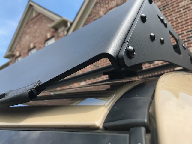

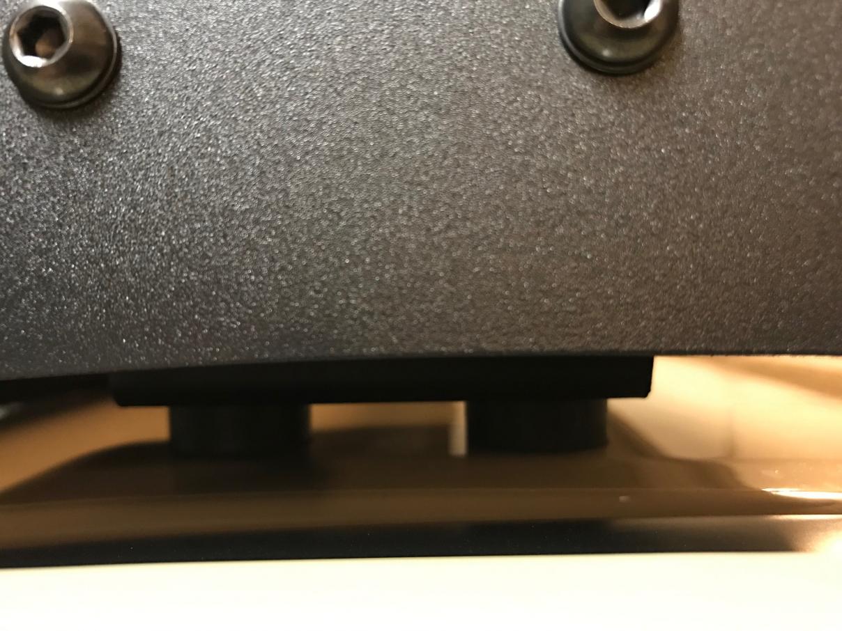

1. They provided 2 screws that install into the 4Runner that didn't fit.

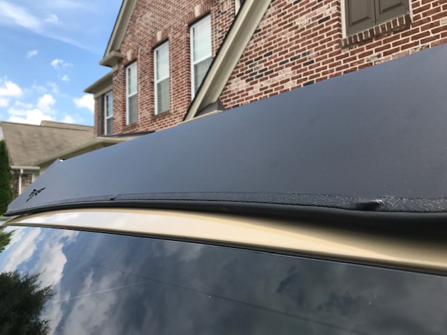

2. The weather strip was zip tied so tightly it bent the weather strip badly.
3. The front support legs wouldn't touch the vehicle.

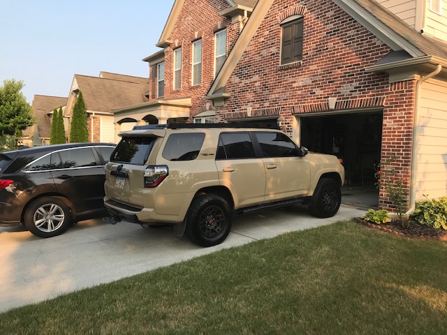

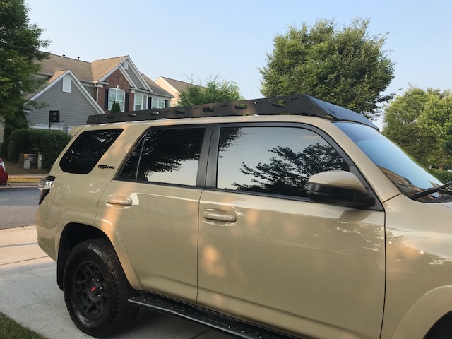

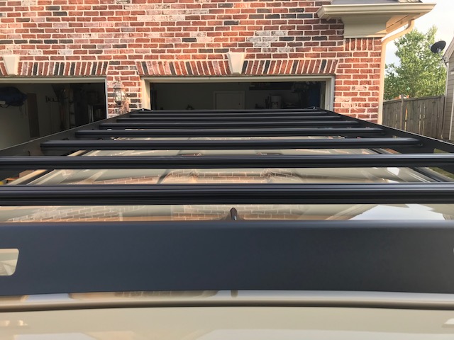

I attached 2 pictures showing the weatherstrip and front leg issue, the rest are just pics of the rack on my vehicle. If anyone wants a different angle or more pics just let me know.

The front mounts have rubber boots you install on the mount and the rubber boot rest on the roof. No holes are cut or drilled. The middle and rear mounts go into the factory locations. I actually had my clearbra guy install a 12 inch clearbra strip on the front, and a 6 inch strip on the rear for where I have the mounts and fairing resting on the vehicle.

Is the front wind faring resting on the roof? Because if so that's no bueno at all.
None of the wind faring should be touching the roof
I intentionally put it on the roof with the weatherstrip, it can be adjusted to not sit on the roof. I had a clearbra put on the roof running back 12 inches to protect the paint from it resting there.
The fairing rests on the roof by design. If it is adjusted up away from the roof, it will contact the roof at high speeds, so to prevent that, it is adjusted all the way down to prevent flexing. We include the edge trim to protect the paint, but as an extra procaution, you can also do what [MENTION=140792]halflife78[/MENTION] did and add clear paint protecting vinyl beneath it as well.
I initially had it higher, but with the front boots resting correctly I didn't notice any issue with the rack flexing. I assume due to the height variance I can get it can go high enough up to not contact the roof, but I could be wrong.
I prefer the look with it resting on the roof.
Gotcha - my point was more to the fact that with only the center touching it might create a pressure point and dimple the roof there. Touching evenly all the way across i'd be less worried, but just in the center i'd be a bit concerned

I just measured and 26 inches of the fairing is resting on my roof due to the angle.

What's the height at the highest point of the rack from the roof?
Victory can provide a more solid answer than me, but the rood slopes down so the rack height is higher in the front while being level across the vehicle. The rear height which looks to be the best measurement point is roughly 3.7 inches or so and that was across 3 measurement points I did. I didn't have much time before my meeting to get pics.
