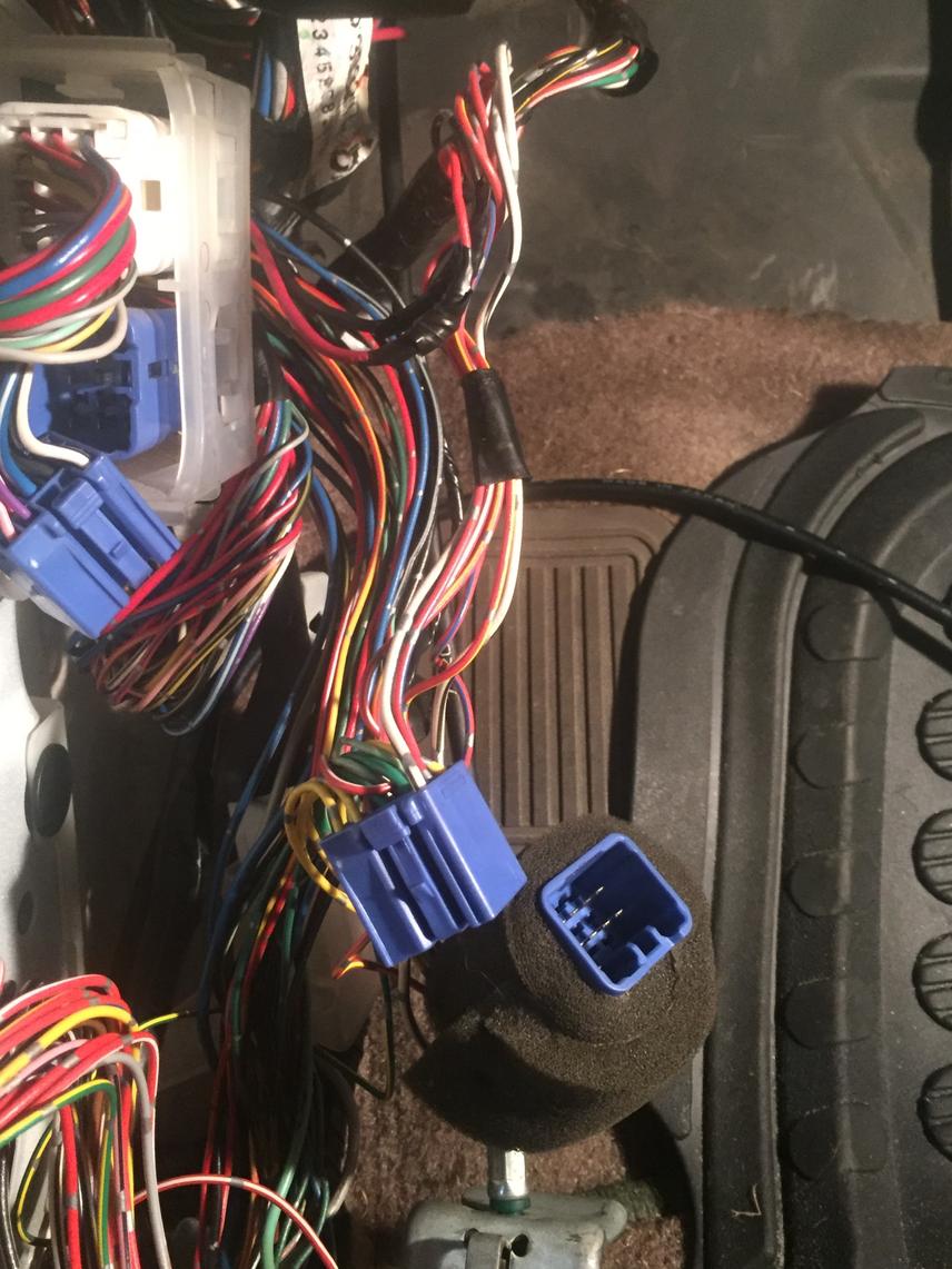

Is this the right box?
I know everything I have read says that the ecu is under the drivers seat but is there anywhere else it might have been put? I have been trying to find the one in my ‘97 4Runner but don’t know if what I found is the right thing? Under the drivers seat is completely flat and the black box I found doesn’t look like it has a green button on it? Can someone show me a picture of the one I am looking for? Thanks!
