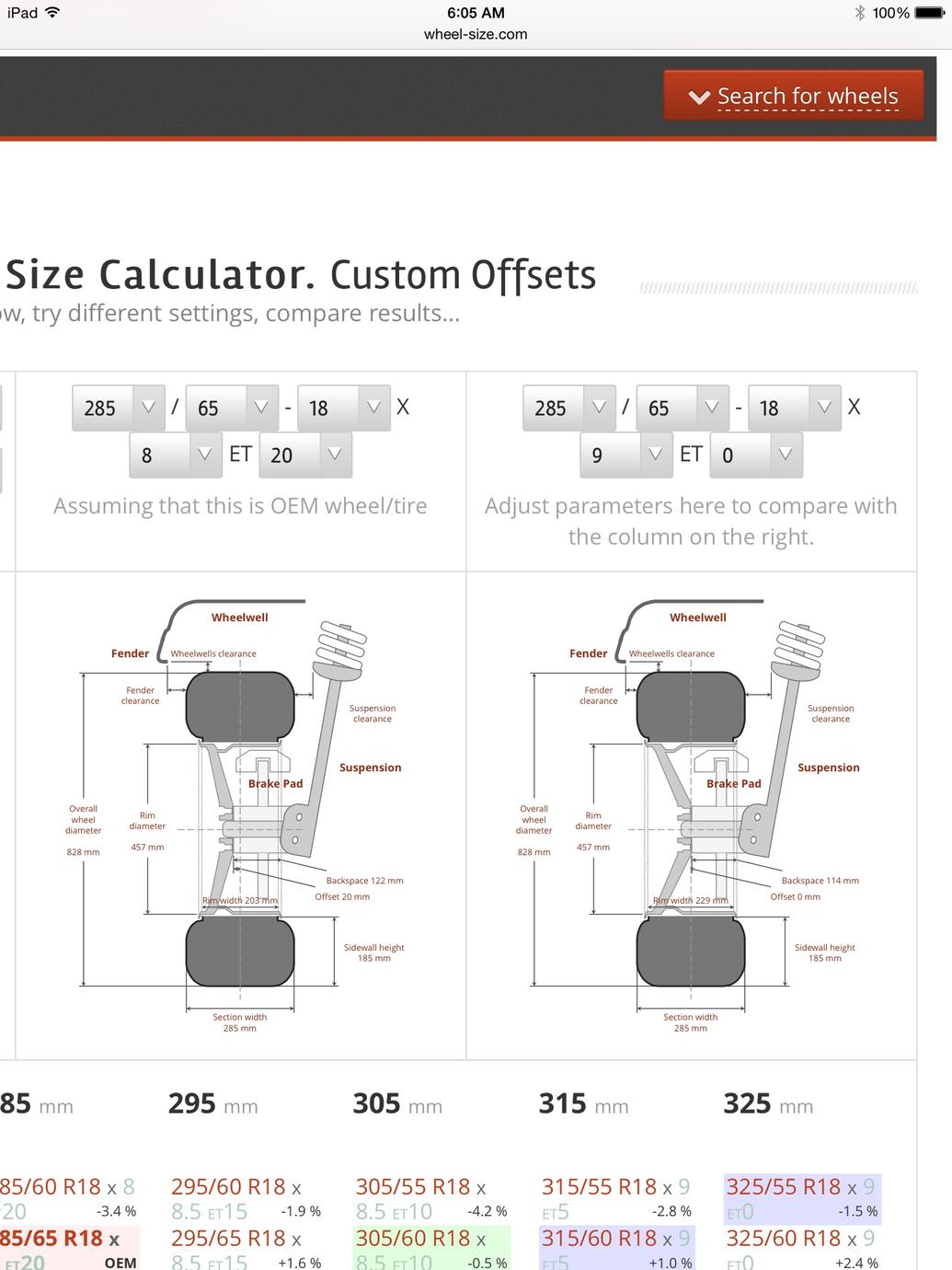

Because Volks only come in 20 or 30 mm offset that I can find... And besides, with a 20mm offset, I'll get 6mm more clearance on the inside and 14 mm more on the outside for a slightly wider track without the need for wheel spacers plus I can go with a slightly wider tire that won't hit/rub the uca or hopefully not..
Several things wrong with this post which makes me wonder where you are getting your information. First, Volk still makes the 0 offset for this application. If not, you can always go with BFD. Second, more negative offset gives you more UCA and tire clearance. A zero offset will have more clearance than +20 wheels in the same width. Again, you are more likely to need spacers with the +20 offset VS the 0 offset.
Good luck with your purchase. Why anyone would pay money for custom wheels in a +20 offset either from a style or tire application standpoint is beyond me. No offense to japsfinest.
Actually, you will get 6mm less clearance on the inside. You will only gain more on the outside. But even with my 18x9 et0, there's plenty of clearance for wider tires even with the 285/65 that I have on. I actually like the -12 offset. Gives a wider stance and footprint. But obviously its your choice. I'm just saying you have more options then you may think.

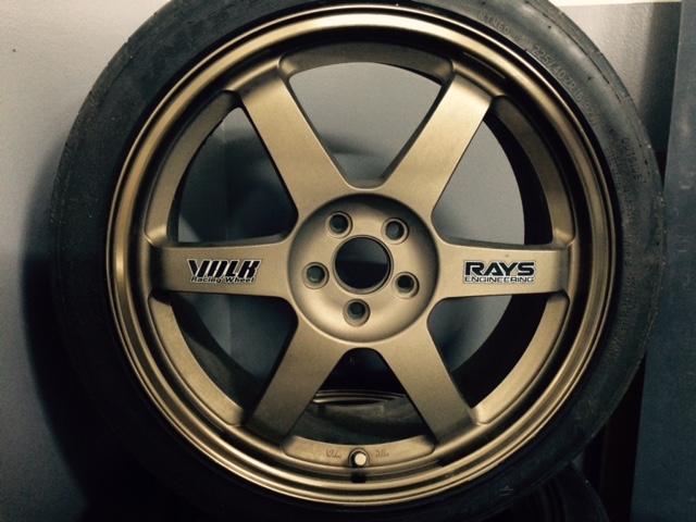

Volk Racing TE37 18x7.5 / 5x100 / Offset +48

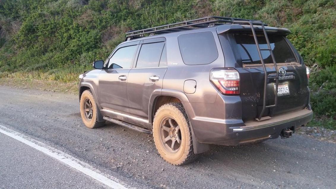

Magnetic4R, whoa thanks, did a search on a different model of the TE37's and found the 18x9 0 offset.. Will be going with those instead.. Where in the bay are you? I'd like to see the wheels on your runner..
Milpitas, here's a couple of recent pix

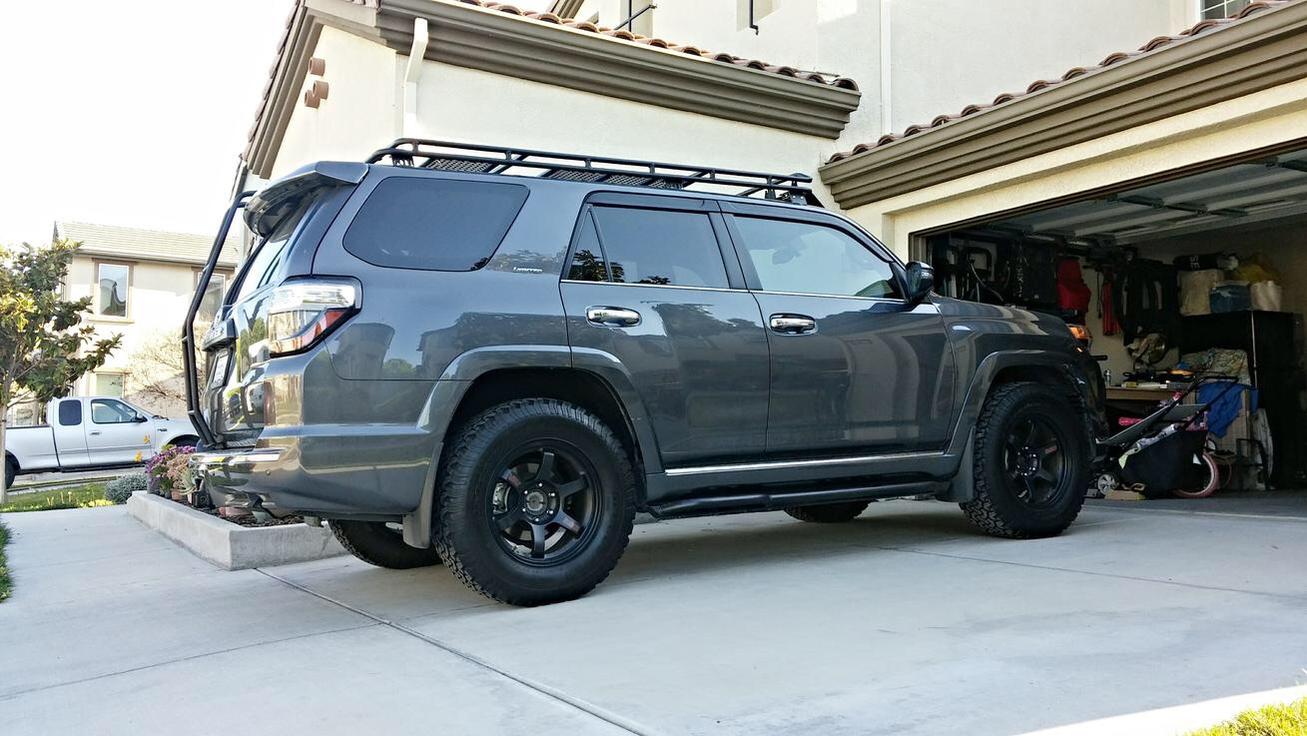

I believe his are 18x8 and the 20s are 5 lugs for his car.
As for mine, they are 18x9 0et, 285/65 BF KO. -12et would have been perfect.
Yes, no lift at the moment, 2" in progress.
My 20s look great on stock height, but 18s will look better with a lift.
magnetic4r which are the 18s and which are the 20s which picture is which? I'm confused a bit now
Both pic on the 4runner are 18's, He has 18x8 and I have 18x9. The 20's I was referring to was the pix of the box he posted which i assumed you were referencing. 4runner are 6 lugs and the 20's he has are 5 lugs.

[MENTION=118423]555R[/MENTION]
My 18's are on the 4Runner. The 20's are on my GTR.
The 18's 18X8. I run a +30 in the front and +20 in the rear. Both with a 1.25" spacer to have the tires kick out past the body.... I am not a fan of a flush look on a truck so I made sure to to go aggressive with the firmest and tire size. I run 285X65x18 all around
285/65/18s fit on an unlifted 4 runner? any cutting or mods clearance issues might be what? i think that looks pretty badass
Push the liner forward and you should be set. The rest depends on your tires brand. I rubbed more with my 20s only because of the -12 offset. I feel like I can run 295 or even 305 with the BF KO with lil rubbing but drive able.
