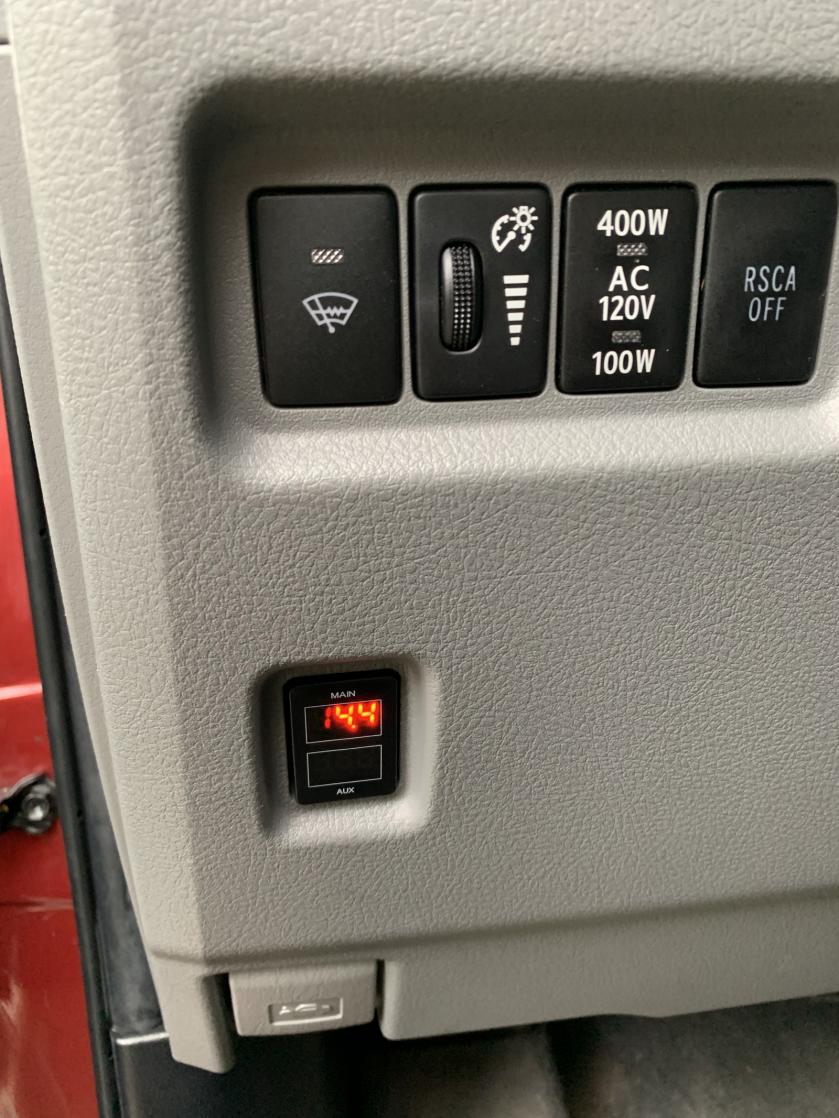

I have one of these installed as well, had to make the hole slightly bigger and I just cut the factory wires for the factory 12 volt port and attached them to the new USB/Meter.
Pic here: https://www.toyota-4runner.org/3280366-post38029.html

Supports main and aux. Made for Toyota knock-outs. Perfect fit. Shipped quick from Australia (I think it took a week) Comes in blue too.
