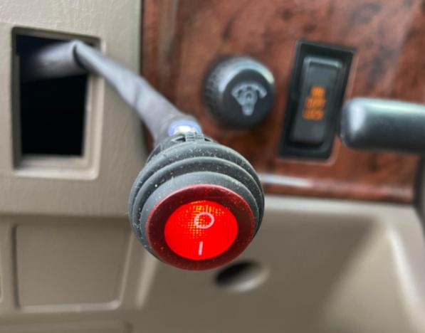

Super boring question, I know. Search results here were mainly 5th gen-related or very old. Has anyone found snap-in switches that don't require trimming or drilling the stock plates or holes. I can make something work but (lazy) wondering if anyone has recently found an easy part to snap in the dash blanks. Looking for 3-lead rectangular rocker or push button for a set of aux fogs.

Have you considered an OEM foglight stalk? it's pretty easy to wire up and not terribly hard to find
I had 2 of these OEM switches I installed at one point to the left of the steering wheel running various aftermarket lights. They are used on early 3rd gens (among other Toyota models) for factory Hella fog lights. It’s a rocker with an amber led. Plug & play as far as the dash knockout goes.
Toyota p/n 00550-35976

Yes I have, but I believe the headlights need to be On (not just DRL) for the stalk switch to work on my 2000. I'll probably use the fogs in conjunction with the headlights 95% of the time, but I'd like the option of fog-only. The fogs came with a really nice wiring harness I'm going to use, too. I got a pair of the basic Baja Designs Squadron Sports and although their site says 4-6 weeks, they shipped next day and are made in USA.

Oh nice. I was thinking of hitting the junkyard for a Scion switch but that looks like the ticket. I was going to order a fuel filter anyway - thanks!

I found the same OEM out in the aftermarket but forget who I bought it from. I used the part number on the old switch that failed. May be a better price.
I bought two OEM scion/camry lights that have the orange bulb. I am now trying to find some larger rocker switches for my next project with some baja designs lights, evidently some of them need on/off/on switches.

I'm going to use the same OEM rocker for a pair of the little Baja Squadrons. The factory harness also has a basic on/off switch (round, though) with 3 spades for the switch light. Do you have a muticolor or multifunction lightbar or something that uses both positions?
Easy, get the Oznium Scion OEM style rocker switch. I use 2 of them on my 4runnerm one with the green LED and one that doesn't have an LED. They fit into the blanks and look stock.
You can see the one without an LED in this photo that I took for an unrelated project.
I don't have any good photos of the one that I have fitted with an LED, but the listing I posted is accurate. I use it for my fog lights, no complaints. By 3 lead you mean it has 3 shovel connectors on the back (one for the LED ground)? The LED version is that.

The 4runners pre-1999 had a rare option for fog lights that was fitted by the dealer. They used a rocker switch in one of those cutouts. It looks a lot like the switches I mentioned, except instead of a green LED they used an orange one.

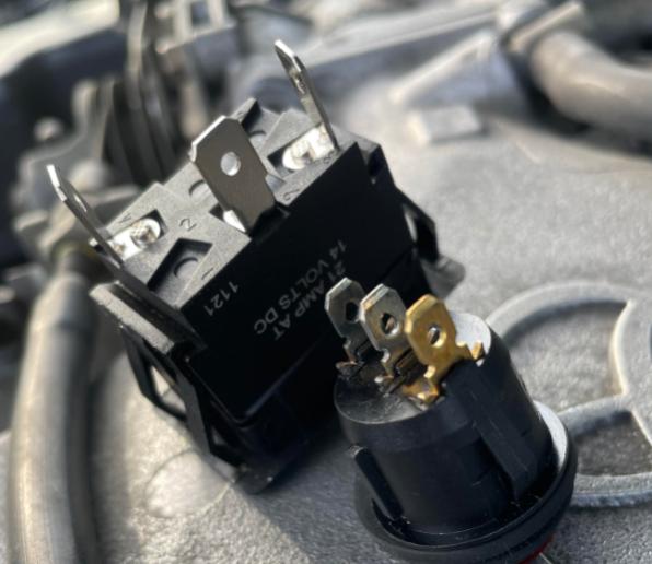

While on the subject, after searching pretty high and pretty low, I'm surprised I can't find an adapter to connect dissimilar spades so I can connect the Baja Designs (small female ends) to the Camry switch spades (larger) without crimping a few connectors and wires together. Not a big deal to do, but it would be a lot easier if there was a small male to large female spade adapter. Is this to discourage connecting different gauge wires, or am I missing some other solution? - Electrical Dummy

Can always file it down. I wouldn't use adapters on some stuff (if they existed) because it's another point of failure, which is unacceptable for kill switches.
All my projects use the larger shovel connectors to keep things standard, so I've never had that issue.
Agreed - my fuel pump killswitch is super heavy duty water-resistant rubberized metal toggle with screw-together connectors. Weird that Baja used these small connectors. I think I have sheet metal snips that will do the bulk of the work and file the rest.
