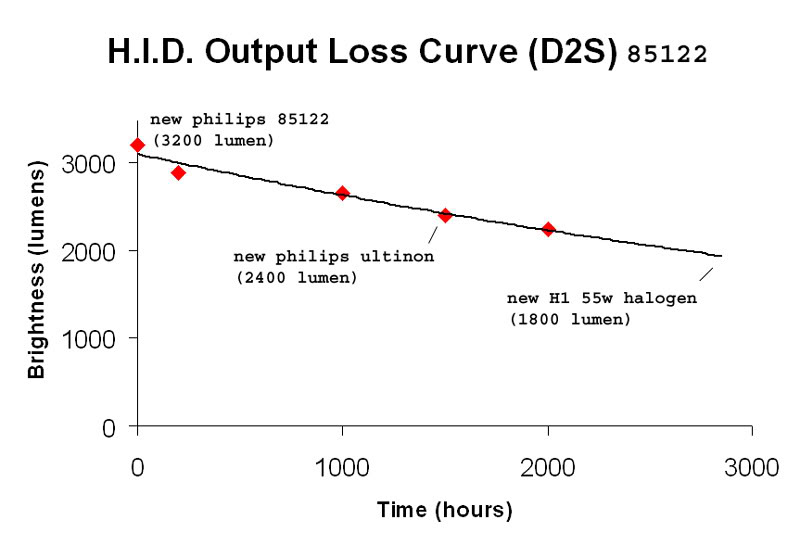

When it says "Life Expectancy: 4-6 Years", what is expected to last for 4-6 years? The HID bulbs or the ballast? Thanks!
The bulb. HID bulbs are generally considered to "last" around 1,000 hrs of use. And they typically do not burn out like an incandescent (halogen), they colorshift, or degrade (lose brightness).
Experts will change them ~1,000 hrs to maintain efficacy.

This popped up on HiDPlanet today, goes to the 'bulb life' question.
