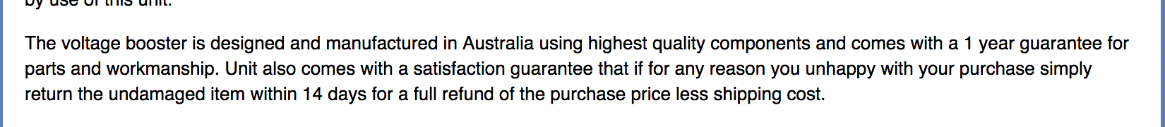

Also you need to address the warranty on your website. There's a difference between 1 year and life time. I assume you would be covering shipping both ways for failures?

Regarding the warranty issue, the installation instructions you received should have stated a three year warranty period applies. If you do some checking on the various forums in Australia you will find we have never refused a warranty claim on one of our devices regardless of the time frame. If the unit has definitely proven as faulty we do not expect overseas customers to return the unit for testing, as long as you can provide us with proof you have destroyed the faulty unit we will ship a replacement free of charge.
