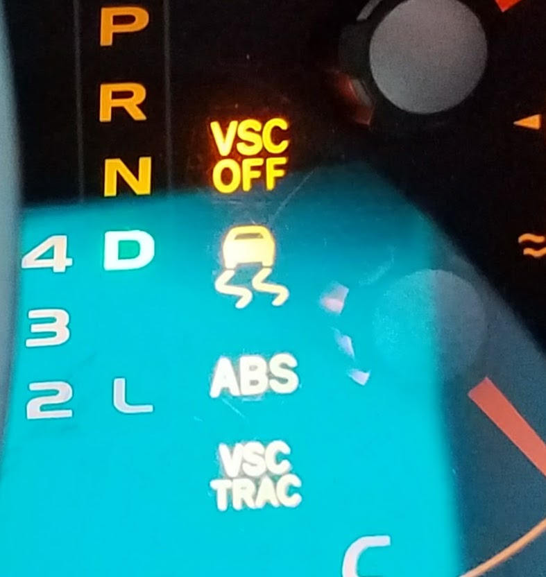

VSC/ABS/TRAC Lights On - No CEL
The traction lights have been turning on while driving. At crank, no lights. Sometimes they will turn on after driving for 30 seconds, sometimes after 30 minutes. Once they turn on, they don't turn off until I turn off the vehicle.
No CEL accompanies them, only the traction lights are on.
Otherwise truck runs fine, no noises, no signs that anything is wrong. I've tried tightening the fuel cap several times, but always get the lights. I've hooked up an OBDII reader to the vehicle and it didn't pull any stored of prior fault codes.
2006, V8 4WD.
Anyone have any ideas?

I had a similar issue for a while minus the trac light being on. I did have a code for the front right sensor being out though. Anyways after investigating I had gunk surrounding the sensor that was interrupting the signal. Hope your diagnosis is just as easy.

probably one of the wheel sensor wires is damaged. try doing zero calibration first. youtube it or search it on this forum
Possibly a dying brake light switch , located near the brake pedal.
https://www.youtube.com/watch?v=3Sja-CXlfBo
It will trigger those lights if the switch is faulty.

Brake lights appear to be OK, but I took it out for another drive and monitored to see when the dash would light up again. Drove in stop and go urban traffic for about 15 minutes, and on the last turn coming into my street the dash lit up as soon as I hit the brake pedal. Huzzah! Brake lights still seem to be working, as well, so perhaps it is tripping the lights as an indicator that the switch is *failing* as opposed to failed?
What seems to differentiate my issue from the gas cap and the g-force sensor crowd is: the gas cap crowd gets a CEL, whereas I do not. The zero point calibration crowd gets the VSC and TRAC lights, but no ABS, whereas I do get an ABS.
Since the chances of different TRAC/VSC and ABS issues occurring simultaneously and only recurring at the exact same time are pretty slim, and the only other crowd I've been able to find on the internet having my same light pattern under the same set of circumstances have been brake light switch people, I am thinking about replacing the brake light switch to see if that remedies the issue. A quick and cheap swap that can't hurt and at this juncture is most likely to help.

Preliminary update - purchased an inexpensive aftermarket brake light switch from Amazon and installed it. Took all of 15 seconds.
https://www.amazon.com/gp/product/B009B3WE0Q
Side note: If you use Youtube videos for your tutorial, they tell you to twist counter-clockwise. This is a little deceiving. It is a counter clockwise rotation from perpendicular to the direction the plug is facing, but from your perspective (drivers seat) the plug rotates "clockwise" (right) a quarter turn. It does not require much force so if it is being stubborn, you're probably rotating the wrong direction.
Anyway, popped the new plug in and took the truck for a drive, same light-tripping route as the other day. Successful drive - no lights! I am going on a 200 mile trip this weekend, so if it does not come on then it likely will not come at all, which would mean the brake light switch was probably the cause of the fault.
As for the old switch - the only difference I could tell between it and the new one was slightly more resistance in the spring of the old switch, and the old switch was a little gunkier on the outside, but upon disassembly the internals and relay surfaces all appeared clean. It's possible the switch might have been sticking or something. At this point not certain why the switch would have been tripping the lights.

If the zero point values need calibration those dash lights will come on the moment the car is started and moves in any direction . OP has an intermittent issue with those lights which means an entirely different problem. Looks to be the brake light switch so far.
Indeed I have experienced the zero point calibration issue with another 4runner, and in that experience it would trip the lights as soon as the vehicle was in motion. Since my issue occurred randomly and only when the brake pedal was depressed, it led me to deduce that the brake light switch was the culprit.
Drove 150 miles over the last two days and no lights for the first time in two weeks. I think we can safely chalk this one up to the brake light switch. For posterity's sake, if anyone is experiencing the issues as described above, the brake light switch is a quick, cheap, and easy place to start troubleshooting.
However-many-thousand mile update. Still no lights. The brake light switch was the culprit. $15, 15 seconds replacing it, problem solved.
