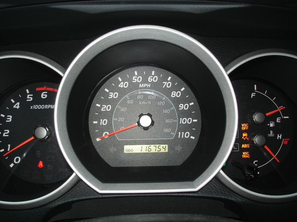

Every 500 miles, the VSC Off, VSC Trac, and ABS lights come on. I've searched these threads and it seems that most people have the check engine light come on too, but I don't have that issue.
As soon as I shut the car off, the lights turn off (everything normal) for about 500 miles, then they turn on again. Its not a huge inconvenience, but I'd like to know whats wrong. The last time it happened, I was driving in snow and there was no ABS or Trac control from what I would see and I couldn't pull over at the time. The gas cap has been replaced and AutoZone is not willing to pull my codes unless the CE light is on.
I have a '06 T4R Sport V6 with 116k. Thanks for any advice.

When I lifted my truck I stretched the right front speed sensor wire. Those lights came on (vsc trac, vsc off, abs, no CE). I hacked the wire up up, found the break, fixed it, and all the lights went off.
About a year later I would intermittently get the warning lights back (no CE). Turning the truck off then on would clear them for a while, but then they stayed on. I bit the bullet and replaced the speed sensor wire with a new part and all is well.
Long story short, check your speed sensors and/or wires. Maybe there is an issue with one of them.
Edit: To diagnose, I tried to perform a Zero Point Calibration as described in a few threads on here. This didn't work, but it resulted in the car blinking a series of lights at me (vsc off, abs). The service manual provides tables showing how to interpret the blinking lights. In my case, it pointed me to a fault with the right front speed sensor. Since the wire had been previously hacked up, I figured that must have been the culprit and it was. I would recommend using the same technique to figure out what is causing the lights to go off.

I would try troubleshooting the system as described in the service manual to at least see what is throwing the code. I mean it really could be anything from speed sensors to skid control module, I'm just throwing out ideas. I discovered the blinking light code by accident when performing a zero point calibration, but then started digging through the service manual and found some good info for troubleshooting.

I got those lights too this last weekend. My code reader stored a brake light switch fault. You really need to get the codes read so you know for sure what it is. It could literally be a hundred things that turn on those lights.
I don't know if it was a fluke but when I had that happening it didn't go away until the stored codes were cleared. Once cleared it never came back.
Search the forum, the fix it out there. It has to do with the brake and I posted a thread and someone gave me the part number. Not to be an a** but doing a simple search for 10-15 minutes and you'd find the answer.
Ok. There are some good suggestions here for possible solutions. But as mentioned above, there are like a hundred faults that can trigger those lights. Could be speed sensor, brake switch, skid control module, etc.
Only way to figure it out is to do one of three things:
1. Start swapping parts out blindly (not recommended)
2. Use a code reader to pull the codes (easy but only if you have access to a scanner)
3. Short a couple of pins on the OBDII connector as described for the zero point calibration and observe the resulting sequence of flashing dash lights. These correspond to codes published in the service manual that identify the fault triggering the dash lights in the first place.
