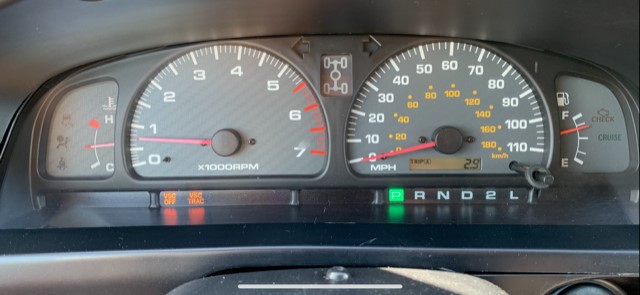

VSC OFF, VSC TRAC lights on, no CEL, no codes
All,
I'm at a loss here. My 2001 4Runner SR5 now has both VSC OFF and VSV TRAC lights on, but no CEL. The truck drives fine with no noticeable issues. I tried doing some searches on this site, unfortunately the search function is garbage. The results I got were mostly with those two lights AND the CEL on, but my CEL isn't on, and I checked for codes and there were none. The truck has 190k miles.
I've also tried disconnecting the battery for 30 minutes, and those lights came on immediately after the car starts moving.
I also read somewhere that the issue could be EVAP system related, but I'm scratching my head wondering why VSC components would be related to emissions and EVAP systems?
Has anyone ever dealt with this issue? I appreciate your information!

You likely have a fault in the ABS system. Pull ABS codes by jumpering in the diagnostic port under the hood. OBD Code readers Don’t read ABS codes.
You haven’t by chance been installing LED dash lights?

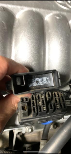

Yes I did. But I did it a month ago, and it just started happening yesterday. How do I jump the diagnostic port like you described? Sorry, I'm a complete noob when it comes to this, and I'm assuming you mean this diagnostic port, next to the intake manifold?
Yep, that’s the one. I don’t remember the details of jumpering and reading the flashes on the dash lights. But you can search, and should find plenty of info here. Also search led dash lights and VSC light on.
