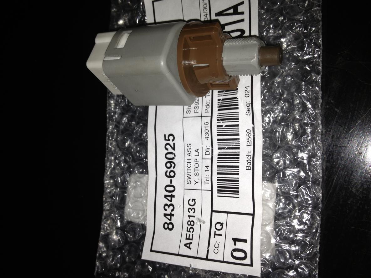

Its a $35 dollar part that installs at the top of the brake lever. twist the old one out, and the new one in in less than 5 minutes...but i can't remember what its called!! Had the same problem with the lights and I couldn't shift out of park sometimes. i think i still have the packaging and the old part. ill try and get the name of that. can't believe i forgot that!!

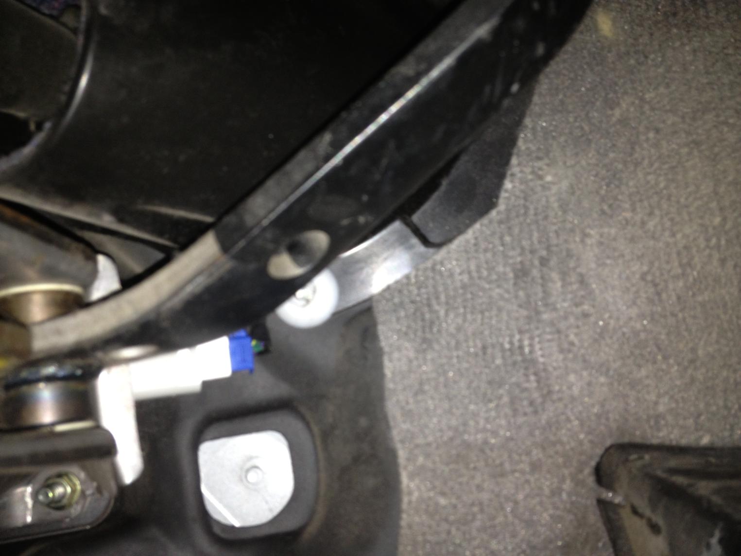

I ran into this just today on mine. '06 V8 Sport. I've got a code reader that will read ABS/SRS codes. Mine came back as a brake light switch fault and one that said ABS Control unit or something or other. My guess is the brake light switch is the actual problem and the other code is secondary. Look under your dash where the brake pedal attaches. Right at the firewall is a white round thing with a blue connector. This is the brake light switch. Seems like a cheap easy fix. Me personally though, I just cleared the light.:guitar3:

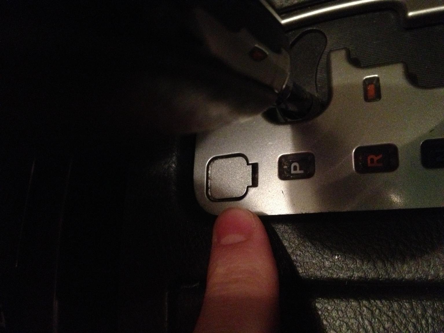

thats the part i couldn't remember! it will eventually need replaced b/c you won't be able to shift from park. there is a trap door at the front portion of the shifter which when removed exposes a button which over rides the lock and allows to shift from park. easy, cheap fix.
Hey man thanks, finally I can get these lights to stop coming on. Do you know where you ordered it? Or do I need to get it from a Toyota Dealer?
I bought mine from the stealership and it was $35 or $45. They had one in stock so i thought WTH. Part number below, as is location. that lever arm belongs to the brake pedal, so the switch is immediately in front of the lever and was brown. the replacement is pictured with the blue sleeve. push up and twist a half turn or so. pops right out!

Same thing happened with my wife's 08. I too tried the zpc and couldn't get it to work so i then swapped the brake light switch out from my 05 and lights haven't come back since. I think who ever put it in the 08 didn't press it in far enough before twisting it in place.

Chiming in to say I had this same issue (VSC on/off, VSC Trac, Traction Control and ABS Lights on). I found this thread and ordered a new Stop Lamp Switch Assembly from Amazon (P/N 84340-69025 )
While waiting for it to arrive, I removed the switch, shook it a few times, reinstalled it, and had no issues since (3 days ago).
I'll still install the new one when it gets here, but if you want to troubleshoot or attempt a field repair, removal and reinstallation may solve your problem.
