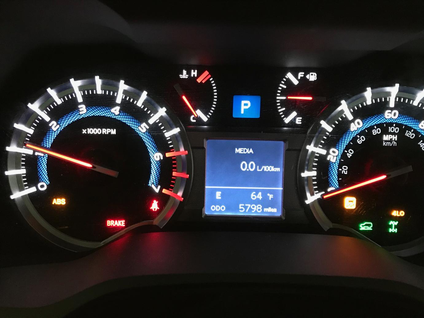

Have the Wheel Speed Sensor checked!
you might want to have the Wheel Speed Sensor checked too, unfortunately, it is this Da**n piece that can run you about 300USD (this for my 2019 TRD Pro). It seems I had the worst luck and hit something on my way home and it turned out to have damaged the stupid sensor (I do remember hearing a loud bang before the lights got lit on my dashboard) . The lights I had on were ABS, Break, 4LO, Select Terrain, Anti-slip and 4WD-engagement.
