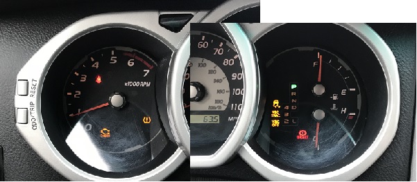

I was driving in the rain this morning 60mph. CEL came on plus TC & the other two below it VSC trac & Vsc off , the car continued to drive AOK. Fault code stored for this was P0137 which looks like a 02 sensor.
plus the TPS light since yesterday, thats a separate issue
Just for reference I also have the transmission Judder.
anyone want to throw any more crap my way? :juggle:, I will post up any result with the fairy lights.

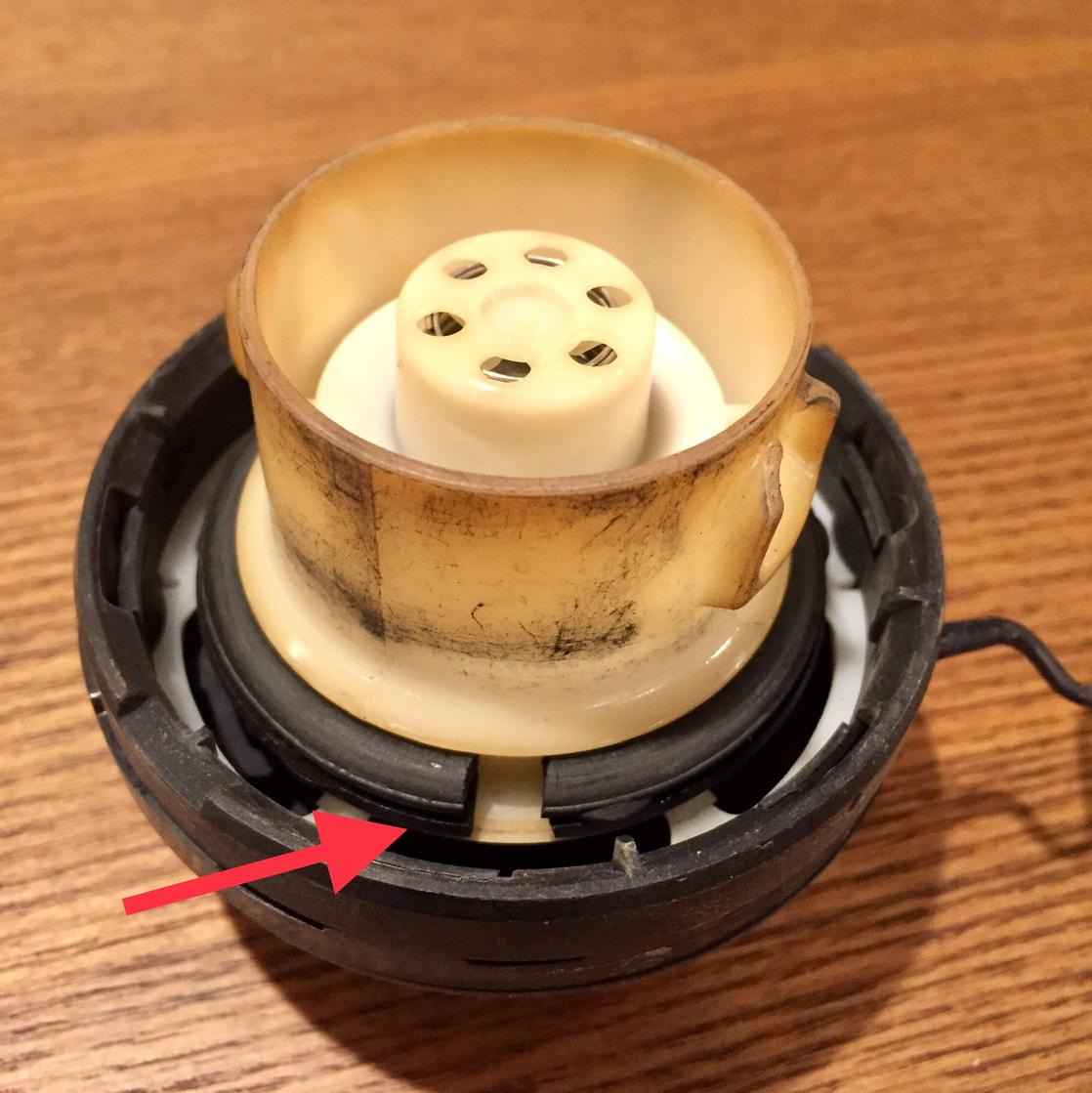

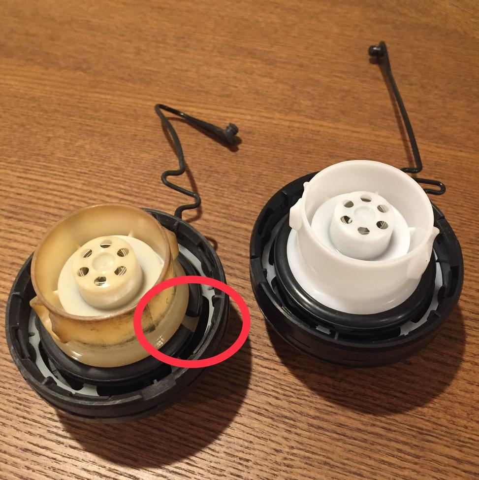

Gas cap caused mine.
Rubber O ring cracked. Replaced it with a new one and lights gone.
