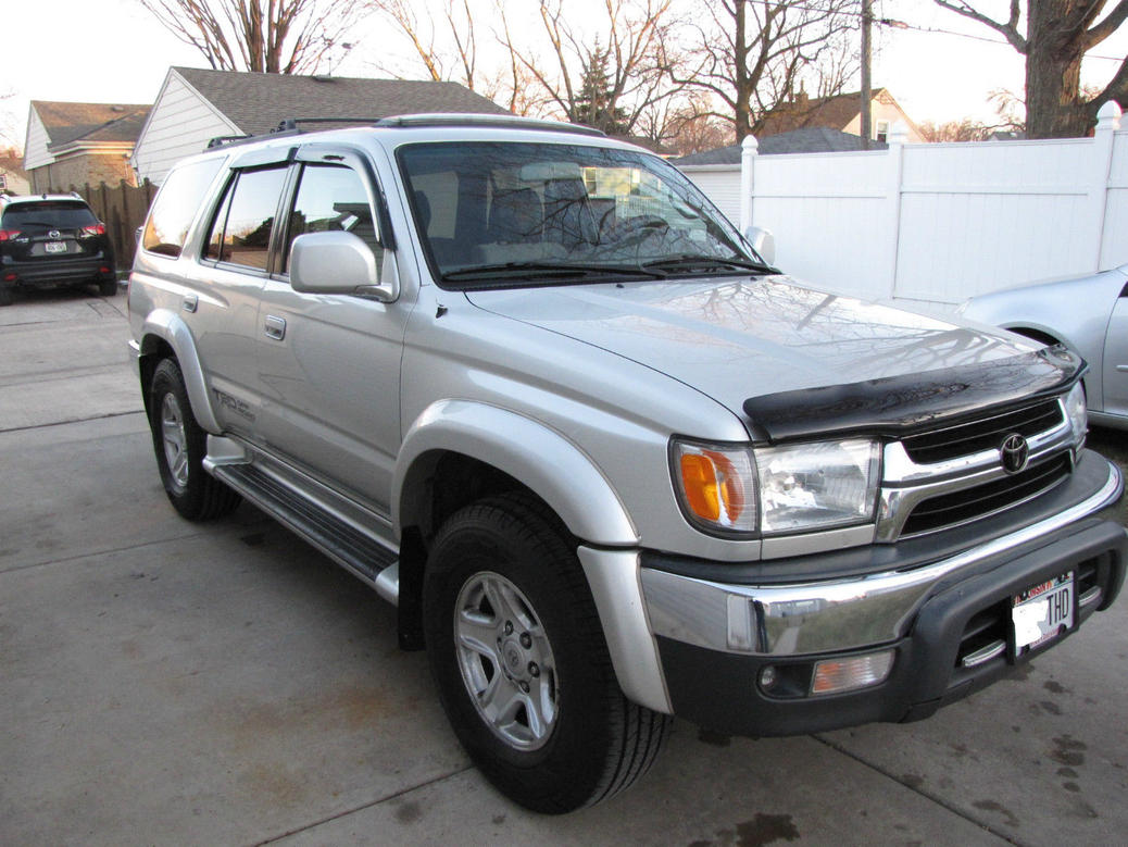

I have a 2002 Toyota 4 Runner SR-5 with over 300,000 miles on it...Check Engine light came on the other day along with VSC and TRAC lights coming on. These have come on before and by disconnecting the battery cable (Neg) for about 30 seconds it reset and lights go off...This time they won`t go off and now I there is a noticeable miss in the engine..I took it to O`Reilly`s to have the codes checked and it shows P0300, P0301 and P0302, as cylinders 1 and 2 showing a Mis-fire...Guy at the auto parts store says it could be bad plugs, injector or Coil Pack...Checked the gas cap, it`s on tight, but not sure what to make of it...Up until now this 4 Runner has run perfectly...Any suggestions? $_57 (1).jpg
