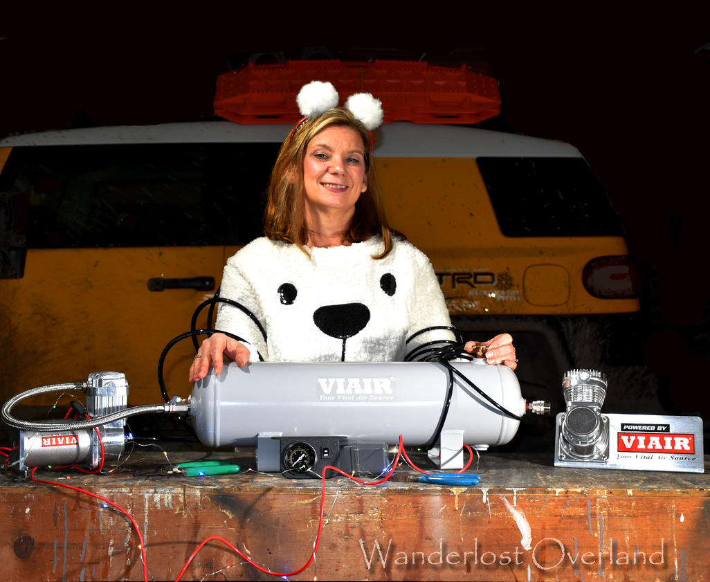

Reserved for our on-board air system from Viair.
Viair sent us their complete Medium Duty Onboard Air system! Now we simply wait tile the rear bumper is built and installed so we can move the spare out of the spot where the air tank goes. Patience, patience.....
