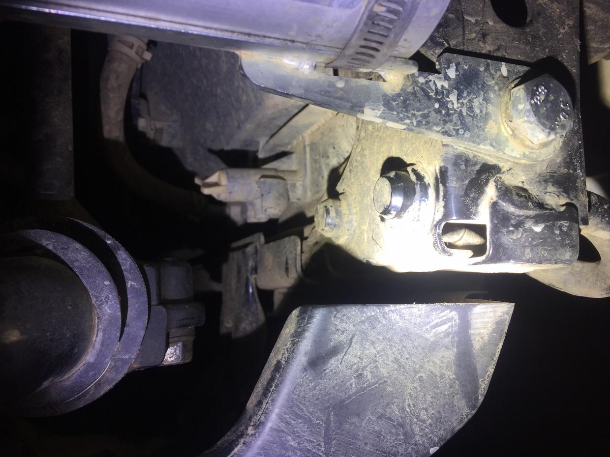

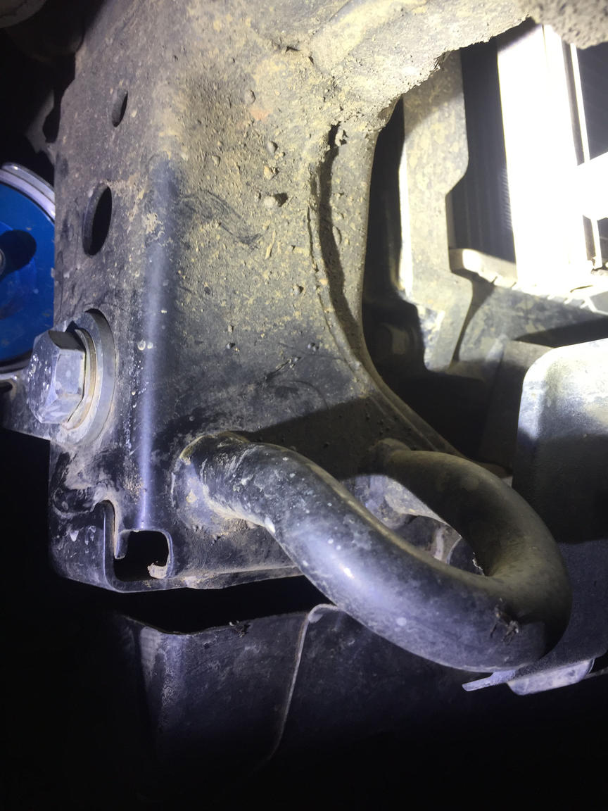

I'll stick with the little loops welded to the frame!
If it gets really serious, I'll add a bridle and pull from both at the same time.
I agree-- those welded loops are serious. I've bridled just to keep things centered.
I'd love to see destructive testing on the factory welded loops versus anything that uses fasteners.
The (4) welds per loop are well considered. The bracket is attached directly to the frame.
I'm not sure why people are concerned about the front recovery loops failing. I've read stories on this forum about the front loops shearing off at the bolts--- but obviously that's not true because the fronts are fully welded.

they are actually called emergency towing eyelets per toyota, but a simple visual inspection will show that they are adequate for most recoveries
