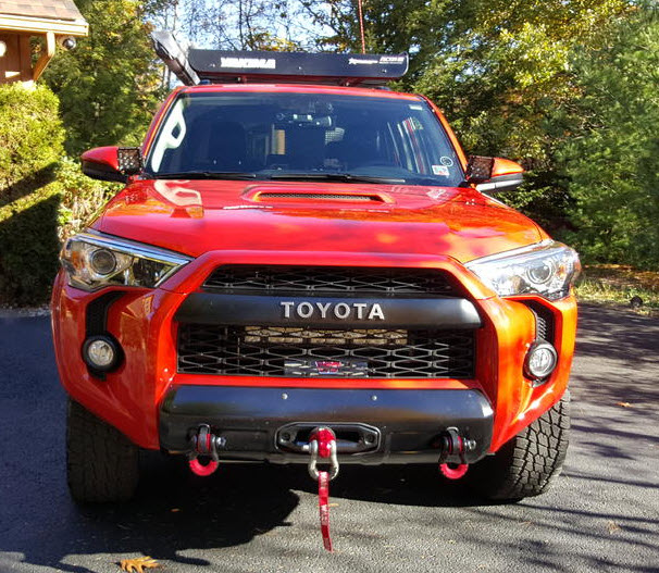

none of the HWMS photos show protruding recovery points. i know i have seen them on other hidden winch mounts, but i don't see any on this one
Not in that thread, but there are some. Google search revealed this, posted on the forum.
