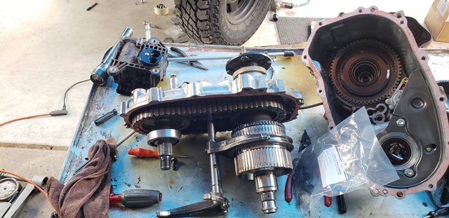

If your actuator is the culprit, can you just replace it with OEM? I know aftermarket probably exists, not sure about OEM. You'll have to open up the Tcase, which is a PITA no matter how you slice it. This job is a good one for the DIY person, especially when you have few other local enthusiasts to pitch in and learn all together.

Not sure if I am the unlucky one, or you are the lucky one. But I had to replace the chain in the TB 3 times and the actuator motor 2 times. The last motor was not OEM and worked less than six months. An electric relay fried and the actuator got stuck in DIFF LOCK, just when I had a drive of 1000 miles ahead.
Right now the actuators are disabled and I dont really miss it. The permanent 4WD combined with the low gears is quiet good also on snow and off road. But I want the TB fixed and maybe I go with the OEM actuator this time, since my project to replace them with manual levers seems complicated.
