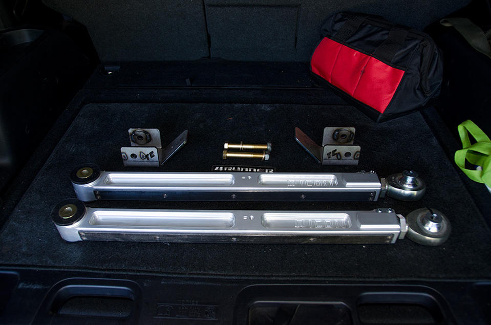

Holy Cr*p!
Look at these beefy mo' fo's!

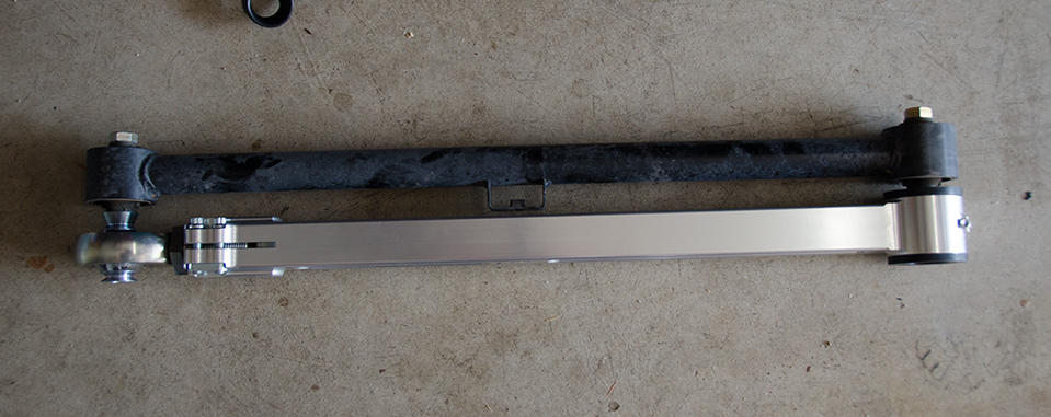

The pictures on the website did not do these things justice!
After witnessing someone on the trail bash the heck out of their lower tailing arm mount and other pictures of pretzel stock arms after a little rock hit, I decided to upgrade the trailing arms from Icon and get some mount skids from Total Chaos.
Initially was going for some cheaper but decent arms but the company's website/phone support led me into ordering the wrong thing and I had to cancel, claimed it doesn't fit the 2014. Decided to go to Icon who, while expensive as heck, I've so far come to trust with parts and ordering. Came just 3 days later and they are a thing of unparalleled beauty :D
Hope to get them on this weekend.

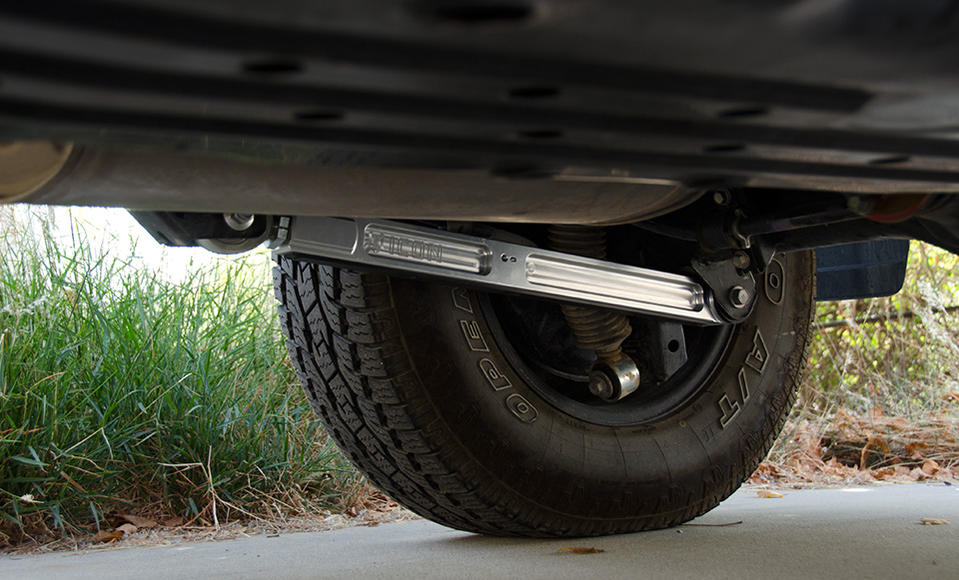

This morning I installed my Icon rear lower links / trailing arms.
Oooooo shiney!
The arms came with install instructions where were ok. But missing some detailed info that would have been ice for generally novice wrenchers.
Here are some missing details:
Getting the old arms off. If your old arms are trashed they come off pretty easy, but mine were new and required some finesse.
Jacked the car up by the diff, then set it back down on jack stands on the frame just in front of the front link mounts. Then lowered the diff jack till the wheels were hanging on their own. They should be only barely touching the ground or floating.
Remove the parking brake cable guide from the link.
Next is to loosen the front bolt. Don't loosen the nut, it is self locking and will be harder to break loose. After breaking the bolt loose then take the nut off. Now try to turn the bolt with your fingers. If you can then you can pull it out and take the rear bolt off. If the bolt is still tight, slowly jack the diff back up, like one pump at a time till the front bolt is loose enough to pull out.

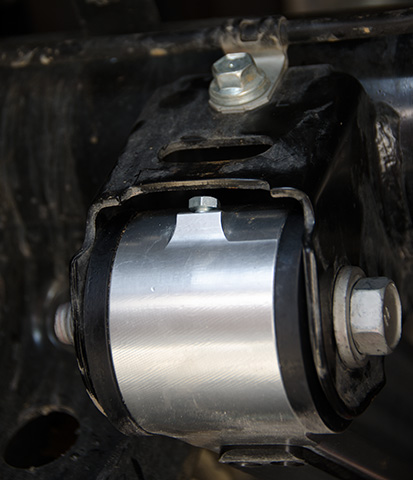

Once the old trailing arm is off, you need to adjust the new trailing arm to be the exact same length (assuming you are not changing your pinon angle). The instructions tell you to do this but don't say exactly how. I figured out that by placing the bolts through the old link you could use that to set the length of the new link easily like so:

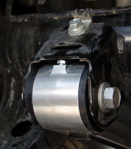

So once they are the same length you just simply bolt in the new trailing arm. But there was one small problem on my setup. There is a tiny bolt on the rear link of the arm. (For oiling?) Unfortunately it does not completely clear the link mount. Fully stuffing the wheel could shear the nut right off. I used a square jawed pipe wrench and gently bent the lip of the mount out of the way just enough for it to clear. Before on left, after on right.
one more little detail was that trying to bolt the parking break cable back on didn't go as smooth as it should have. I had to bend the anti-rotation tab in towards the bolt hole in order to get both of them to line up to get the bolt into the new arm.
Finally, torque all bolts to specification. The trailing arm adjustment bolts are explained in the instructions from icon, and for my 2014, the main mounting bots were to 96lbs. And again, torque on the bold heads, not the nuts.
All in all a relatively easy upgrade, though it was more exercise than I've had in months and still wore me out :D

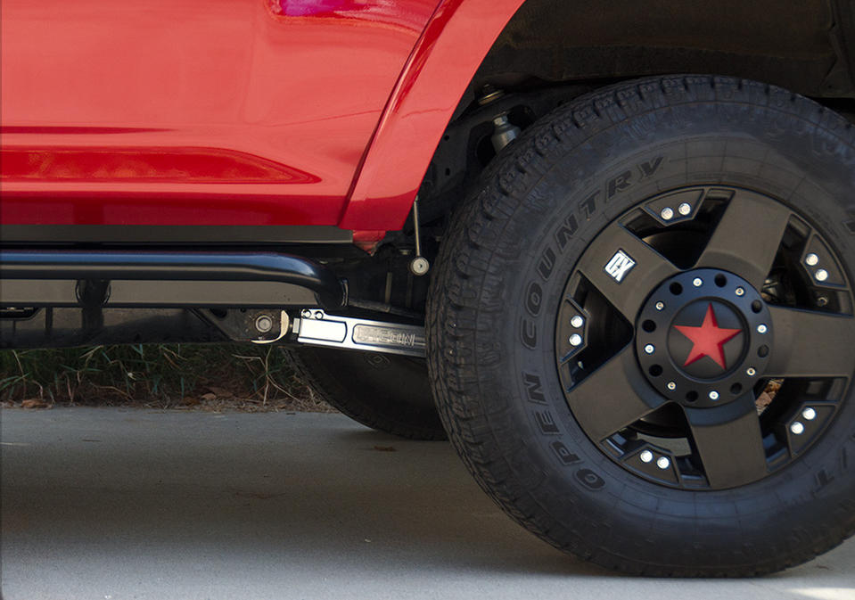

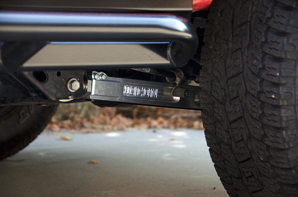

Some installed pictures. I tried to find some good pictures of them installed before I bought them and was generally disappointed in the quantity and quality of such pics. So including the top image, here are some nice ones for everyone from now on.

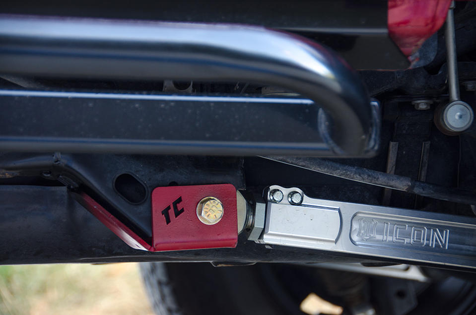

Oh, one last thing. I bought a set of Total Chaos rear link mount skids. They would have fit fine with the old links but they don't fit at all with the new one. The picture above shows why, the ball joint knuckle is HUGE and extends well below the frame of the mount which the skids covered up. So I can either plasma cut the bottom of the skid so that the knuckle passes through it, or I'll just need to make my own.
Since I think I DO want to protect the knuckle itself, I'll probably just weld up my own skids...

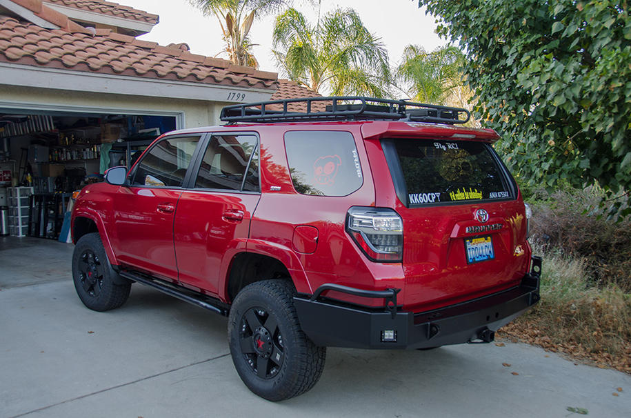

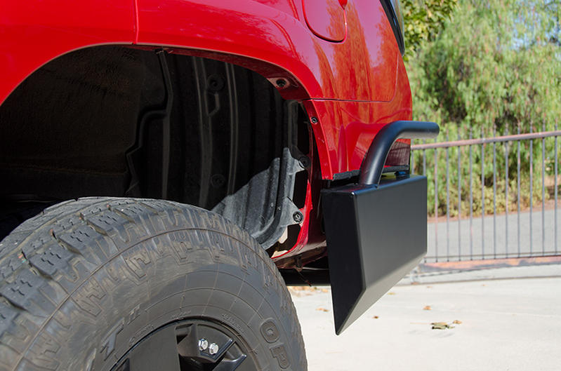

New bumper!!!!

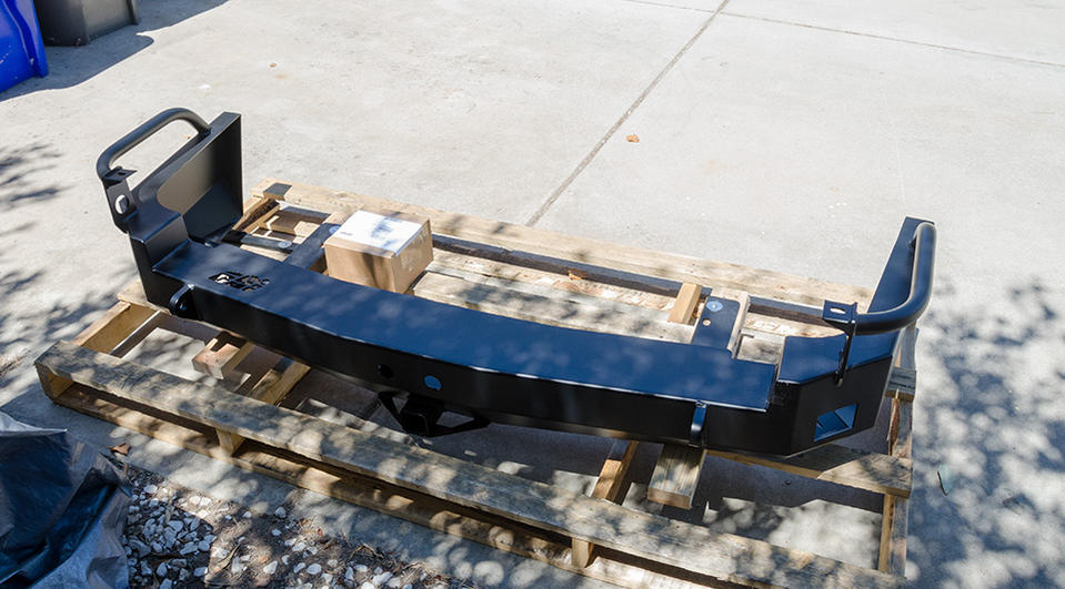

Well look what arrived! Got some work to do now.

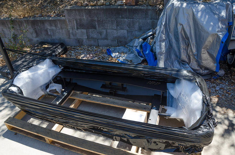

Packaging
Unwrapped. It's HUGE! I weight is here and the bumper alone was 140 pounds powder coated. Plus another 5 for the bolts and brackets. As you can see I did not get the swing arm.

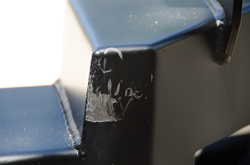

And like so many others, damaged in shipment :( The corners need some cardboard on them for added protection, or maybe even fully boxed. It's a shame to have such nice work marred during shipment.
I'm not sending I back though, I'll just grind down the powder coat and paint it...
One last shot of the back as it is now... There's no going back from here!

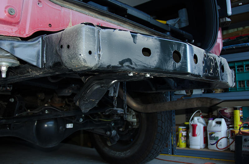

Lots of plastic to remove. Protect the bumper cover well! That paint can be scratched by even looking at it!

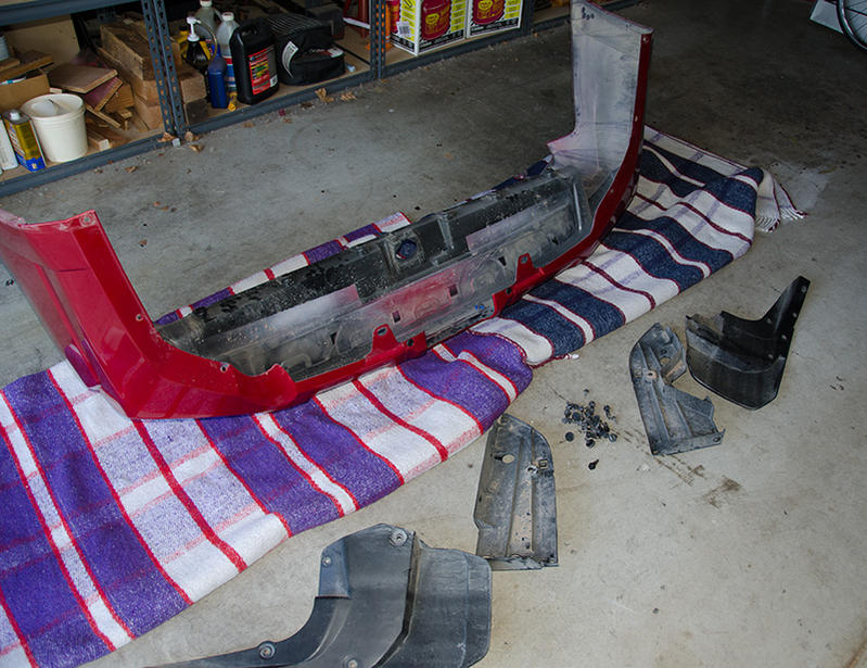

Tow hook, Styrofoam, bumper cover mount brackets all removed. Instructions said to cut off two other bumper cover mount brackets sticking down from fender but I just bent them up out of the way a little (Might not have even been necessary). JUST in case I DO want to "go back" way in the future.
Leave on the trailer lighting socket. I initially took it off too but there was no reason for that.

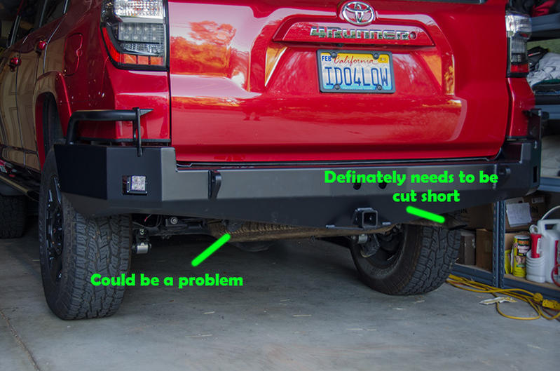

Also have the exhaust hanger unhooked which is necessary. Now there seems to be differing opinions on this but in my case, with a 2014, in the end it turns out that it is necessary to cut off the end of the pipe about 2 inches in back (towards the back of the car) from the hanger. When I got done no amount of bending the hanger would get the exhaust far enough from the bumper to prevent banging.
I plan on re routing it out to the side, but I wish I had cut it off at this stage because now that the bumper is installed, cutting it at that point is going to be much harder. (I have another picture down below that shows the problem.

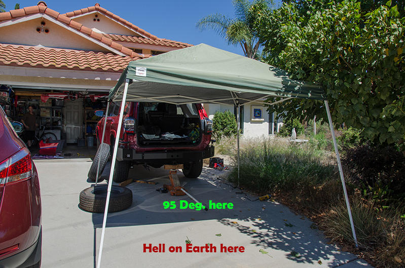

Next day, pulled out in driveway for better access. First test fit. I initially had a friend hold the right side up while I put the bolts in using the tires on the left for support.
Temp quickly rose to a sweltering 95 by 10 am and lasted till the job was done. Ghod forbid you left a tool in the sun! :D
At this point I mounted with a couple of bolts so I could measure the distance from top of bumper cover to the bumper. There were some numbers floating around but they are different for different years and so I decided to measure myself.
My final cut numbers were:
At 5 1/4 inches from the tip of the fender flare, 5 1/2 inches down.
At 16 inches from the tip of the fender flare, 5 3/4 inches down.
From bottom of corner of rear light closest to liftgate, 9 1/2 inches down.
Now I don't want to be responsible for any bad cuts, so if not sure, measure yourself. This was on a 2014 SR5, even the trail or Ltd may be different. Also, This gives my a 3/4 inch gap without the rubber trim, about 5/8 with. This may or may not be enough depending on how hard you wheel your rig!

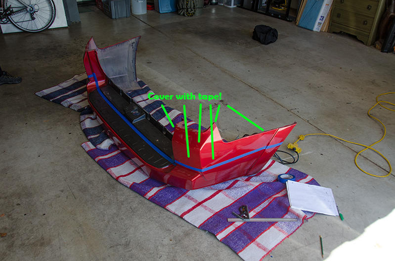

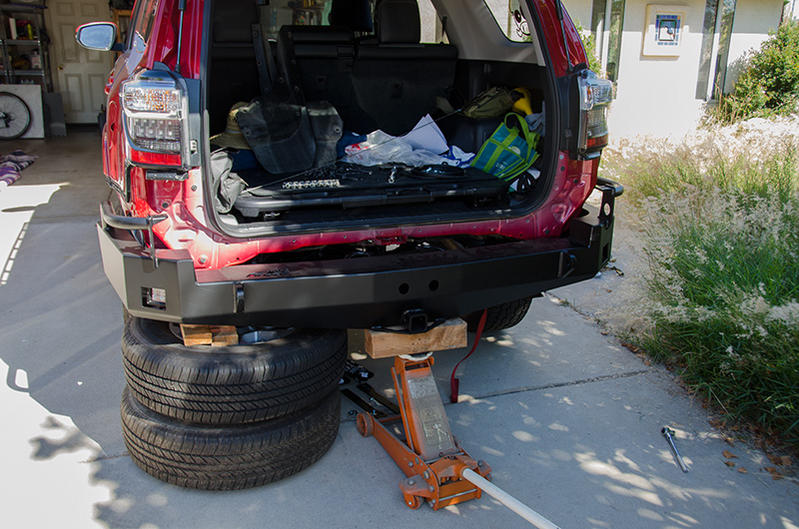

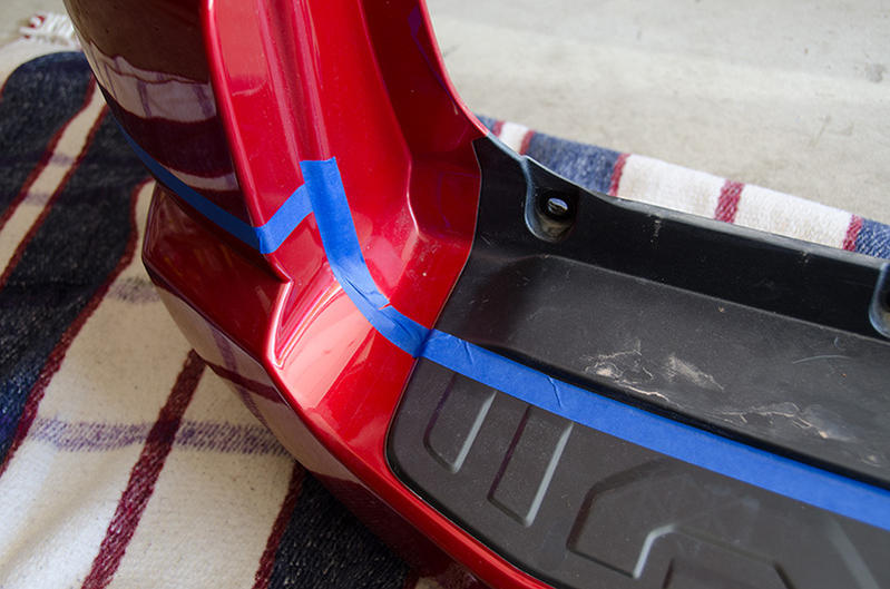

Taping. After measuring and taping the cut line, learn from my mistake and tape up completely over the area you are keeping, at least the areas that stick out like under the lights and the edges to prevent unnecessary paint scratches.
This corner gave me fits for a bit till I saw a picture of [MENTION=62034]Keemonrunnin[/MENTION] 's install where he thankfully had a picture with the lift gate open.
One other thing I did here that may not have been a good idea, I decided to leave an inch extra plastic in the black area because I'd seen other cuts right up against the little lip there on the upper side of the tape and it didn't look so hot. Well it turns out that you really do need to cut close to the lip because everything south of that will stick out under the tailgate when it's closed and it is not very clean looking. I'm not taking my bumper off to fix it now though!!!

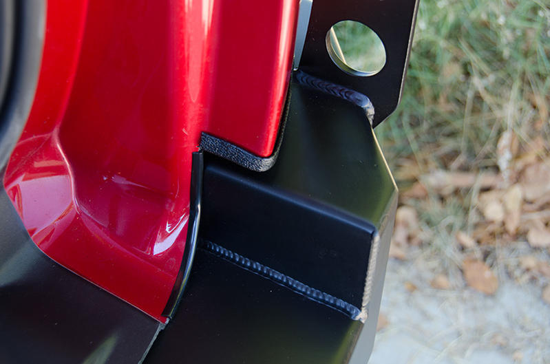

Ok, test fit with the bumper trim and bumper on. It turned out almost perfect, but the trimming was a little low on the pass side so had to take off and retrim a bit.

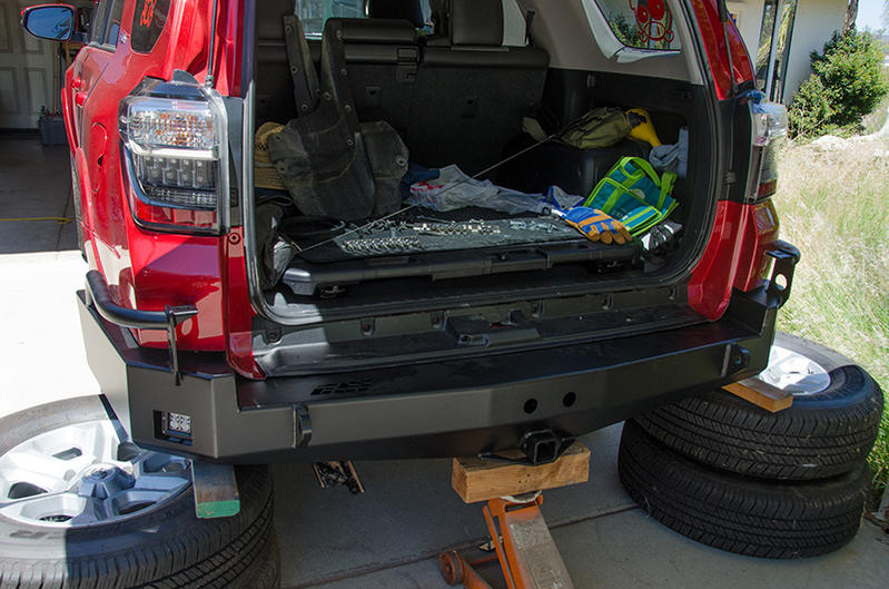

Also in this picture, you can see I finally got smart about propping up the bumper. Using the tires and a 2x4, I could slide the bumper in, bolt up for testing, then unbolt and slide out to install or remove the bumper trim as needed without anyone's help. If you do this from the start, you only need someone to help lift the bumper up there once and then it's a one man job.

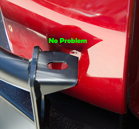

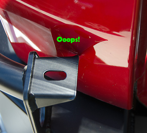

I did have one small fitment issue, which I didn't notice till I'd already smacked into the bumper cover on both sides ugh :( It was my fault though, I asked CBI to weld a couple of antenna tabs on for me so it wasn't like an engineered thing on their part.
All better! Quick work with an angle grinder with cutoff wheel and things are fine.
My gap. (Need to work the trim up a little neater) It's a fairly even 5/8 of an inch. Looks really good, we'll see if it's enough :D
Some door edge trip to finish off the painted edges
This is what is left under your wheel well. I'm going to fab up some mud flaps myself in the near future to cover up all that void space and keep from flinging dirt/mud all into places hard to wash out.

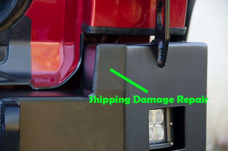

Fixed? Here is where the shipping damage was. It's REALLY hard to find paint to match black powder coat. Flat black is too flat and semi gloss is too glossy. The flat looked the best though. It's visible if you look for it, but not too noticeable over all.

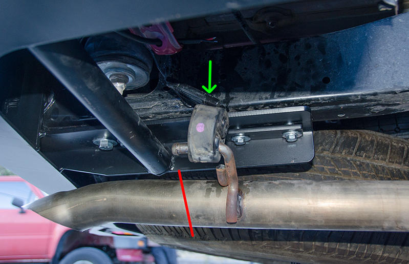

Here is my final exhaust situation. In this photo I have removed the hanger spacer from the upper mount completely and am just letting it ride on the bottom. This is of course not acceptable long term. The red line is where I'm going to cut it and should have cut it during initial prep work.
Eventually I will get it routed out the side though.

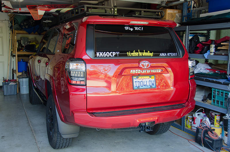

Side view
Rear view

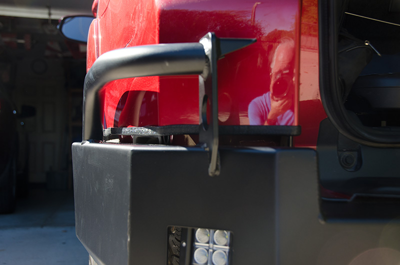

Clearance view. Initially I thought there was better clearance in the corners but comparing it to the original bumper picture it looks about the same. The trailor wiring socket should probably be relocated, as well as the exhaust, and you can see the spare tucks up nicely (265/r70/17) But will still drag over ledges. I like the idea of getting a 255 under there!

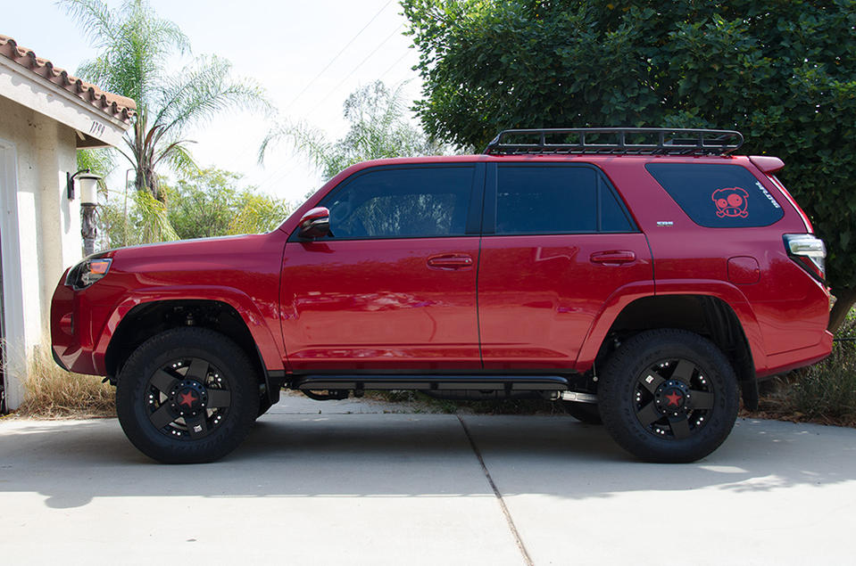

So a little bit more work to go, but with the extra 2 inch lift since my last outing I'm already a lot better off over stock.
Final numbers:
Total install time: 7 hours with a lunch break, numerous water breaks and a cloth change break after sweating everything soaking wet half way through.
Bumper weight: 145 pounds - 10 pounds of stuff taken off = 135 pounds extra weight.
Rear spring compression: 0 inches? I have the icon 2 in lift springs (2.5 inches in reality). Before install I had someone sit on the bumper to see what the deflection would be and it was about 1/2 inch at 180 pounds. After the install though, remeasured and the driver side did not change at all, Pass is down 1/4 in so closer to level. ?!?!? Don't ask me but happy :D
Overall clearance: About the same, maybe slightly better.
Sway: The same.
Nose Dive: Slightly less.
Lessons learned:
1) Cut off the tip before doing anything with the bumper. There was no way to keep my exhaust from banging on the bumper support no matter what I did after install. Now that it is fully installed (and not wanting to remove it) It's going to be a LOT harder to cut off now.
2) The trailer light socket does not have to be removed. No one said it did but since EVERYTHING else was coming off I took it off and it hung and got in my way. Just leave it on.
3) I used a ratchet tie-down anchored on the spare tire chain crane to pull the exhaust out of the way for the install.
4) Tape a lot of the area you are going to keep on the bumper cover. Especially the humps under the lights and around any edges.
5) If you set up something to support the bumper on both sides to within an inch of the proper height (I used two stacked tires on each side), you can get someone to help you lift the bumper up onto the supports once, then you can by yourself complete the entire rest of the job by yourself.
