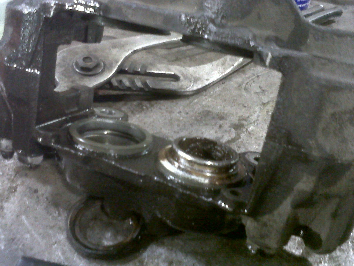

This is something that really pisses me off. A couple of weeks ago i had my breaks inspected at the dealership and they told me that all i needed were brake pads for my two front wheels, everything else was fine. So, yesterday i decided to go to a Just Brakes shop to get new brake pads since they advertise them for $99.88. I dropped the car off at 2pm since they told me it would take till 6pm to do the job. About an hour after i left the car at the shop the guy calls and tells me that one of the front calipers has a stuck piston and i might need to buy a whole new caliper. Now that $99.88 has turned into about $425.00 worth of work. I raced back to the shop and let them show me what they were talking about. They showed me the caliper and said that it was badly rusted and stuck. I took a picture with my phone and have it posted below. You can see the stuck piston they were talking about. Needless to say, i had no choice but to agree to them putting a whole new non-OEM caliper on my front passenger wheel.
Today i went to my Local Toyota Dealership and showed them the picture and they said that they haven't heard of seized calipers on 4th gens before, but most likely the Just Brakes ruined my caliper on purpose so that i had no choice but to buy a new one from them. I'm at the Toyota dealership waiting on an oil change and for them to re-inspect my brakes because now they squeak very badly :ybrick: :ybrick: :ybrick: . I also researched Just Brakes and found very bad Rip-off Report: Ripoff Report | Just Brakes | Complaint Review: 298 and google reviews: Just Brakes and even an NBC undercover special exposing their brake scams here: NBC Dateline - Just Brakes - YouTube I usually check reviews for products or services, but this is one of those rare times i didn't and now i'm wondering if i got burned. I didnt expect this to have cost so much. I'll update more when i get my car back from the dealership today.
EDIT UPDATE: Ok i finished at the dealership and they said that the Just Brakes used titanium brake pads that tend to squeak more. I dont know what they did but when i rolled out of there the squeaking was gone. I also want to make it clear that i'm not bashing either the Just Brakes shop or the Toyota mechanic. I'm simply trying to get the forums opinion on whether or not:

Yes i read about the seized calipers here and even posted in that thread. I was kinda surprised that mine was in the condition it was in in the picture. The other three that aren't pictured were perfectly fine. Also (this seems to be a big argument in the seized caliper thread) it is widely believed that seized calipers occur in people in the north with more snow/rust issues, which also made me surprised. I'm at 160,000 miles and have been taking my runner to the same dealership for maintenance and never had any issues.

Dude, there's been numerous posts about stuck brake calipers floating around the 4th Gen forum for a while. This is a know issue, you really shouldn't be surprised.
I don't think Just Brakes was trying to rip you off, you told them to change your front pads and they discovered a seized piston. End of story. If they had neglected to say something about the seized piston, they would be liable for any resulting damage. FWIW, all garages (dealers and independents alike) typically charge way too much for brakes considering how easy a brake job really is.
I wouldn't be concerned about them using a non-OEM front caliper either, it's quality is probably just as sub-par as the OEM units that are prone to piston seizing. Your squeak/squeal is likely caused by one of two things: the pads need to be bedded properly, or they didn't use anti-squeal shims and grease when installing the new pads.

First off, siezing caliper pistons are a known issue by many owners and 4Runner members. As for dealerships? Honestly, it could be anything from them just lying out their teeth, to not having many customers with that problem roll through their particular dealership...

That being said, I don't think the independent shop screwed you over. What the dealership said about them purposely screwing up your caliper to make a sale, may have some truth to it. We had a huge scandal a year or two in our area where certian quick lube chains (*COUGHJIFFYLUBECOUGH*) were putting used car oil back into the cars they were working on. In my experience though, the only real issues you come accross with this quick brake shops is that their parts may not have all the required hardware for your brake job and or they lose the hardware, then again even the dealership technicians can be lazy and forget to put the hardware back on.

the guy that told you it wasnt a common issue doesnt have a clue....or like someone said could be in an area where corrosion isnt an issue. it is very common (ive done 1 on my personal truck at 57k miles...will do the other side very soon).
the 99.95 pad slap brake job is a cheap alternative to doin the job the "right" way. i run into it atleast once a day everyday. cheap parts= noise and issues. not resurfacing rotors will lead to noise and vibration. peoples opinions will differ in the matter but it happens more often than not.
price wise, no it wasnt a rip off...its pretty much in line with what a brake job with a caliper replacement goes for now a days. the dealer would have been probably $100.00 more with the differance in parts pricing.
