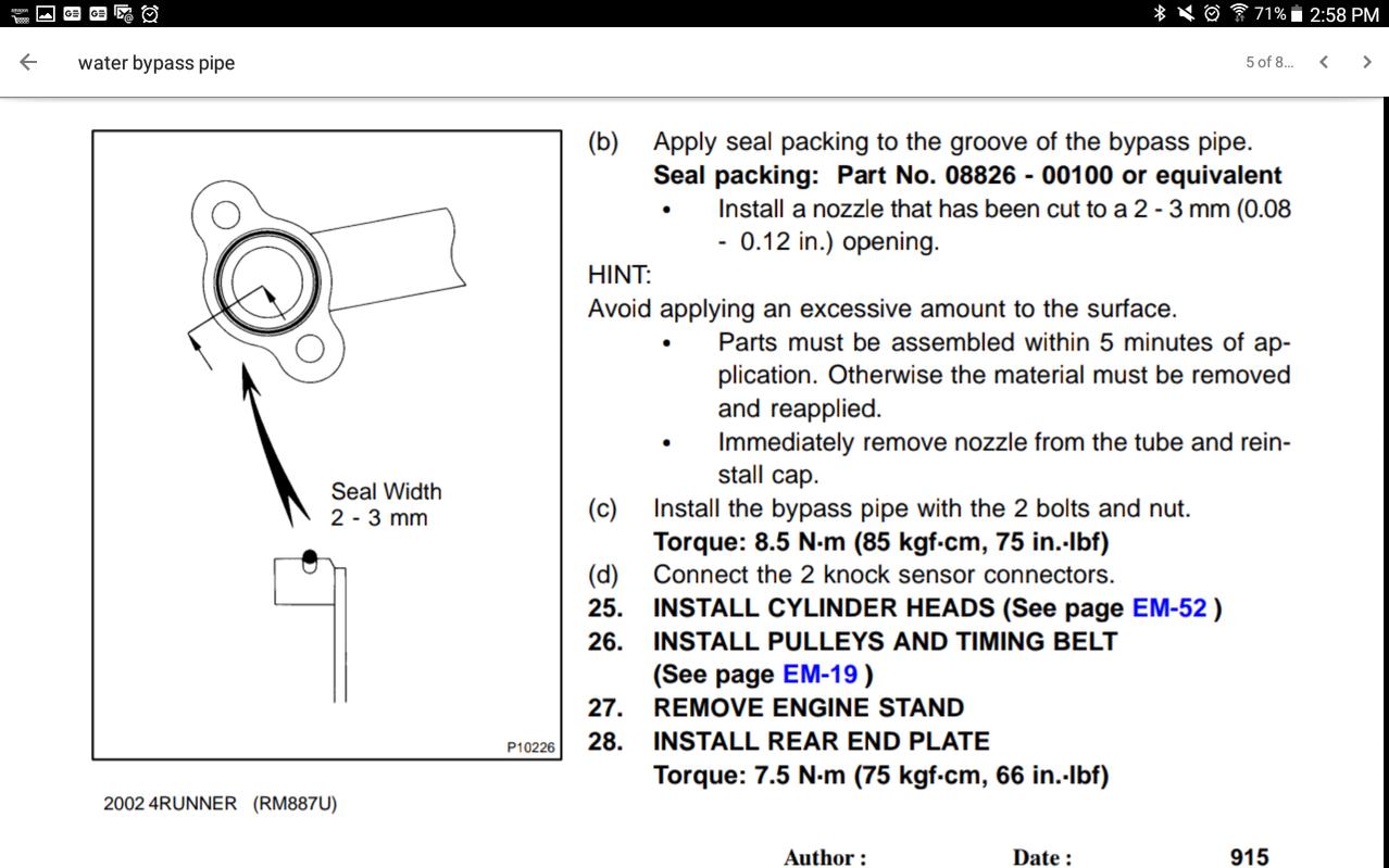

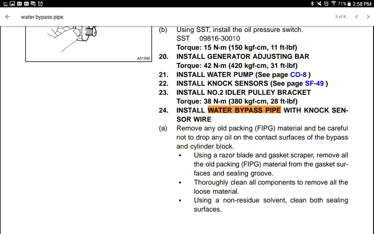

No o-ring, I followed the factory service manual instructions and used Permatex Ultra Grey to reseal mine. This is what it looked like before:
