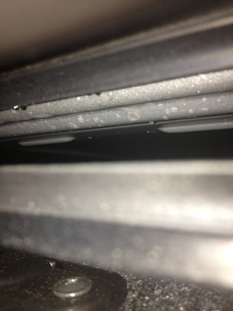

I have a 2013 Trail purchased in March with 6k on the odometer. Just ran it through a touch less car wash(one of the high pressure ones) and had some water come through the sunroof. I got hit in the arm and face a few times with droplets and noticed water on the + and - signs on my transmission.
My girlfriend wiped it up before I could take a picture but it looks like water has gotten in before. Is this anything I should be overly concerned with and does anyone else have water spots where the sunroof rests when opened all the way?

I have the same problem. Make sure to get it wet for the dealer to show them. Don't let them just run a hose over it because it wont show up until after you leave. And make sure to get it fixed soon, otherwise is runs down the A-pillar and gets the seatbelt wet, which then begins to smell HORRIBLE!

There was a thread about this earlier. You may want to search for that one and see what knowledge it adds for you. There was also some talk in there about cleaning and lubricating the tracks.
Did you check to see if the tracks and seals are clean and not dried out?

Your owners manual has instructions for how to initialize the sunroof (mine is on page 100- but yours may be a different page). This will reset the sunroof to ensure it's opening and closing within the factory specified range. Basically you hold the buttons down for a few seconds I think...
Do that and check to make sure the drain holes aren't clogged. If that doesn't fix it your warranty will. Good luck.

Thanks to everyone else for the advice, I've got a call in to the service department director and I'll try to reset the sunroof per antman's post.
