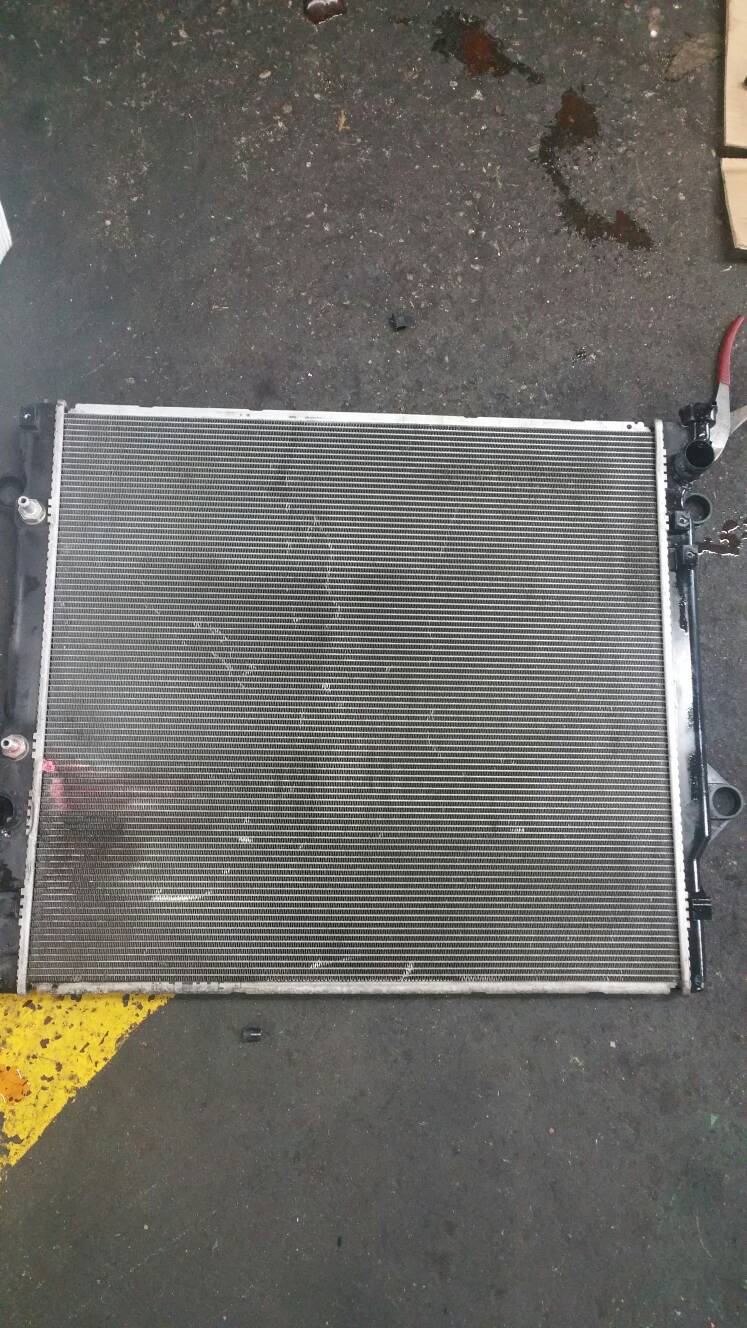

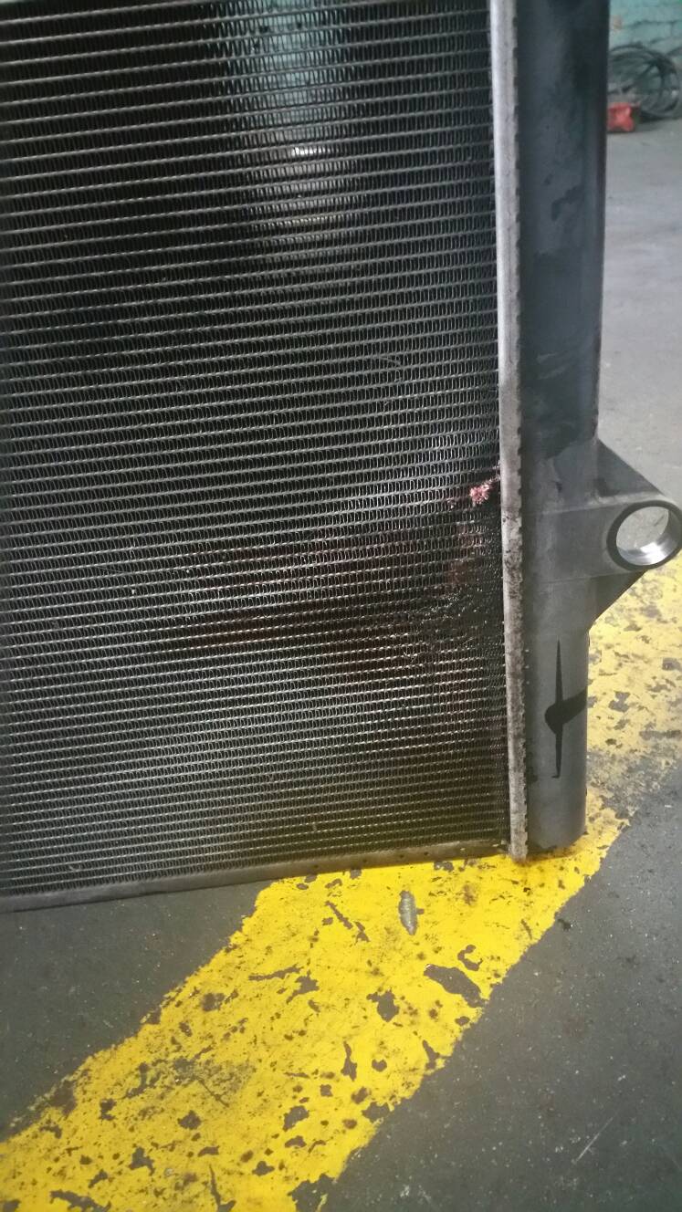

Just came back from the mechanic. No blown gasket. It turns out you guys were right and i was just tripping out of my mins. Shit. Engine needs to be running way longer than i thought in order for it to not drip as much from the exhaust, and even then itll still drip a little.
While i was there, i had the rad replaced and oil changed anyway. Best news i got all week. This is what my old rad looked like
Thanks everybody for your insights
