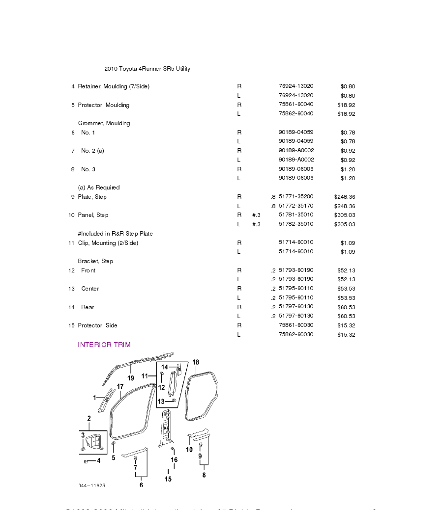

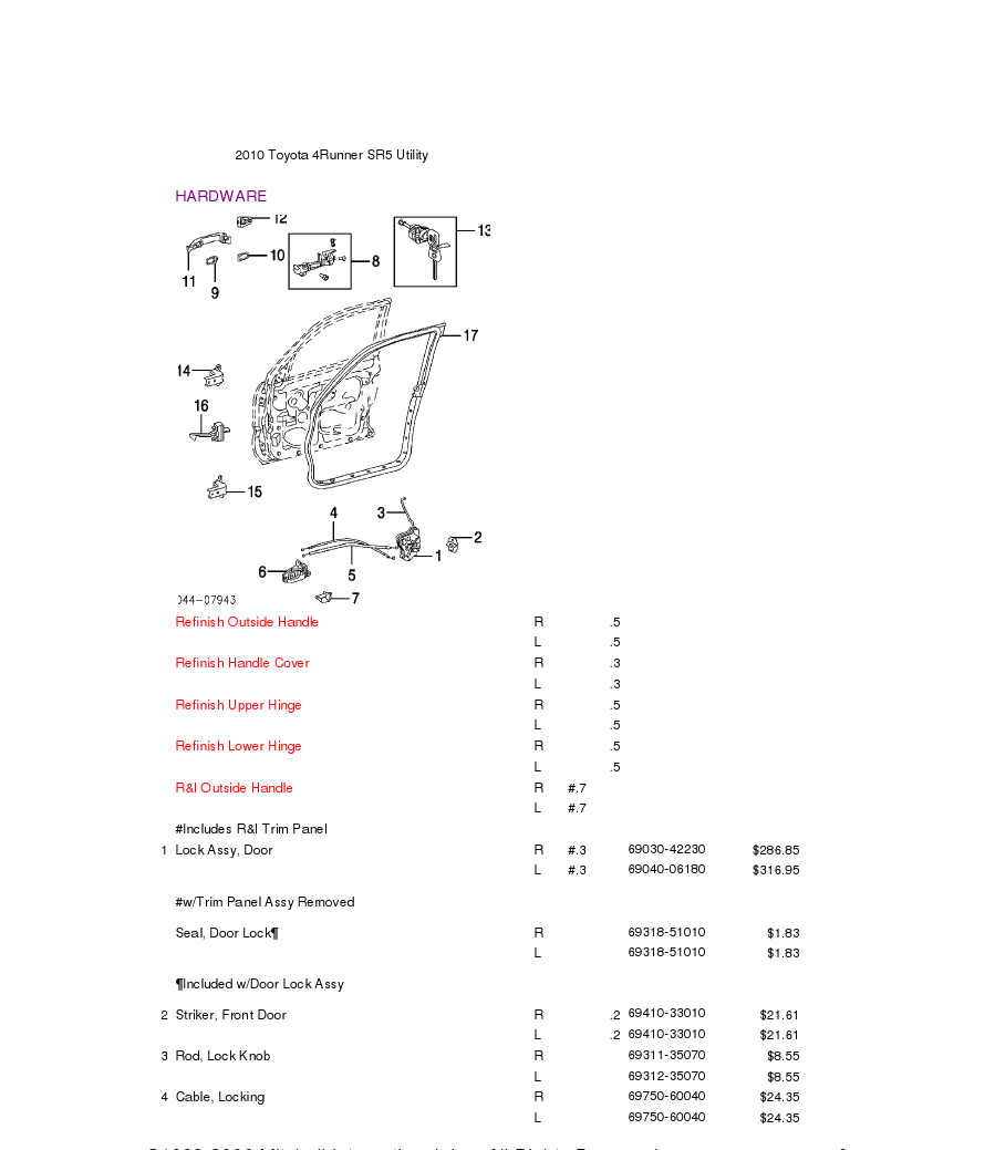

There are 2 door seals(they call them weather strips) per door opening,one on the body and one on the door itself. If you get water past those 2, then get back to us and you have something to complain about.
The place it sounds like you talking about is called the door sill, with an i, and is out board of the seals and is normal for water to get there on any vehicle I owned or remember. If there is paint there,which there is, it is not going to rust unless you scratch through the paint.
You would have to show me a vehicle where the whole door is sealed around the outside edge so the sill doesn't get wet.Pics please!
The top pic is an example for the weather strips(#17 and 18) on the body of the 4runner and the bottom one is for on the doors themselves(#17).Mine have always done their job and kept the weather out.
