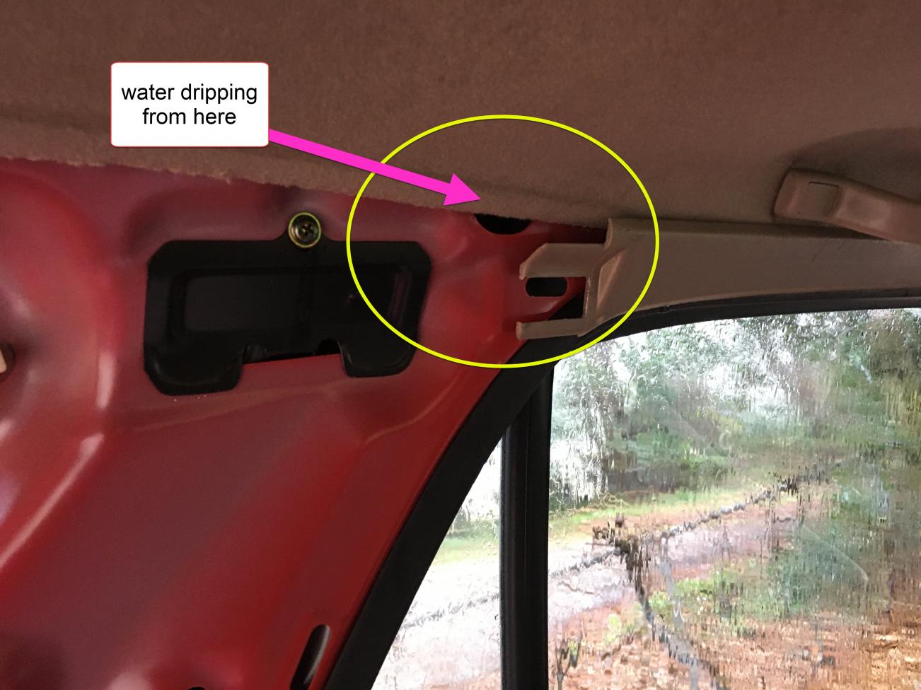

When it rains (and boy has it lately here in Georgia), water has begun leaking down from the headliner at the back driver side window. I'm assuming either sunroof or roof rack. Anybody have something similar happen to you?

Verify your sunroof drains arent plugged. Mostly that can cause the roof leaks. I seen sunroof leak very badly. :(
I believe Tim and Shawn even have a video on checking them etc. :)
Sent from my SM-J337V using Tapatalk
Maybe your hose is kinked or cracked in that area as they have a set running back to the back quarter panels inside and out and a set running into the front rockers for the front set of drains. Looks very close to where the drain hoses run through.
Definitely look into your roof rack screws. Ensure all of them are tight. I had a minor water leak in the trunk area from not tightening the rear screws all the way. Cinched them down nice and snug; leak went away.
You might also consider adding a dab of silicone to the threads to make a good seal. Toyota added some kind of thread locker/silicone from the factory to the threads, but after 20 years, they're dry rotted.
Since it's near the back, I would suspect the roof rack screw holes like [MENTION=112124]ToyotaBrah[/MENTION] mentioned over a problem with your sunroof drains. Unscrew all the screws, maybe blow some compressed air in them to clean out any debris and then put a dab of silicone in each screw hole and get the screws tight. I bet this solves your issue.

There is the video I was suggesting take a look at. As it explains all about the sun roof. Could also be the rack bolts too.

Another vote for roof rack. Pulled mine off few weeks ago to replace and vote for cleaning out all holes and add dabs silicone as well. The factory added it for a reason as mine had gobs of it on there.
I have the same problem around the pass side rear door. Ironically enough I live in GA too!~ Checking roof rack screws today, I'll try to blow some compressed air through the sunroof drains holes too.

Silicone the hole and roof rack area [ around the bracket]. That should seal it. :)

If you know where the leak is at, then removing the screw and cleaning debris from around the hole and filing the hole with enough silicone that when you tighten the screw it spreads out around the screw head should work.
