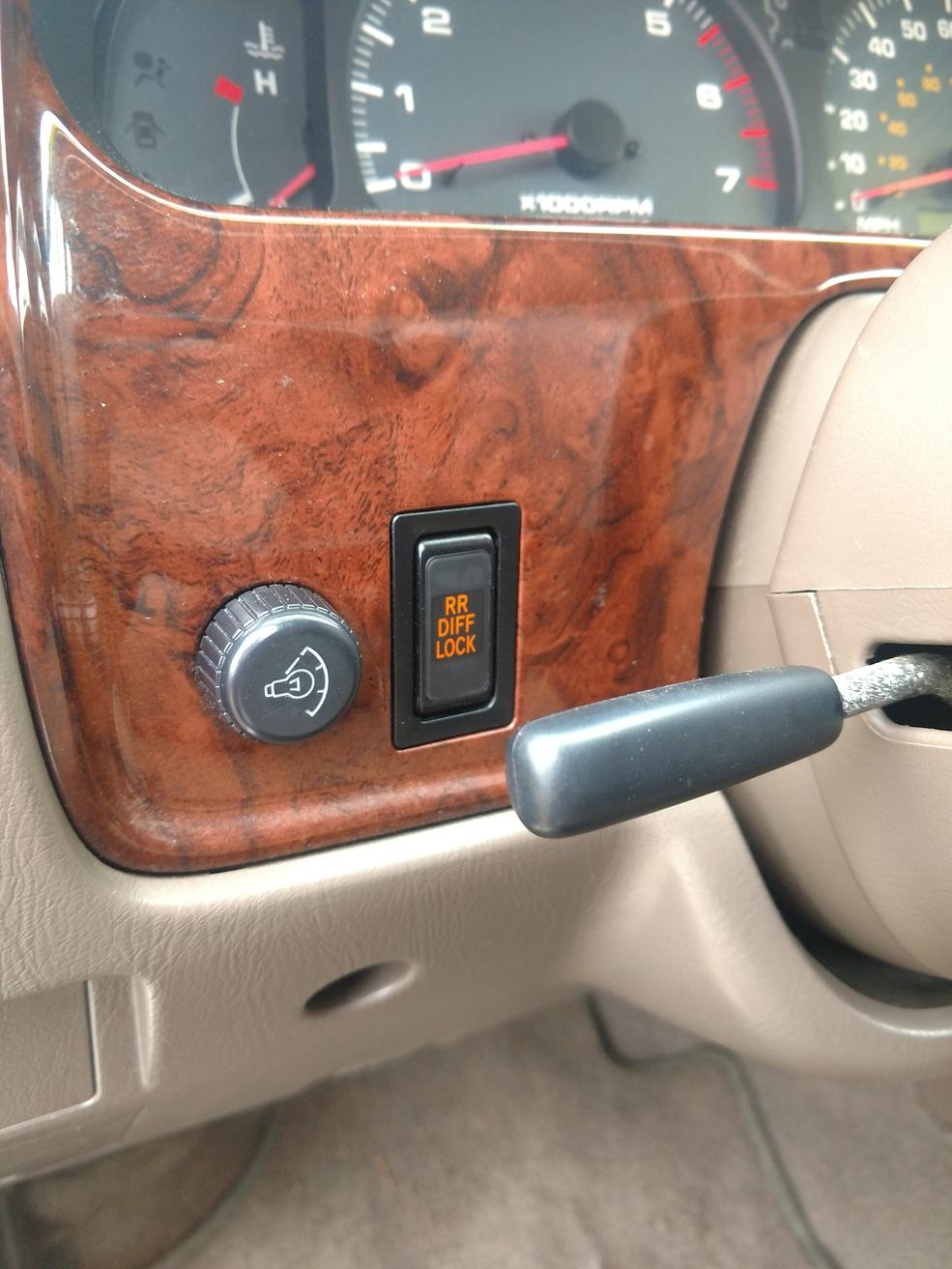

This is my RR switch. The security light is just a black box with a red led in the middle. No button. If you ask for a pic, just tell them it's an option you're looking for, not that it's rare.

Just want to note that I've heard anecdotally that some less-than-aboveboard sellers have installed the RR Diff button even though there is no rear diff. Checking VIN is the way to go I think.
A picture of the front side of the diff from the driver's side also works.
You know, funny you should mention that. I was looking up 4R stuff on youtube last night, and a video came up about this very thing. In this particular video it was about 80 Series Land Cruisers, but same deal. The guy explaining it in the video suggested trying to engage them to make sure the dash light comes on as a quick way of verifying the switch is actually hooked up to something.
He said they (auto auctions in this case) get away with it by not listing lockers in the vehicle description. They bank on people seeing the switch and paying more for the vehicle.
Getting underneath and looking for their physical presence sounds like the most surefire way.
