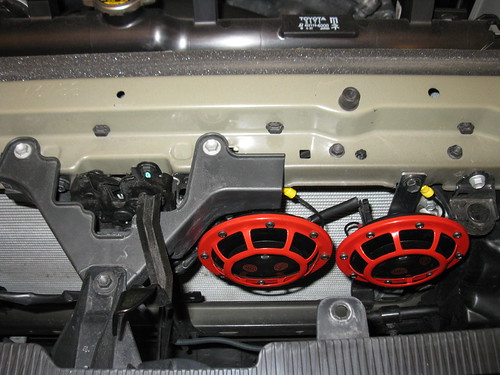

I followed your advice and purchased the FIAMM pair.
I installed the two horns on the SR5 (see install pic), and the horns don't sound.
I first tested the stock wiring harness with one horn and it worked. I then spliced the wire out with a join and split Y-fashion to both horns (see wire diag image). Then neither worked. I disconnected one, and it still doesn't work.
I believe I attached the hot leads to correct terminals per horn instructions and grounded correctly.

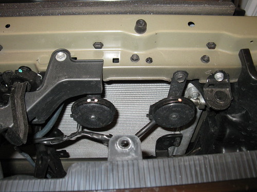

OEM horns with dual leads:
Hella Horns with factory dual leads:
You can see that the factory harness connects to the two Hella's. I did not use the relay that was provided in the kit. Not sure if they are drawing enough current off a single feed instead of the factory harness dual leads.
Because you have a Limited. SR5 has a single horn
