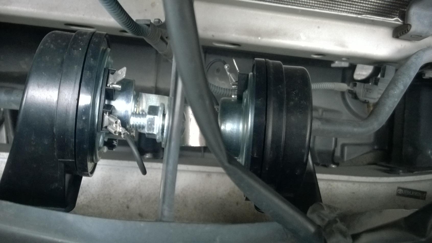

Help with wiring install
Hey all,
I followed your advice and purchased the FIAMM pair.
I installed the two horns on the SR5 (see install pic), and the horns don't sound.
I first tested the stock wiring harness with one horn and it worked. I then spliced the wire out with a join and split Y-fashion to both horns (see wire diag image). Then neither worked. I disconnected one, and it still doesn't work.
I believe I attached the hot leads to correct terminals per horn instructions and grounded correctly.
What could be wrong?
Thanks!

Does that horn have a place for a ground...is that what the other terminal is that I see?
Check all connections, use some type of tester to check power to the horns.
Locate your fuse, check to see if it is blown.

I think you need another ground, check out this install [MENTION=55815]Okki[/MENTION] did...
http://www.toyota-4runner.org/5th-gen-t4rs/94578-okkis-build-thread.html#post832441

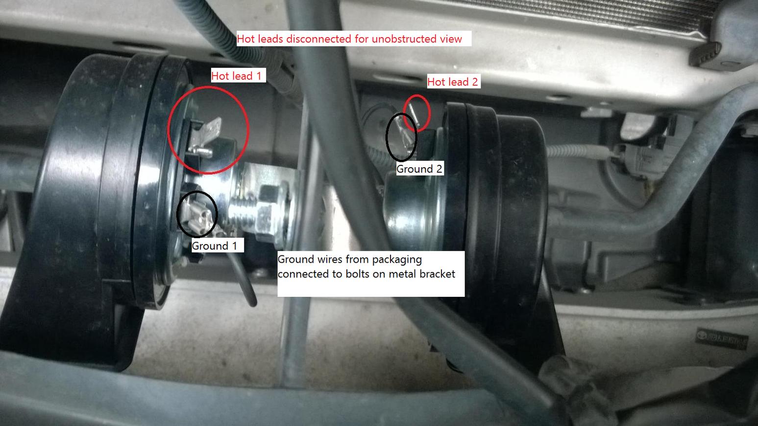

I realized the picture was unclear, so I've updated it below
Hot leads are disconnected in the picture
Grounds (black) are wired to the metal attach bracket
Fuse is intact
Tested power to the horn wire - getting 12V when horn pushed
Thoughts??
