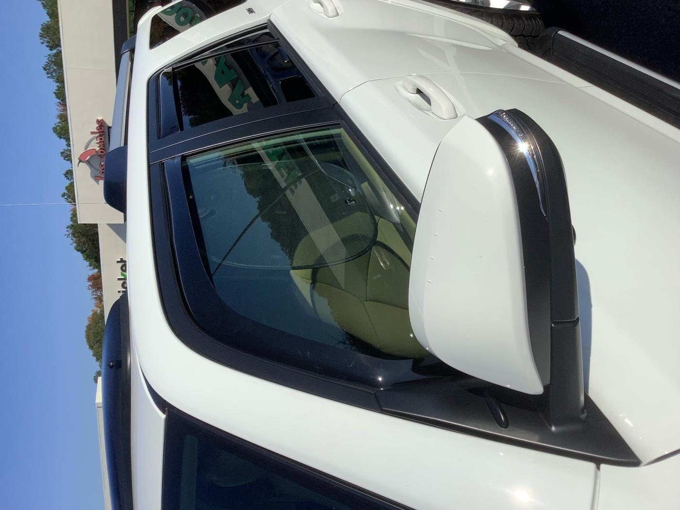

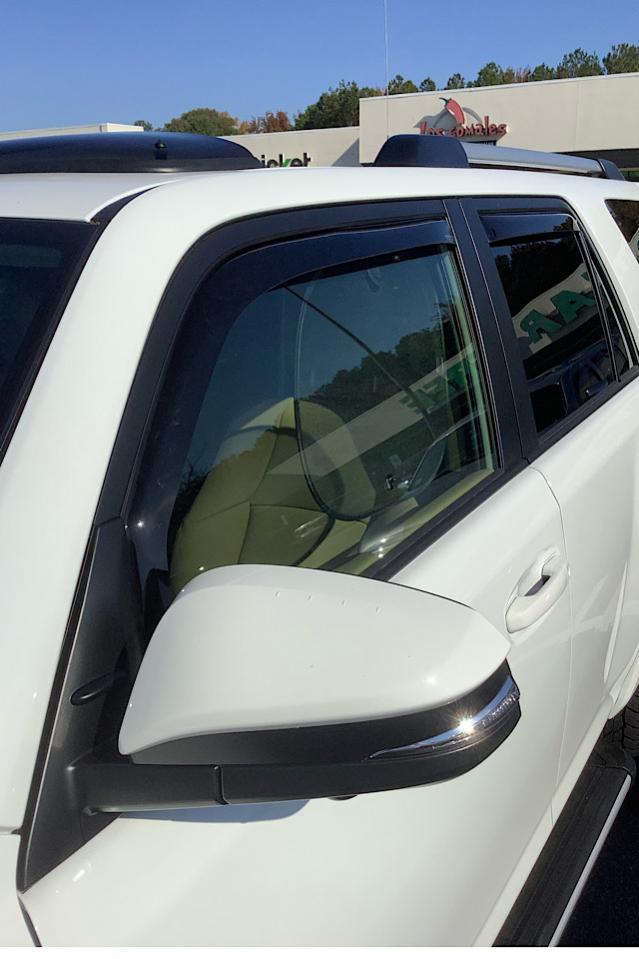

OK, eTrailer site shows the side window deflectors have been verified to fit the 2022, so I Ordered. I can return if they really don’t fit

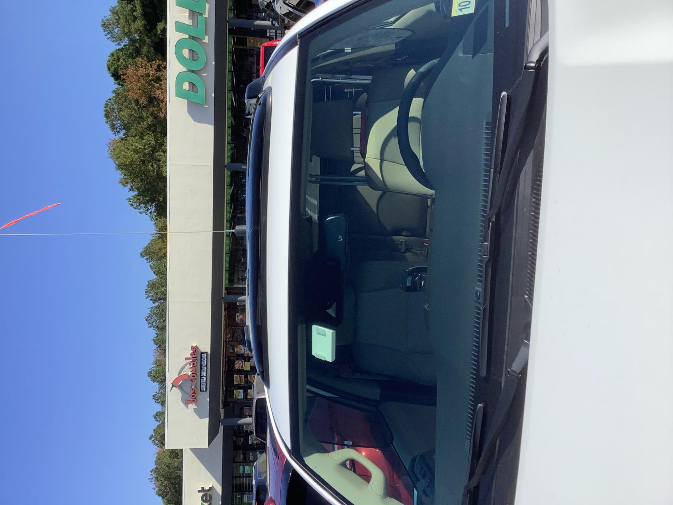

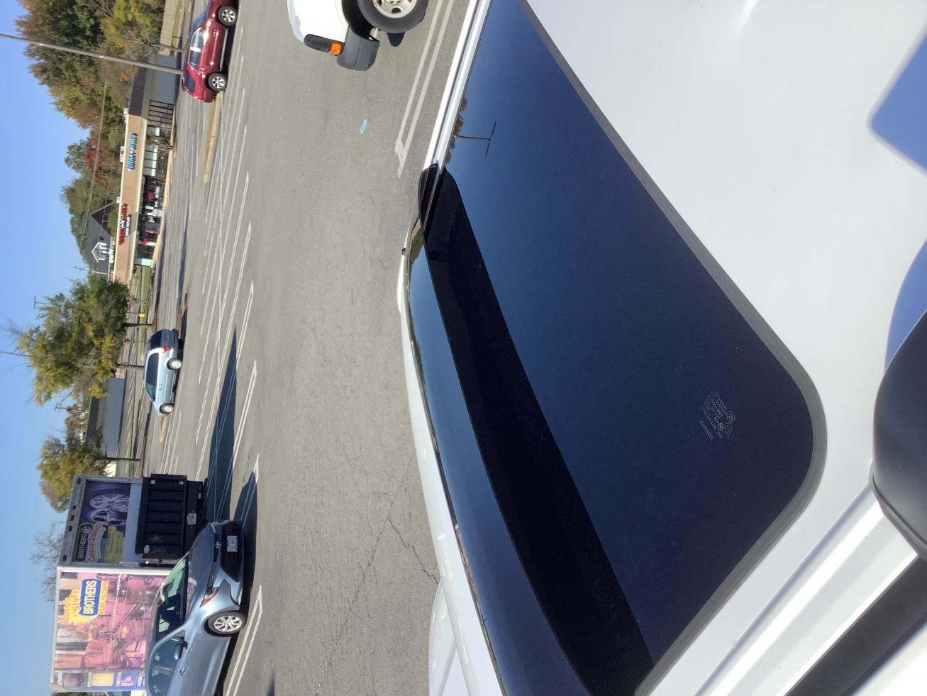

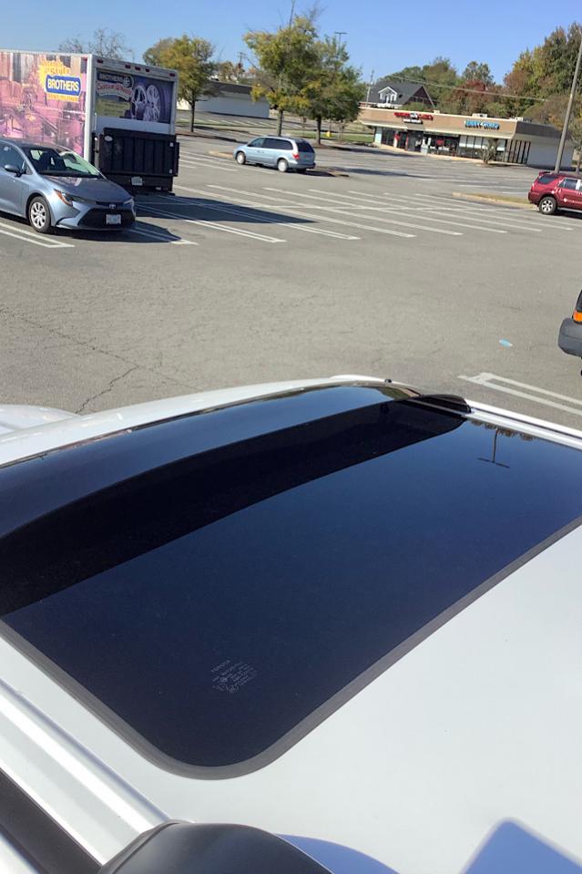

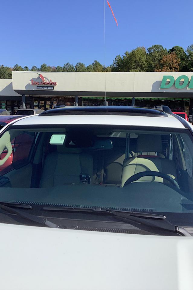

Bit the bullet and got the moon roof deflector. Fits just fine. Had to get #2 x1 inch screws as the #10 x3/4 inch were a bit short to engage the clip that holds it on.

I had the in channel side window deflectors (same part #) on my 2016 SR5 until I traded it for the 2022. Never had a problem. They fit just fine on the 2022, as they did on the 2016. Don’t anticipate any problems based on 2016 experience.
Moonroof deflector fits just fine. I did have to get #10 X 1” screws as the #10 X3/4” that came with it were a bit short and could not get them to engage the self threading nuts. I think maybe the screws were for a different vehicle as that moonroof per Weathertech website fits at least one other vehicle, an Acura.
BTW many folks report having problems with the rear window deflectors falling out. If you follow the installation instructions that include leaving the windows up for a period of time so they seat properly, there should be no problem, as there is a strip of sticky tape on them that goes up into the channel and helps hold them in place. I left both my 2016 and 2022 up 3 days, even though procedure says 12 hours, more if cold weather.
