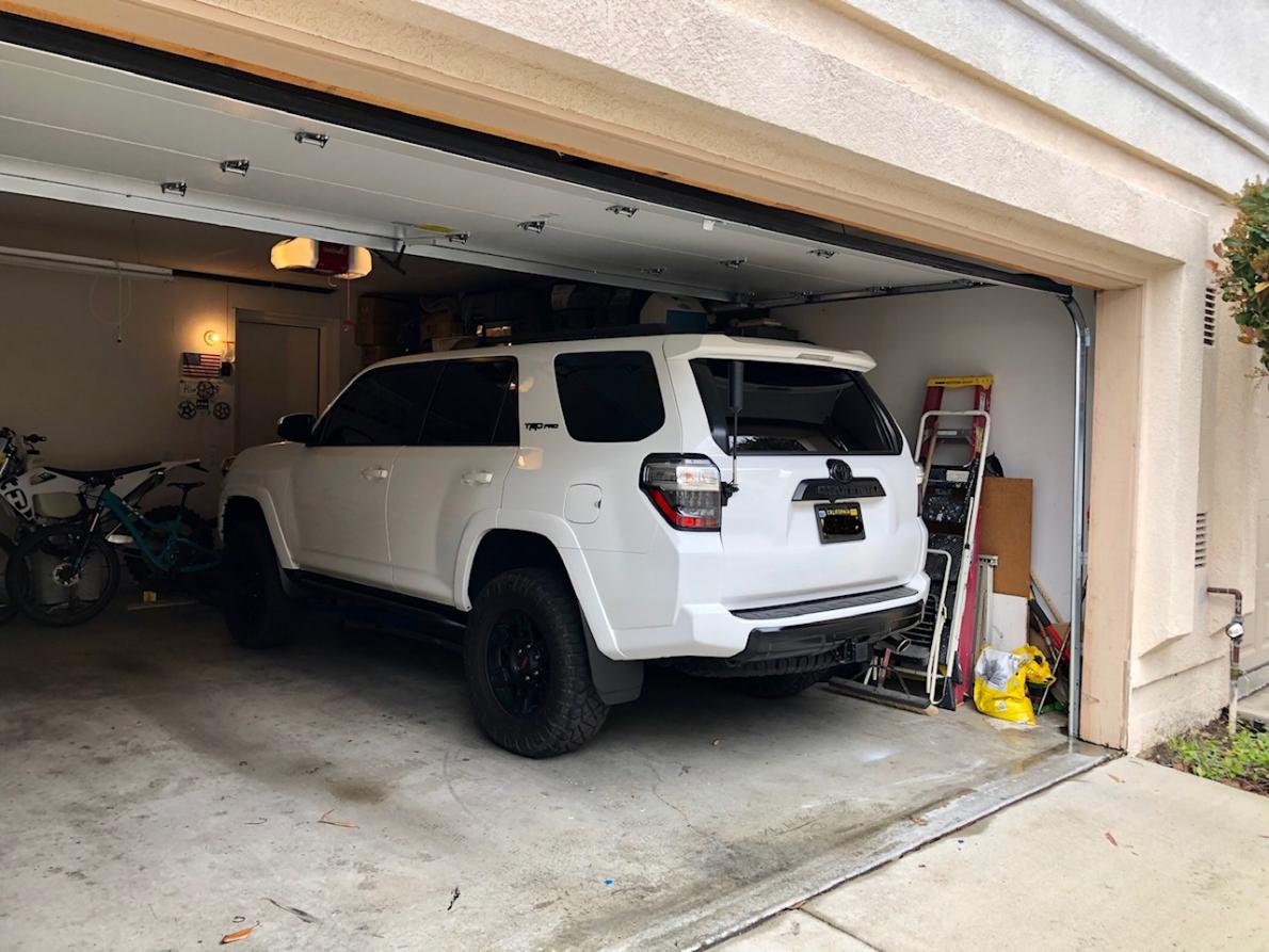

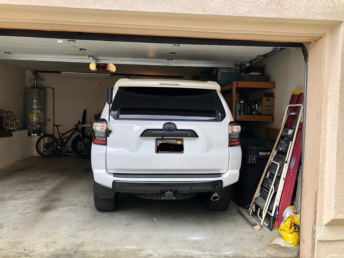

Soft install done. Roof mount didn't work out very good so I went with a hatch mount that I had to modify a little bit with the bench grinder. Turned out good. Instructions reflect that head of antenna needs to be above roof line. I will move the antenna up if need be in the future. I drove to a spot today that has anywhere between 1X and NO SERVICE for reception. With the Weboost on I got LTE 3/4 bars. Impressed. Real test next week when i head to Bishop area for a few days.
