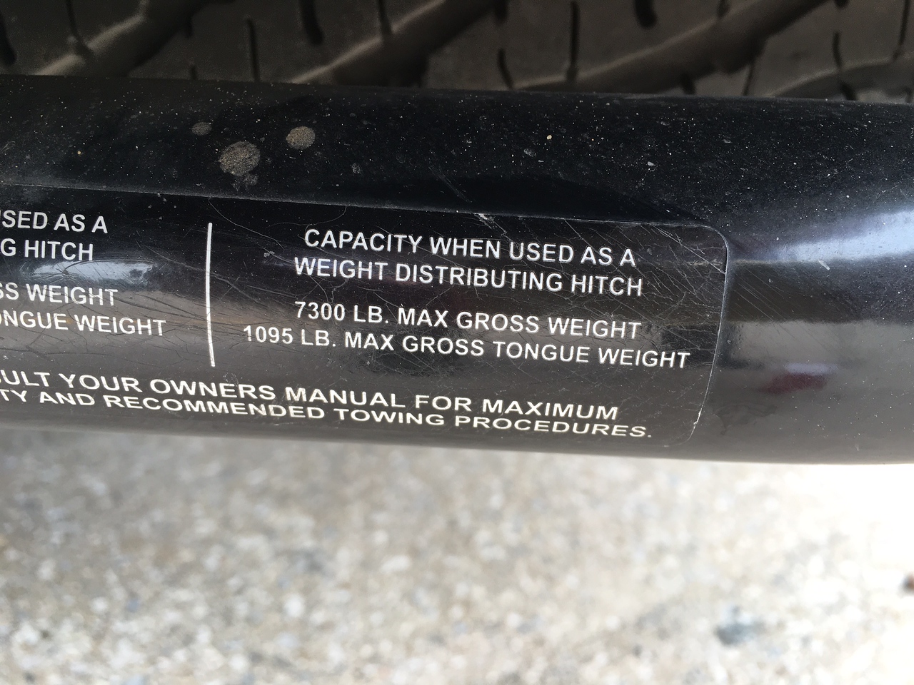

The receiver is a factory installed Reese. Limits are 5000/500 but the receiver is WT CARRY ONLY. Thats why I need to replace it with a WD capable receiver, not because I'm looking to gain towing capacity (I can't). I spoke with a technical rep at Reese (owned by some other company now). She said the reason for the WT carry only limitation has to do with the testing of the receiver and not the vehicle. I don't have the manual and haven't been able to find one online. All the links I've tried have been dead ends. Toyota's website has most of the manual, but not the section that covers towing.
I prefer the easy to install Toyota hitch, which was recently purchased for use on a 2007 Lexus GX470 for less than $250. Same as on my 4Runner. A real Toyota part, not some aftermarket.
Part number: PT228-89460
Fits identical on a whole lot of 4Runners and GX470s.

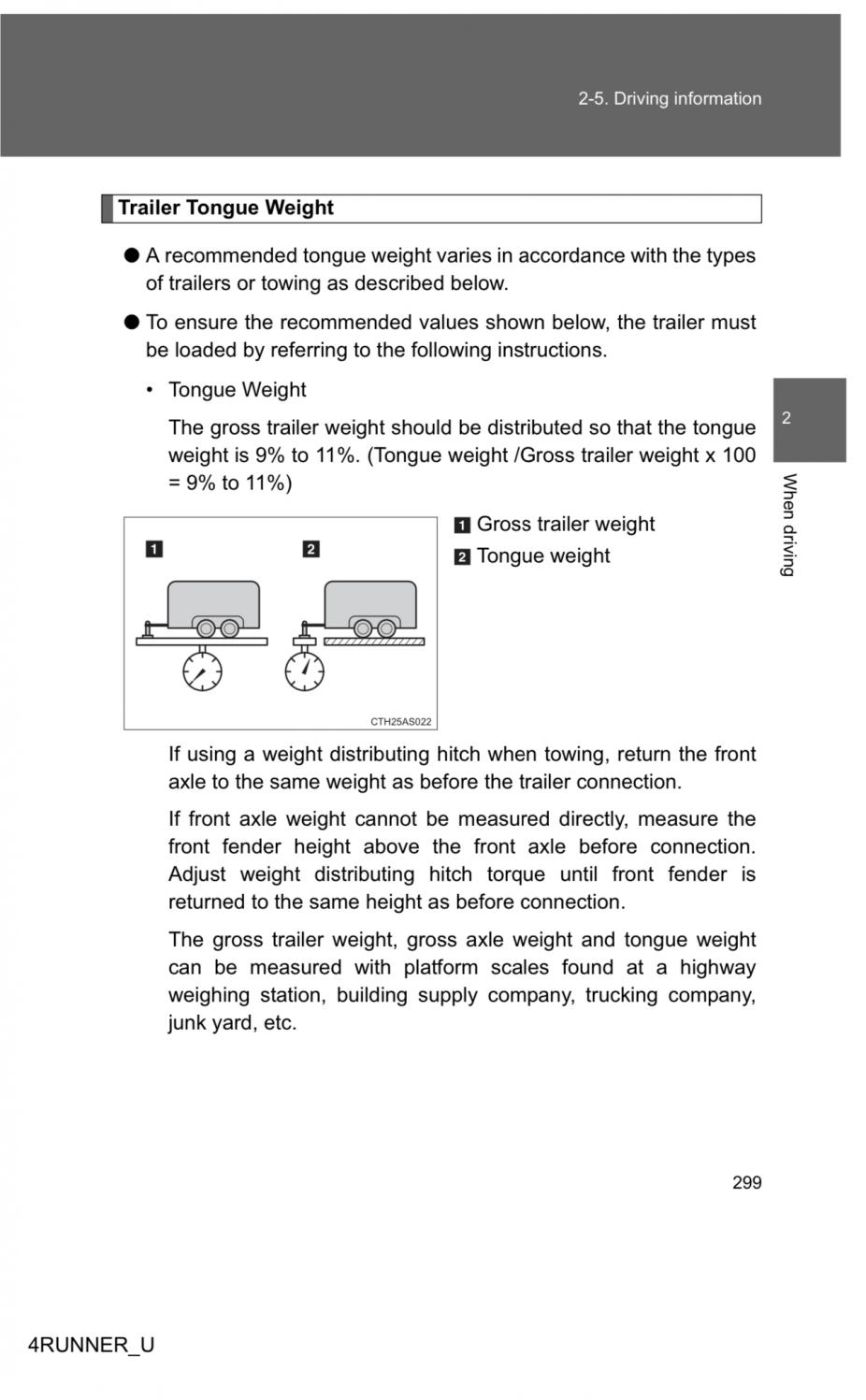

I created this account just to share the page from my 2012 5th gen owners manual.
I think it’s hilarious because I read through all 8 pages of this thread and was convinced a WDH would twist my frame and total my ride. Then I’m like “I have an owners manual, durrr” and check for my self: It not only allows WDH, it even gives you helpful tips on setting it up!
