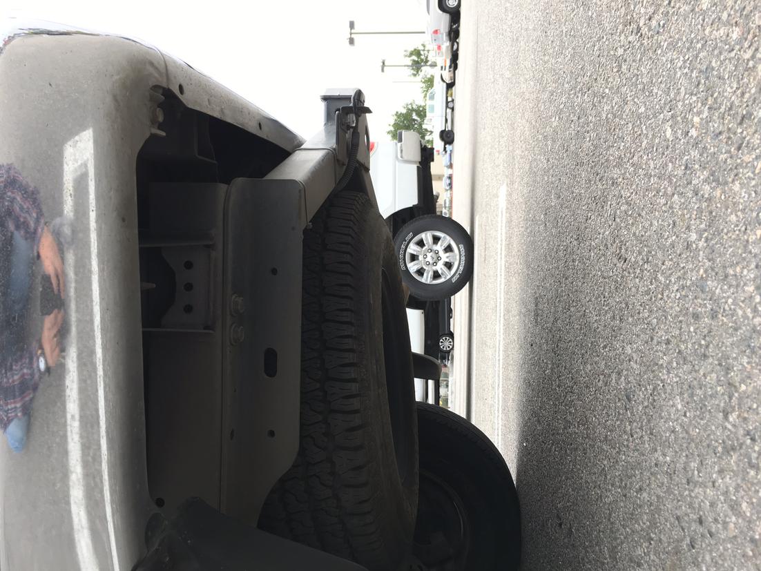

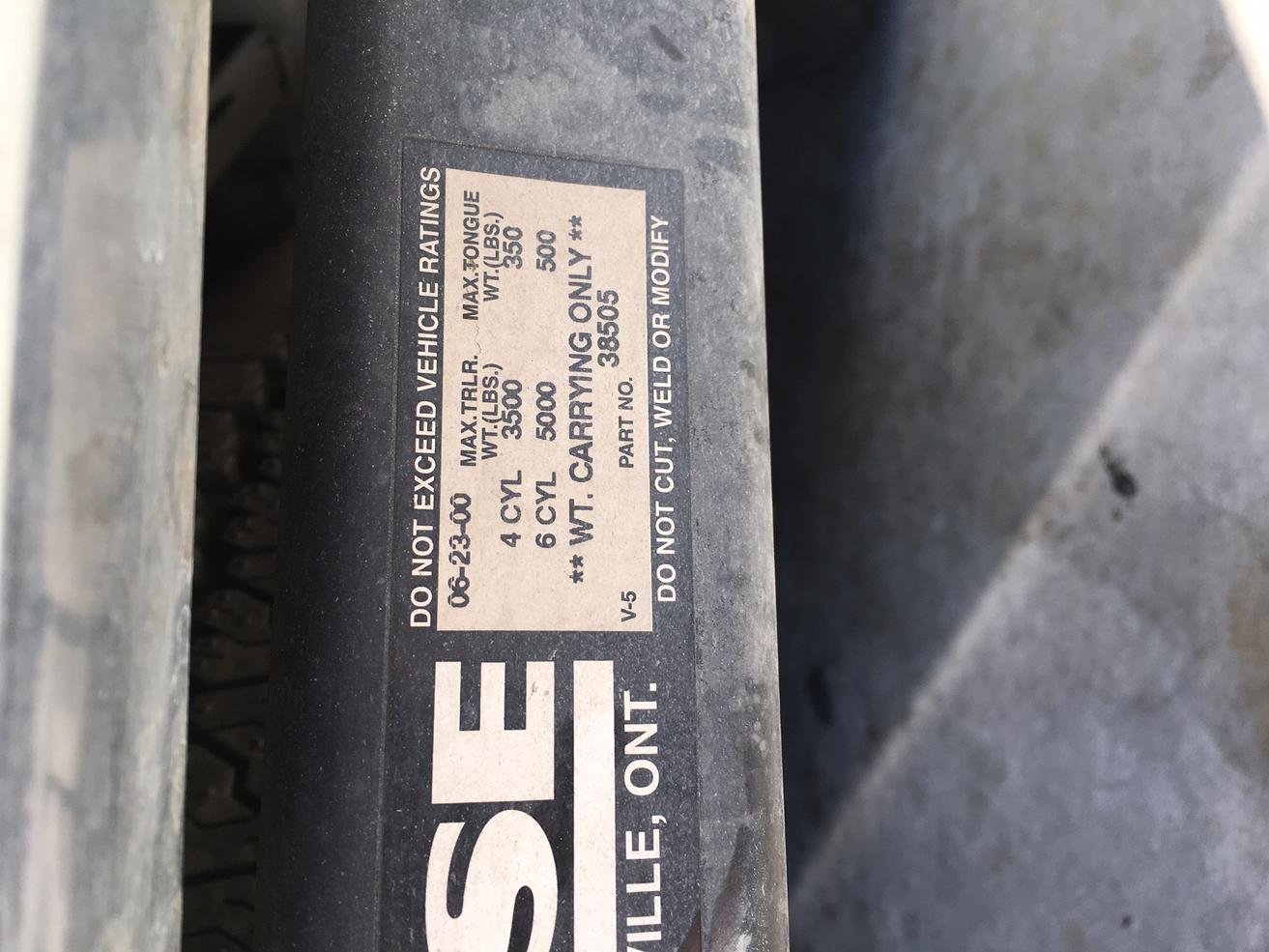

To either clear up or add to some of the confusion, I have a 2000, 2WD, 6 cyl. with the OEM receiver. It is mounted to the frame but it is stated on the placard that it is to be used for "WT. CARRY ONLY" so for my truck the mounting style is not definitive proof that it will work with a WDH.
Sorry for the pictures being sideways. Not sure why they loaded that way.
It seems pretty obvious, to me. The ratings on the label are specific, " WT. Carrying Only", with a max weight limit of 3500 lbs and a max tongue weight limit of 350 lbs for the V4 equipped vehicle, and 5000lbs/500lbs max limit on the V6 equipped vehicle. Therefore, the engineers that designed the vehicle/hitch system did not want you to use a WD/Weight Distribution towing system with it. So, to answer what I think is your initial question, Yes, the fact that the hitch receiver is mounted to the frame, does not mean you can ignore the warning label and use a WD towing system.
If you have the V6 model, then the 500lb/500lb max limits using ONLY a Weight Carrying tow system are your designed limits. If you wish to ignore these warnings, and use a WD system, it's your choice. You will have to live with the possible consequences.

It wasn't a question. Like I wrote, I was contributing to this thread on an aspect I did not see had been discussed. Pointing out that the installation method is not proof of the capability as that may not be obvious if someone is missing their placard.
