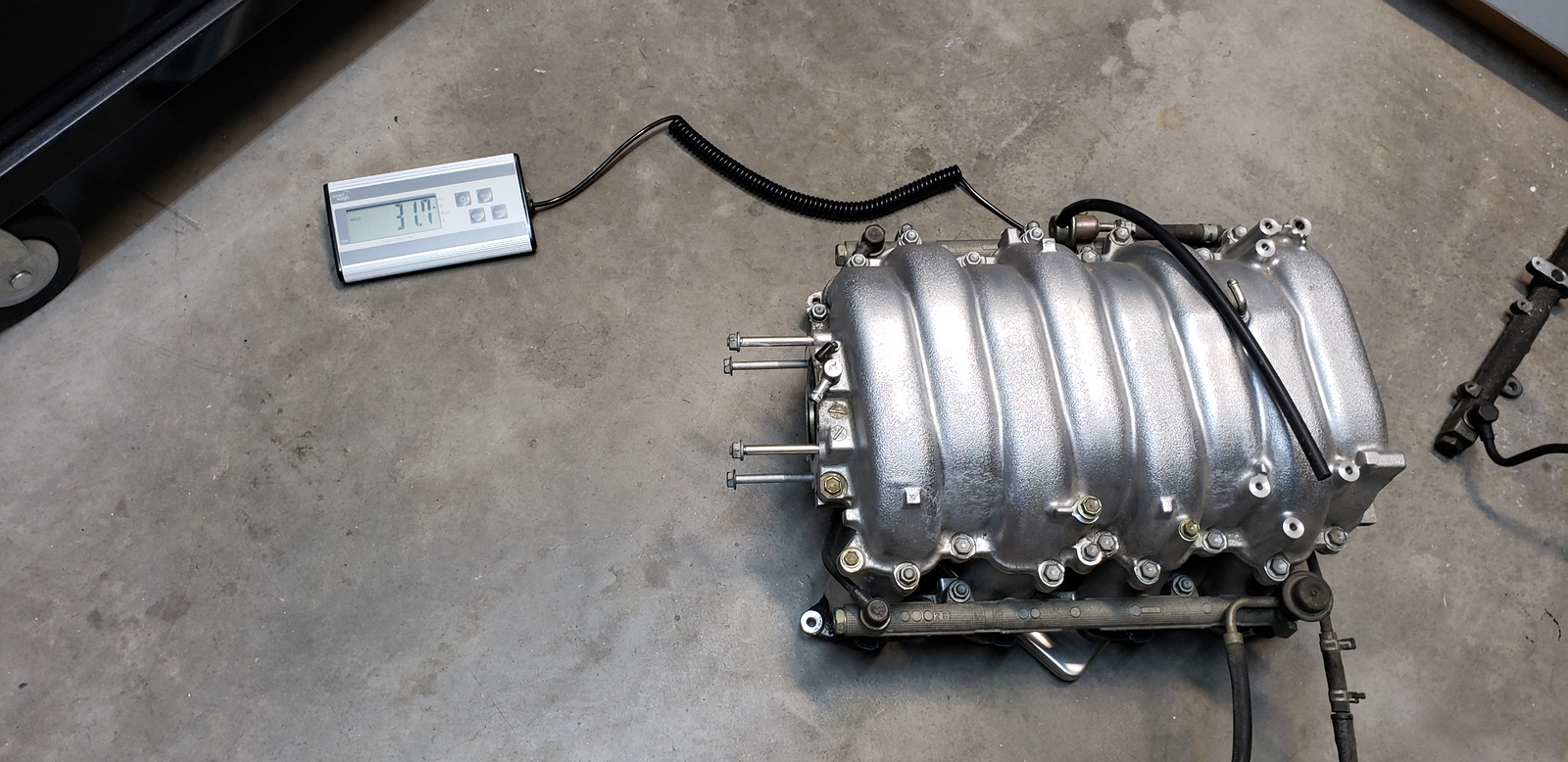

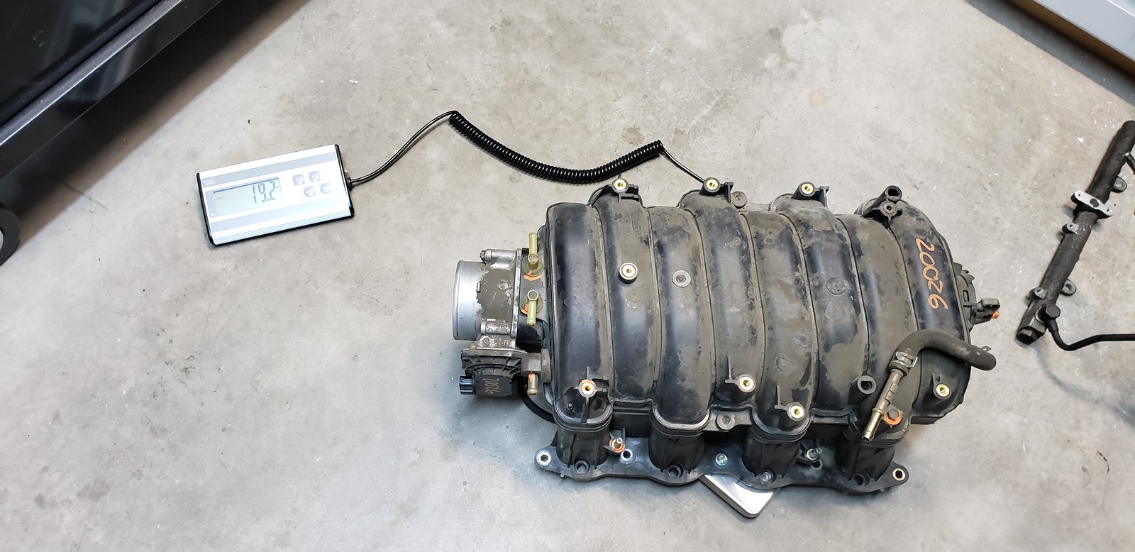

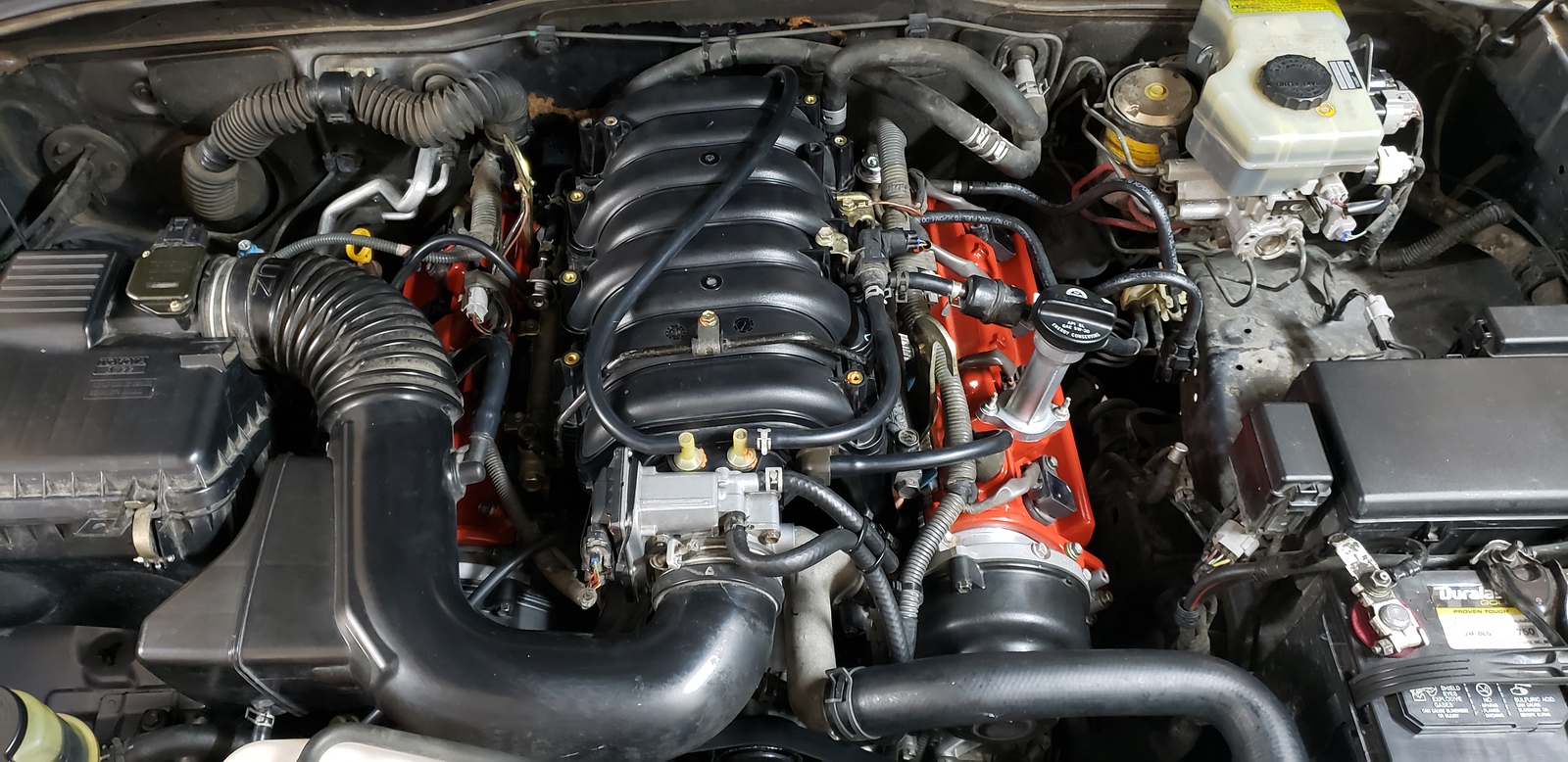

If you have a 2003 or 2004 V8, the non-VVTI motor, swapping the aluminum intake for the later, 2005 up VVT plastic intake, cuts 12.5lbs off the top of the motor. And gives a small performance bump. MPG remains pretty much the same.
It's a direct swap too. You need the intake, fuel rails and throttle body from a 2005 to 2009. New throttle body has to be flipped on the intake to be able to plug into the harness without doing lots of wire splicing.
This is on my 2003.

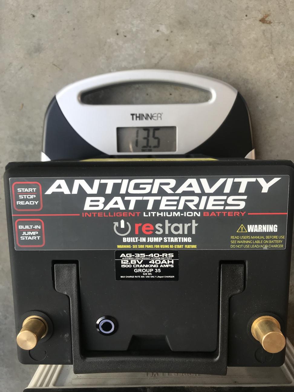

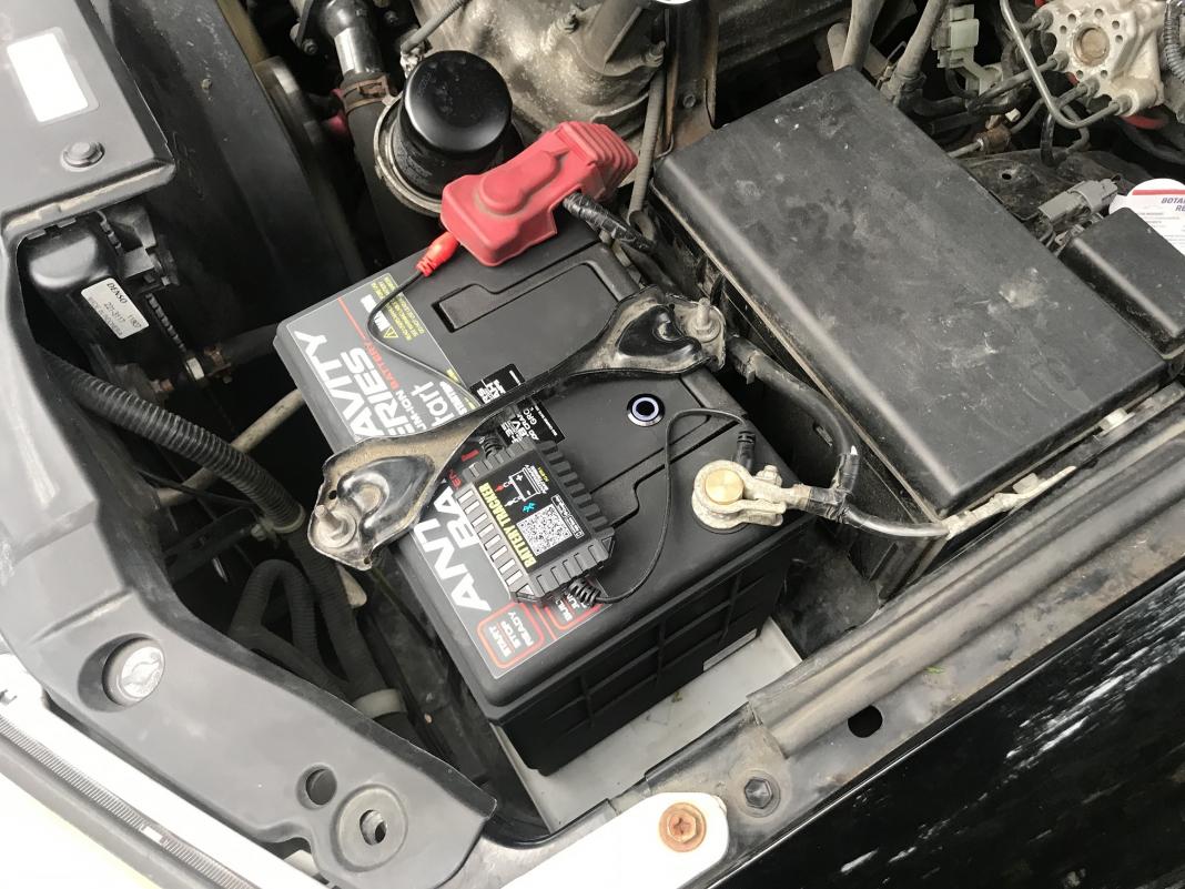

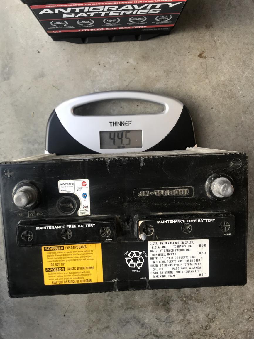

Well, as a somewhat out-of-place weight weenie in this world, I knew I'd have something worth sharing sooner or later...and here it is.
Over the holiday break I worked with my friends at Antigravity batteries to source a Group 35 battery for my trusty 2008 Toyota 4Runner, still having its original 13 year old factory battery in place (but failing steadily for the last year, down to 200 CCA at last point of measure in December).
Although I'm definitely aware that many won't like the cost of this battery compared to its peers, there are actually some super handy features that may not be obvious.
- 31 pounds lighter than stock (probably obvious)
- Built in RE-START technology (has a reserve just for emergency starts)
- Long service life, and based on Smart Lithium-Ion
- 1500 Cranking Amps! (this sucker starts in a big hurry)
- Remote control for RE-START activation
- Smart technology to monitor battery health via Bluetooth and smart phone
Every time I approach my 4Runner and get within range, the smart monitor sends a message via Bluetooth to my phone and it reports how healthy the battery is. You can configure it to send you a variety of alerts and do performance data management over time.
Although it's very true that the weight weenie in me primarily wanted this battery to lose 31 pounds off the nose of the truck, there are so many other cool features to make it worthy of consideration. It's my second AG battery and the team there is truly awesome, and I recommend their product wholeheartedly.
Anyway, I have a few pictures to share. If you have any questions, just let me know and I'd be happy to help if I can. In case you want one for your 4th generation 4Runner, it's the Group 35/Q85 application that works for us.

The battery swap isn't something you can just quantify easily by cost alone...it's more of my passion of being a weight weenie and a tech junkie that makes it worthwhile personally.
For the record, I do manage to jump on their seasonal discounts so the price isn't quite as high as you think from their website, but let's not kid ourselves to believe that it's affordable...because it's not.
However, I still had my stock OEM battery after 13 years of faithful service, whereas I know others who may have gone through 2-3 batteries in that same period of time. So I suppose that could be considered. :yo:
What do you think of that Battery Tracker? I have a InduraPower battery that basically has those tracker's features built-in, but unfortunately the app doesn't work (engineer I talked to said they're still working on it), which was one of the reasons I bought the battery in the first place...the vehicle I have it in is in storage.
What to you think of that Battery Tracker? I have a InduraPower battery that basically has those tracker's features built-in, but unfortunately the app doesn't work (engineer I talked to said they're still working on it), which was one of the reasons I bought the battery in the first place...the vehicle I have it in is in storage.
So far so good but I have to admit the feature I'm using the most from it is just the real-time health snapshot as you approach your vehicle.
We had a power outage for 26 hours a few days ago that led me to do some phone/device charging in my driveway (several hours worth) and when I approached the truck to start it the next day I saw my battery was down to 82% power. That was interesting to see as I have never had any metrics to note previously. Generally when I approach my 4Runner the battery is at 99% or 100% normally.
I have noticed the app has asked for updates twice since I've had it, and the notable downside to an update is that it informs you that your performance history metrics will be lost. I'm not studying those regularly, but it's a little bit of a bummer that it will reset your history at the time of the update.
Other than that, all is well and it's a neat add-on.
