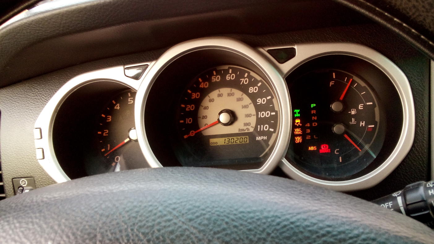

SO sadly today @ 130200 miles, my brake system/MC failed......just came back from a 20mile round trip during my luch break, car was ok, parked the car...got back to work, 3 hrs later i enter the truck to drive home, as soon as i start the car and engage gear, i hear a high pitched warning sound and all the lights on my dash light up, brakes rare pretty useless, gotta stomp on them with all my might b4 the truck stops.....
i have had the buzzing/pulsing brake pedal issue for 2 yrs now, so i guess it has finally crapped out, dont have the $$$$$s for a new MC/brake system, so i intend to pick a used unit from ebay, and go from there...........need to figure out how to manually bleed the brakes after swapping out the bad unit
[MENTION=66389]BlackWorksInc[/MENTION] i guess anyone with a similar pulsing brake issue, shoud prep for the day it craps out

UPDATE: i gave the abs motor, several knocks with the ignition on, and it grudgingly kicked on, after a few pumps, it has returned back to normal [the way it was before], with the car off, and the ignition off, it kicks in every 70 to 80 secs, and kicks in everytime the brake pedal is depressed.. based on this, could anybody with experience confirm if this is a sign of having air in the system or a leak??......

Sounds like the motor is going bad. That's typically the way you test for a bad starter (dead winding) is by tapping it to get the starter to turn slightly and engage the next winding, until the next time it stops on the dead spot and the car won't turn over.
Sounds like motor section is toast to me, probably part of the buzzing you heard for so long.
