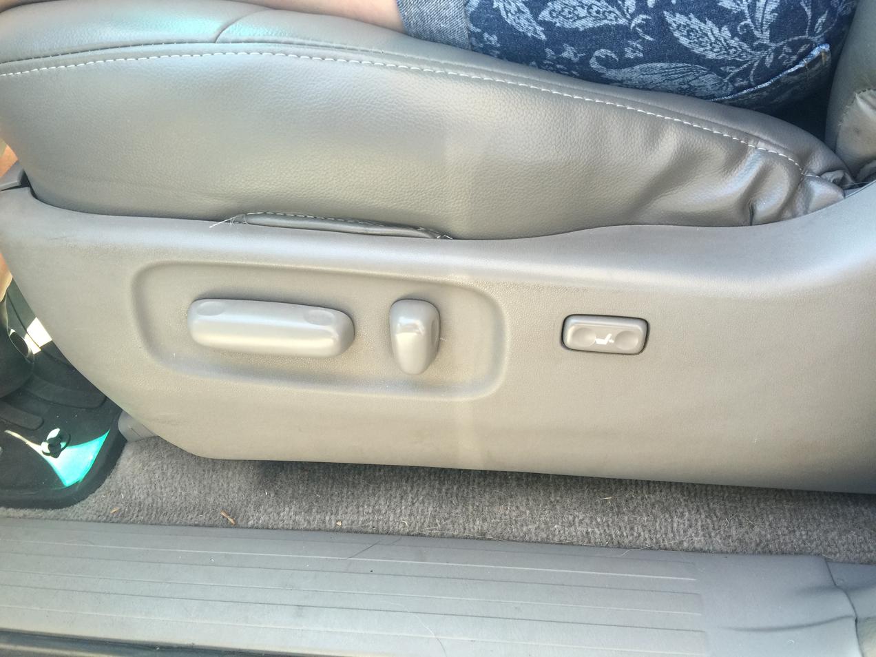

Hey guys, so the wife and I finally pulled the trigger on gently used '03 Limited (which we love), but i'm trying to figure out what the deal is with the leather on the driver's seat. The Carfax when we purchased it didn't so any incidents at all and I checked the vin stamps on all the doors and panels, so i'm 99.99% sure it has not had an accident in it's life.
My suspicion though is that something weird happened with the driver's seat where an airbag may have been deployed. I'm really hoping not but just want to know if anyone else's seat looks like this.
The back part of the bottom is all misshapen and the bottom stitching is too tight to fit under the plastic. Just trying to figure this out.

Looks like it may have been a leather seat cover and the edge is popping out from the plastic trim cover. Might just need to be readjusted.
Had it happen on my passenger side. Pushed it back in and has not been an issue since. I suspect I did it when cleaning the leather
Don't forget it's 12 years old and getting in and out of the seat, not to mention adjusting it for different drivers may have cause some shifting.
That being said, the leather looks to be in fantastic shape for the age of the vehicle. Congrats on the purchase.
Thanks guys! Yeah that makes sense, it is 12 years old and it is the driver's side. :) thanks for the help and I will try and get it readjusted. I assume taking the plastic off the bottom and repositioning the leather cover should do the trick then.

It may have been reupholstered because the old leather was bad, try to tuck the sticking under the plastic and see if you can live with it. If not there's a thread somewhere that shows how to tear down the seat cushion, you may be able to stretch the leather a bit better.
if I remember correctly there is a plastic clip attached to the leather in that area that curls under and clips to the seat frame. just take off the plastic side covers(2 or 3) Phillips screws and unclip the power seat switch and the cover comes off. if the clip popped off the frame just pull tight and try to clip it back on. it should be tight but it will go. then reassemble.
good luck.
I'm with BlackWorksInc on the suspicion of that side of the driver's seat being re-upholstered.
My 03 has all kinds of tears and cracks in the thin vinyl covering in that very spot of the driver's seat. I suspect the previous owner had it fixed up for when it was sold. Hopefully you can get the leather to stretch back into proper shape.
And, yes, V8man the 03 (at least my Limited) has side airbags in the upper seat area.
