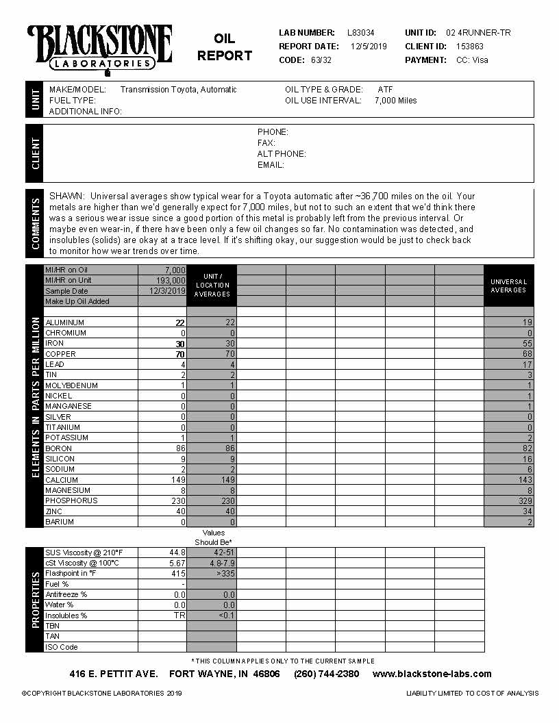

Any chance you can come up with that TB? I finally got a hold of the dealer, and they said they put T-IV in when they flushed it....
I got my labs back from Blackstone. The results are attached.
Sounds like you found your problem. A complete fluid swap should fix it as long as there isn't any permanent damage from the T4.

Thank you very much! I actually called back, but slowly baited them. I had another tech answer, that sounded a lot more intelligent. He actually looked it up, and told me Dex II or Dex III which is what my dipstick says and we all know is what it requires. I then asked what would happen if T-IV got put in, and he explained all the problems and in my mind was correct (also not what I was experiencing) Then I had him lookup exactly what fluid was put in my 4Runner and it was a Dex III. So NO T-IV thankfully.
Anyway, so far no more issues. Although it still runs hotter than I would like. I have no idea how old the clutch fan is, but I am strongly thinking of running a B&M Cooler in line with my radiator. I would run it standalone (Well I would probably do a Tru Cool for standalone) but I am in Wyoming and it can get down right cold here. I just wouldn't want to run it to cold, if it gets -20 to -30 here which is does and can.
