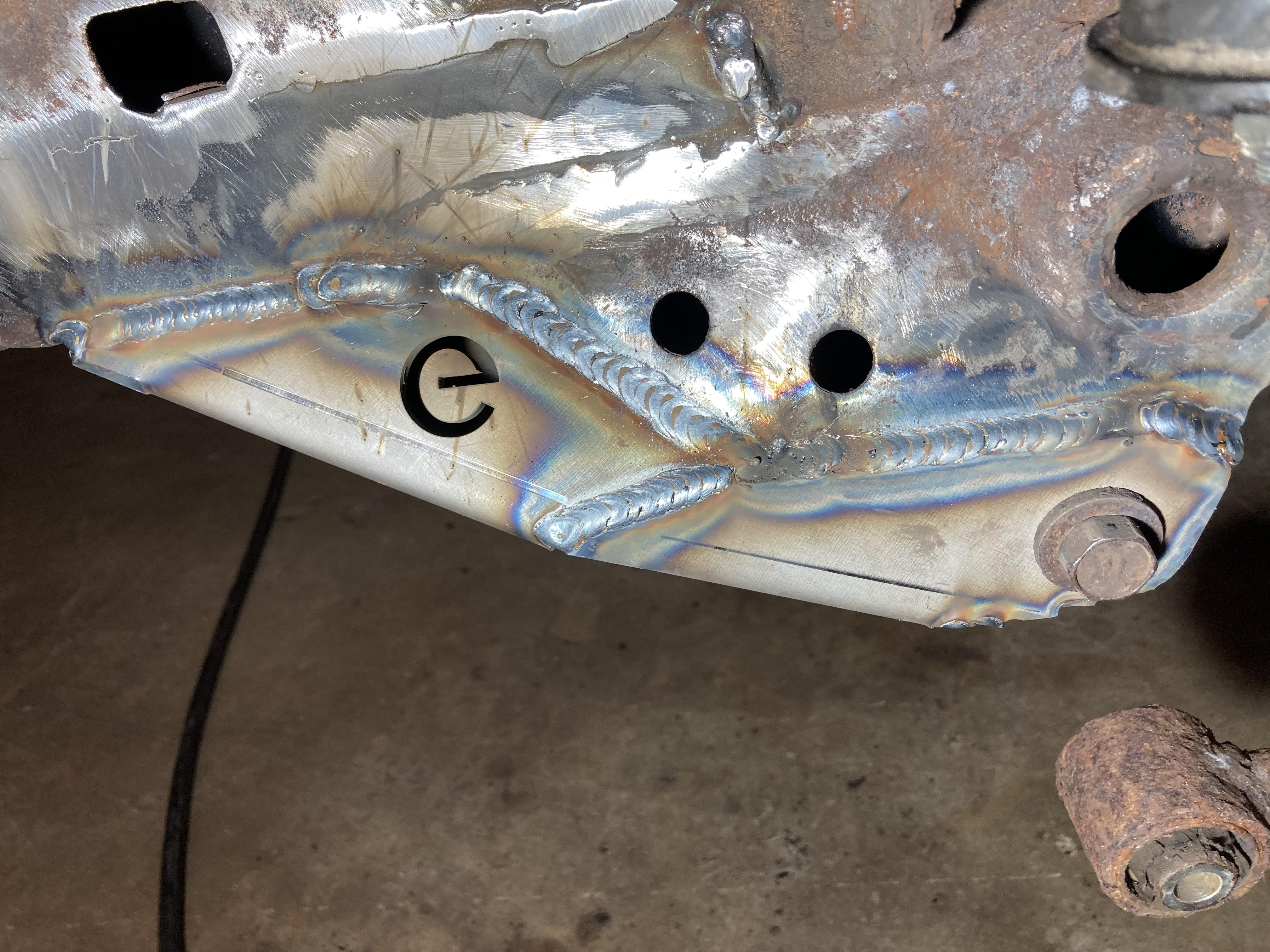

i’m in the process of welding these supports on, dropping the tank was easier than I expected and 100% necessary to do a good job. Of course my rear strap was rotted away so i only had two bolts holding mine up....
