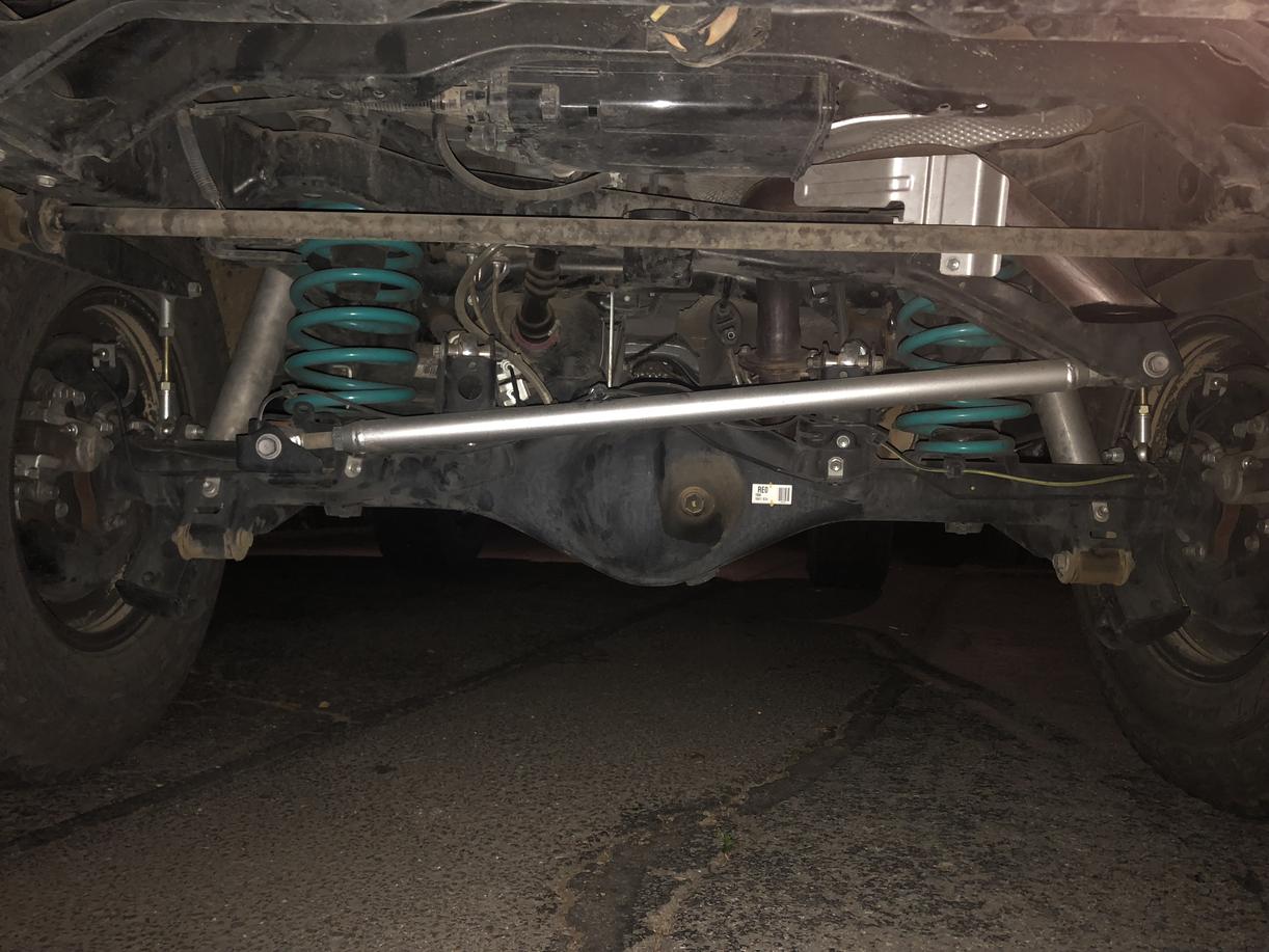

No angles, but for quick reference here's my rear panhard, again at over 4" of rear lift, nothing to be concerned at in my experience.
