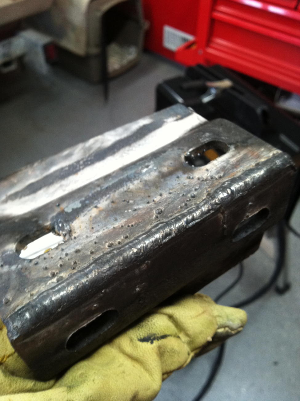

Well guys- thanks for the good advice! I had a little time to practice with some scrap and I think I actually made a decent weld here! It's strong too, the bracket bent when I hammered on it in a vice- weld held great.
CLEAN metal and setting that helmet correctly helped a lot. What do you guys think?

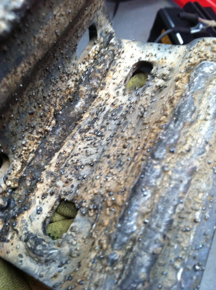

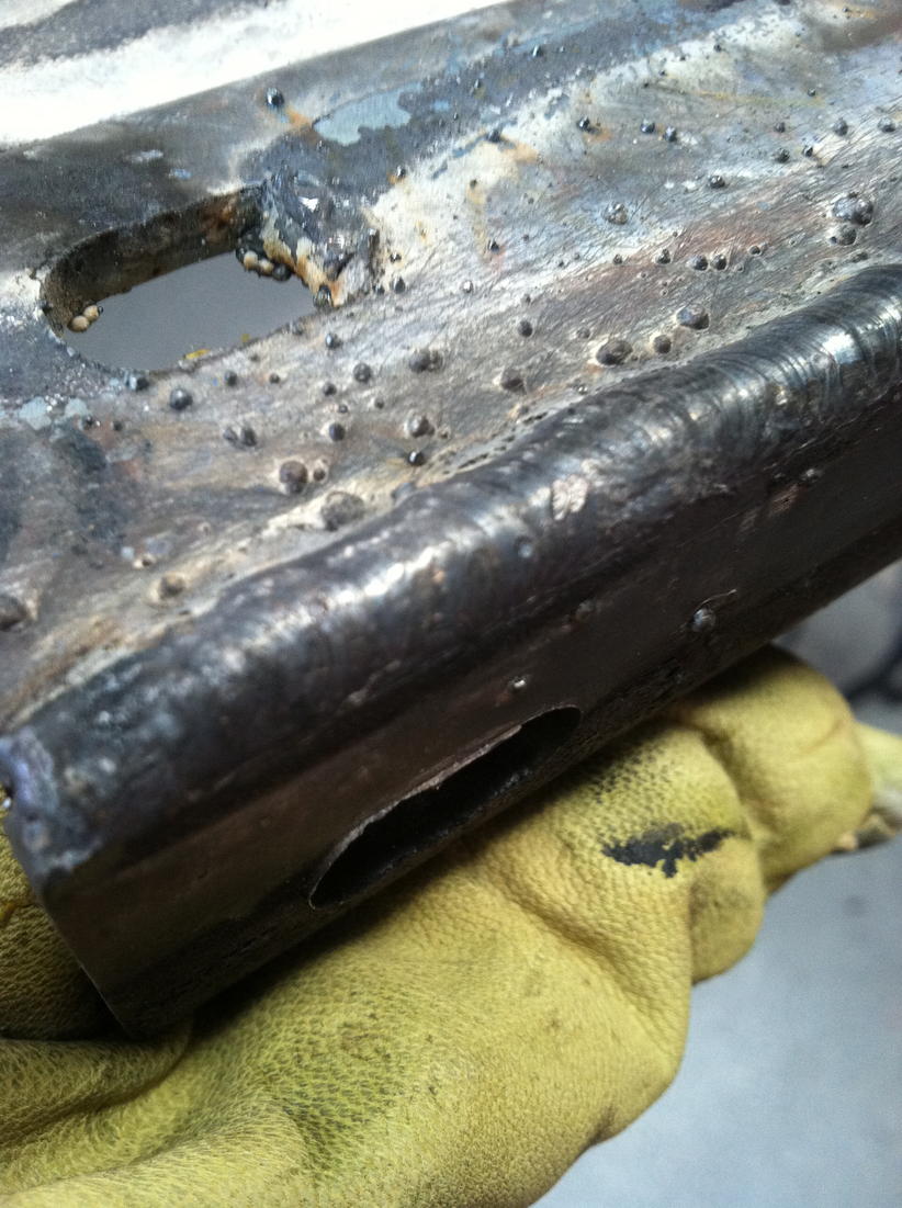

And now the other side, LOL. I don't know exactly what happened here, but it seems like the inside corner weld was just sitting on top? The beads I laid flat also had a LOT of splatter. I'm still working through that cheap H/F flux core wire, so maybe that's it? I dunno- it's still a learning game at this point (and will be for a few years I think...) HAHA!
Criticism welcome! Thanks again- Jeff

For a flux weld, it looks REALLY good!!
The first pic about 1/3 of the way through it looks like you sped up a little bit. Consistency is key. Keep a steady speed of movement and distance away from your material. Overall it looks awesome!
The lower pics, the additional splatter may be from too great of a distance between your gun and material. You will have some splatter that you cannot avoid because it's the nature of a flux welder.

Thanks man! The advice in this thread really helped- especially about making a pool and watching it follow the gun. It helps to have some clue at least LOL!
