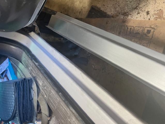

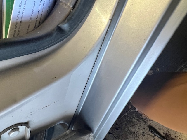

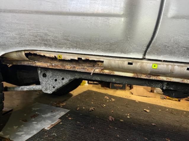

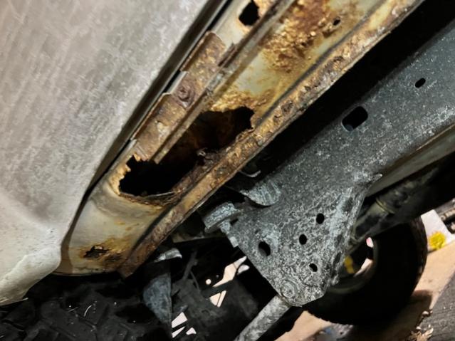

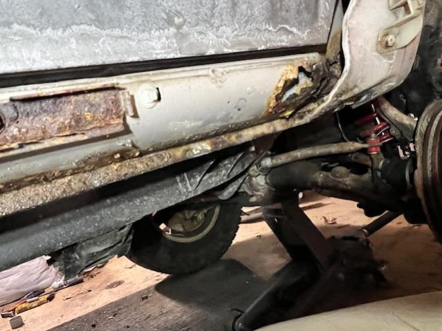

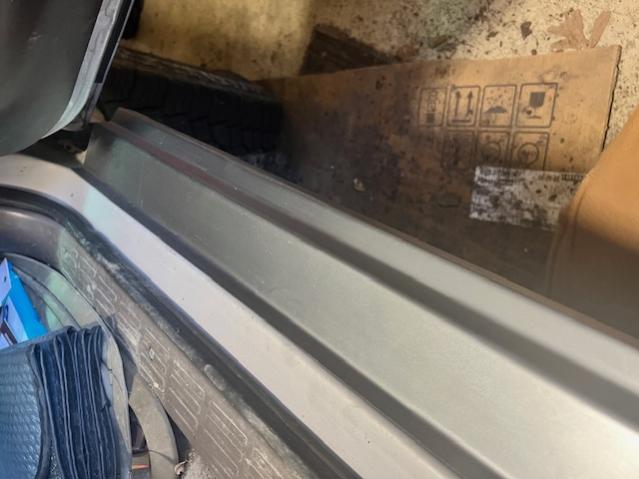

My rockers are gone and the limited cladding hid it for far too long. I ordered new rockers from Wolf Steel. My plan is to tack them up and have my welder buddy tig them in.
I preemptively cut my passenger side as initially I was going to fab something up like DirtGarage, but hopefully, I went the easier route with Wolfs.
For those that have installed Wolf Steel, how high did you have to cut your rockers? It looks like the shells from Wolf start at the floor pan?
Did you cut the Wolf rockers to fit where you cut your rockers? If you took them all the way up did you have to cut the middle section around the back door pillar?
At my current rocker cut and fit up of the Wolfs, I'm 2-3 inches from the pinch weld.

My Build thread shows you an option on how I did it. That entire subsection was rotted out on mine. So I used a 1 x 2 inch bar 16 gauge and welded that back in for more side impact strength... Then put the rockers over top of that. As this bars ties all 3 body mounts together as well as the extra steel for side impact. :)
