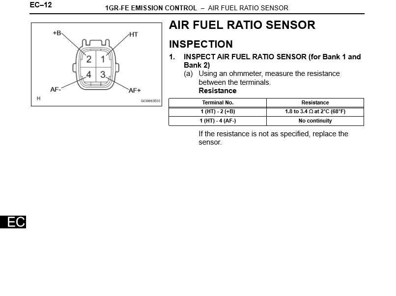

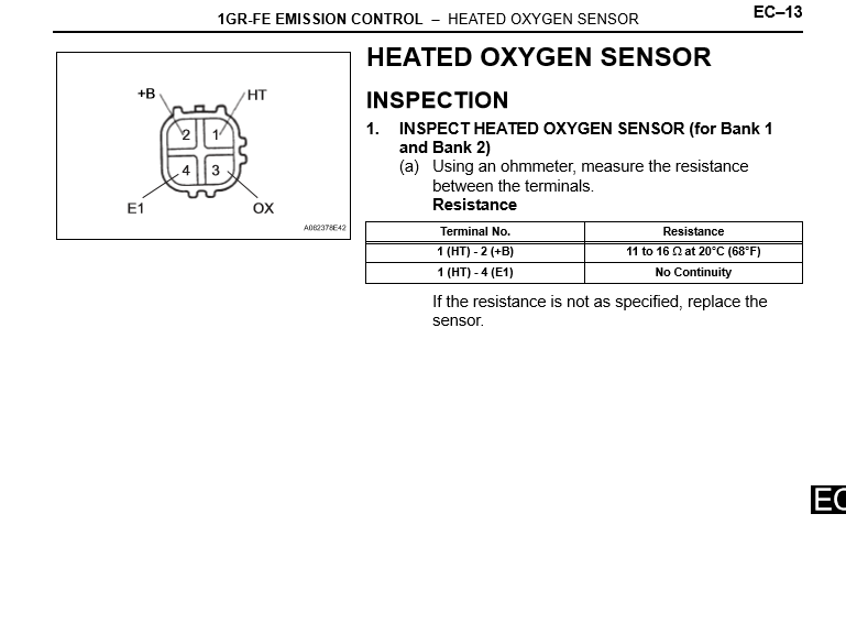

Thank you for that Earthrealm...
I tested the O2 sensor on bank 2 below the cat. It was 13
I also tested the A/F sensor above the cat. It was 2
Both were tested at about 69-70 degrees according to my IR thermometer.
So according to the FSM , they were both within their guidelines.
