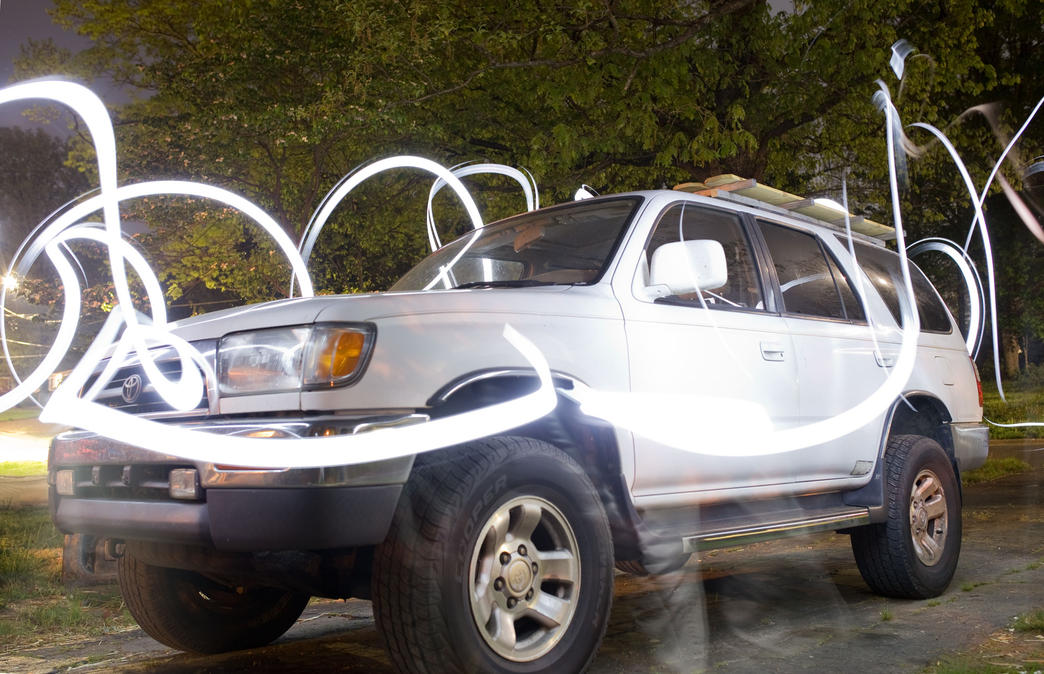

Is your roof rack made from fence?!??!
yup. lol.
the long bars are bolted onto the rack with stainless bolts right into the same thing the factory cross bars bolt into. Those are deck rail boards, maybe 1.25 square?
then the top is fence planks. Whole thing cost 12 bucks. I work as a photographer and often need a higher platform to stand on and plant my tripod. I had planned to buy aluminum and some other kind of decking, but it works so good i haven't made it a priority.
