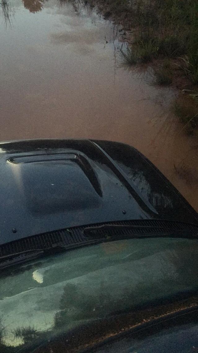

So..... I partially sunk my 4Runner. We were mudding (horrible idea will never be participating again) and all of the mud holes were about a foot deep, or so we thought. We went on one that was kinda separated from everything else and I sank down and water was half way up the headlights and poured into the car filling it up to the bottom of the seats. I cut the engine as soon as I sank so I didn't suck any water in and the air filter was completely dry. I think my exhaust sucked in water and dirt because it comes really close to starting but it won't. Any ideas? I think I'm about to just hack saw the exhaust pipe right after the 2nd cat.

Edit: judging by the picture i would be very suprised if you didnt suck in some water through your intake, even if you were quick about shutting the motor off.
