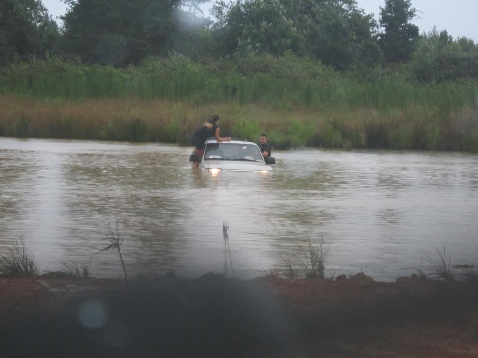

Any chance you might have filled up the exhaust with water enough to maybe fill the cat and muffler and stop the free flow of air through the system. With engine fully running it would have enough force to push all water out but just trying to start I don't think there to be enough airflow to push completely.
1) How High was the water when it came into the cabin?
--If it wasn't over the transmission tunnel, you have nothing to worry about as far as the ECUs and all that shit go. The body ECU is on the driver side of the truck, right above the driver side kickpanel, behind the dash. It's got a bunch of fuses on there, but it also controls everything that has to do with the body/ignition.
2) Your transmission is probably F*CKED. IF water came into your cabin, you got water in your transmission. Flush, and fill, but be ready for it to go out on you.
3) Flush and fill your diffs.

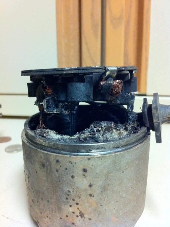

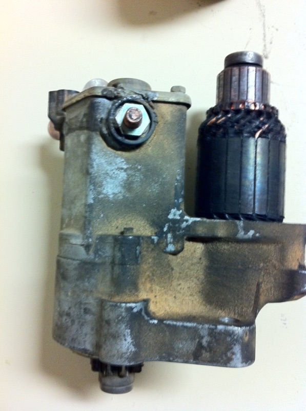

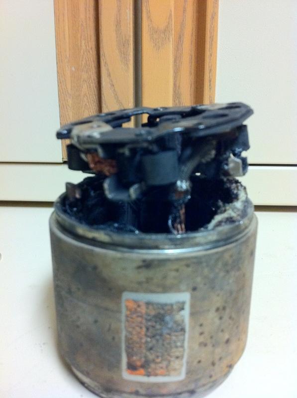

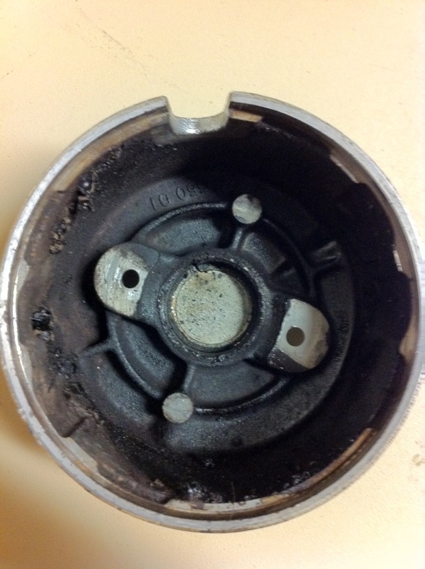

4) Your starter is probably f*cked as well. take it off, go to a junk yard, and try to get a new one.

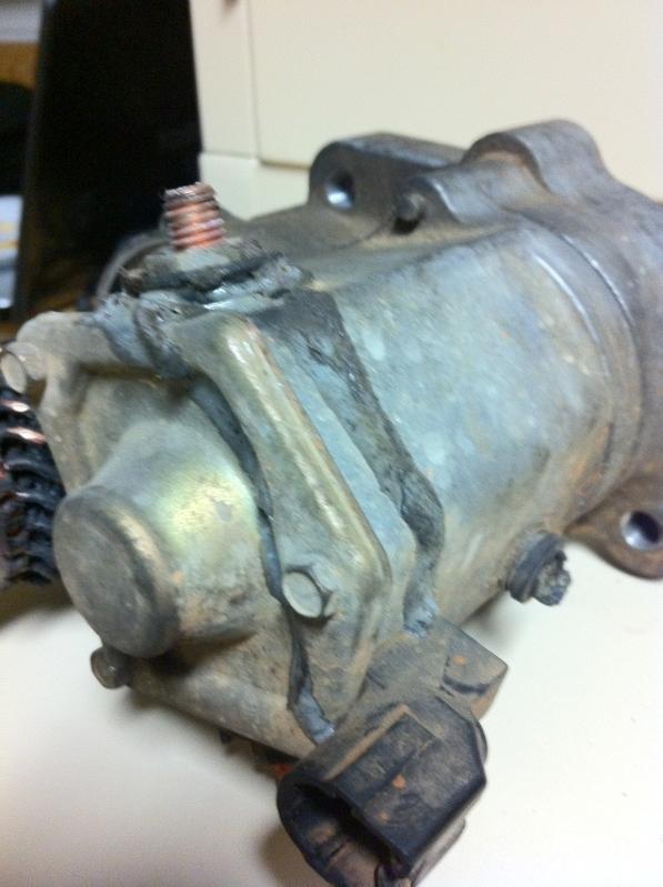

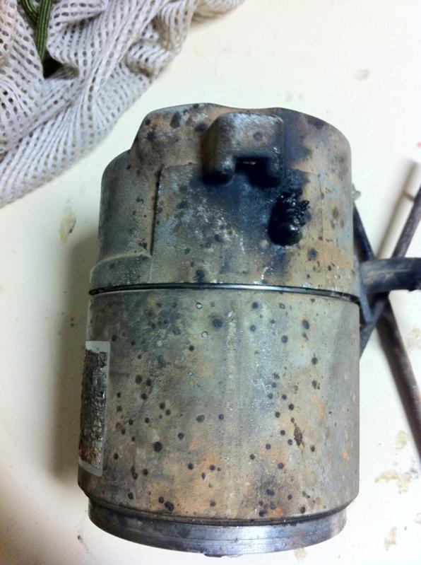

And, just for shits and giggles:

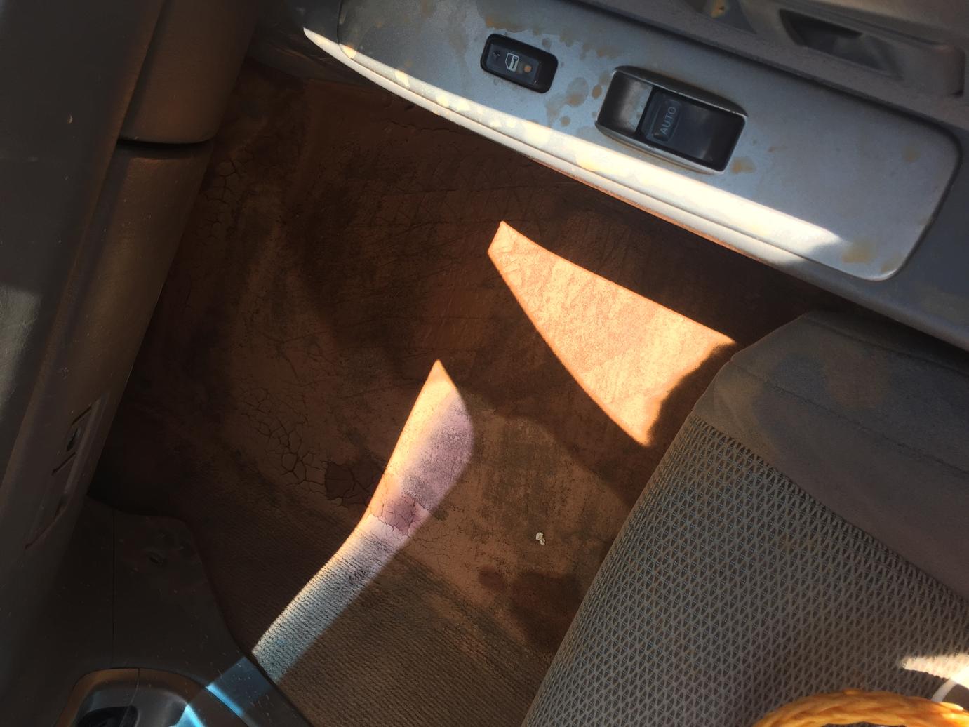

I plan on checking everything when I clean the carpet and seats. That is the plan, I'm going to remove the seats and carpet this afternoon and pressure wash everything with some water and "purple power" from Walmart. It's around 100 right now here in SC so that's exactly what I've been doing.
Im not sure you want to use purple power on plastic or on fabric... maybe some simple green or good ole fashion Dawn soap?
I wouldn't pressure wash anything either. Good ol' elbow grease and the hose to avoid anymore stuff from getting wet that shouldn't.
having been in this exact situation. replace your starter contacts, the starter is probably filled with mud.
you will need a half inch ratchet set and universal joint to get it undone.

After you clean a lot of mud off the carpet I've read that you can put it in one of the "Big Boy" washers at a laundromat. I'd use about a cup of Simple Green and wash it twice. Then you have to let it air dry.
As someone said I don't think you should power wash the inside. It injects water in places you don't need it. A hose would be better controlled. Seats and carpet removed can be power washed.

Great thanks! I've got a feeling that they aren't going to be too fond of me there. But yea, Ive already removed everything and I pressure washed most of the dirt out of my carpet, the inside I covered EVERYTHING and cleaned with a hose. The mud UNDER the carpet was thicker than the mud on the carpet :noidea: My rear seat heater is probably toast. By the way... Does anyone know how to get water out of a headlight?
