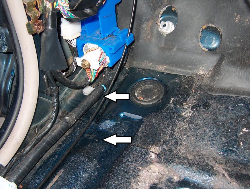

So, couldn't attend the problem in over a week. But got nice rain today and I was able pinpoint the spot, where the water appears first. Looks like it's seeping through right underneath the cable attached to the floor. Will try pull the plastic hook out of the floor and lift and secure the whole cable assembly to figure out exact entry point. It's kind of tricky looking down there while driiving in poring rain :-D Will try carwash on the weekend - might be enough for the water start getting in.

Looks like I'll have to take that blue electric connector box out somehow - I saw the water running down in the corner behind that box and underneath the rubber insulation pad on firewall.
