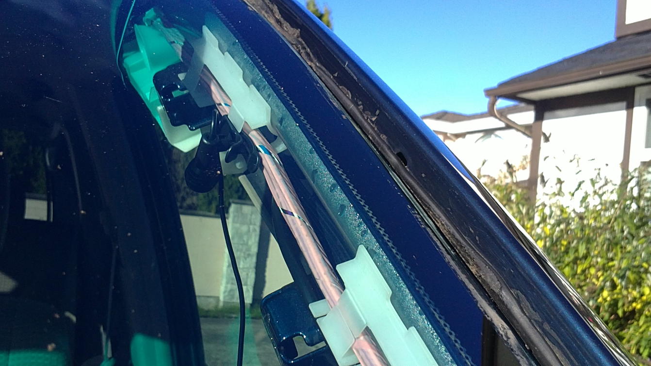

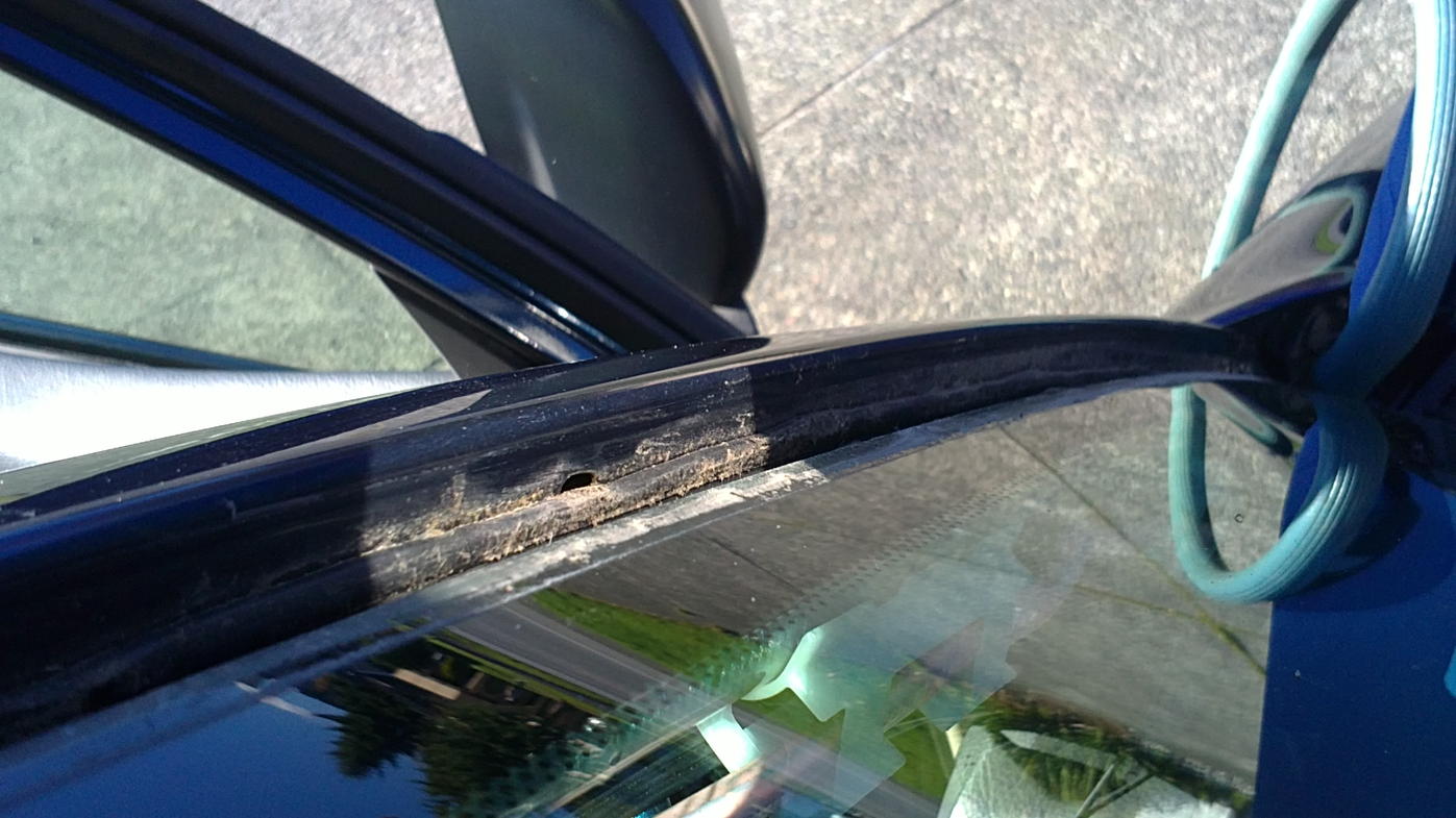

OK, happy to inform you that the problem of wet floor is solved (with help of many people here giving their input - thank you guys for that)
I discovered, after pulling out the side windshield weatherstrip away from A-pillar, that there were 2 holes partially covered by glue when windshield was replaced (sometimes in past). However, they were not plugged by anything nor fully covered by glue. They were just open right to the A-pillar!!
Assuming (hoping) this could be the entry for the water seeping through I used marine silicone and sealed both holes, let it dry overnight and tested it with garden hose for over an hour - floor came out dry. No signs of any water anywhere.
When I was hosing down the windshield before, water appeared on the floor in few minutes. I could also see water seeping through between metal edge of A-pillar and the glue (of the windshield).

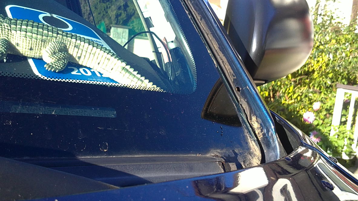

So I hope I'm done with this issue. I post few pics of the holes - 1st of the pics was taken from the roof-down direction so don't get confused. Somebody here mentioned 3 holes - I saw only 2, maybe 3rd one was covered by the glue already ... Either way - how could glass guys replacing the windshield miss that???

And this is the second hole in upper part of the A-pillar
Thanks for posting pics - was kicking myself for not doing the same when I had them filled. The 3rd hole sits higher up but they aren't equidistant.
Off topic but you have what appears to be an alligator on your dash - be careful man! See what those leaky windshields can attract?!:fishing:
