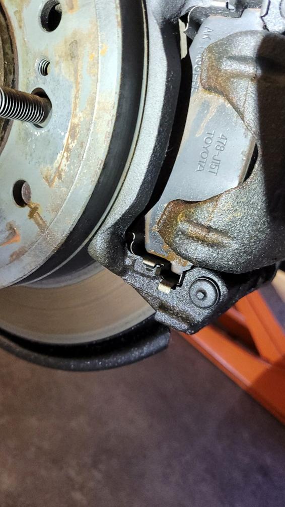

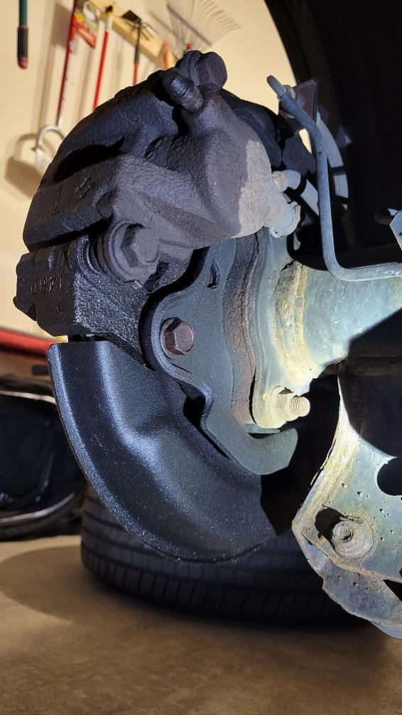

This is for my 2014 GX460, but I believe GX and 4Runner share same brake components so posting here for help.
I just found out the rear brake calipers (both sides, a little worse on left side) are wet and possibly leaking brake fluid. But I haven't yet had a low brake fluid and it still brakes fine.
First thought it might be from rain or carwash, but it hasn't rained here for last 5 days and I haven't taken it to carwash in the last week either.
It must be from brake caliper, right? Is it from the bleeder valve?
I looked at the piston but piston seal seems fine, it's dry there. But around the edge of rotor, splash shield, even the front of the caliper is wet.
Do I need a new caliper?
Thanks for your help!

Looks like either brake fluid or the axle seal is leaking gear oil. Does it have a strong smell? If so it’s gear oil.
Can you put a wrench on the bleeder valves and gently snug those up?
Easiest way to to tell will be to take the caliper off and inspect it more completely. While you have the caliper off, go ahead and pull the rear rotor off. My suspicion is that you're looking at an axle seal leak; usually the backing plate and the bearing housing (between the brake backing plate and axle flange) shows signs of seepage. But it does look more like an axle seal.
If it is an axle seal leak, I highly recommend replacing the bearing as well.The reason being the axle seal keeps fluid in the axle tube/axle assembly, when they leak it let's gear oil wash through the bearing on its way out to leaking over the parking brake assembly.
Checking both brake fluid level (at the reservoir under the hood) and the rear diff fluid level at the rear diff fill port should yield more info. Have car on level ground when checking. I agree that it looks like an axel seal issue; and diff gear lube fluid has a real distinct smell, so it should be easy to tell which is the culprit.
I had similar situation but not as bad. Turned out it was the outer rear axle seal. Replaced bearing, outer and inner seal. Mine was only on the driver side. If your not low on brake fluid, I’d check your rear axle.
Thank you everybody for pointing out the possibility of rear axle seal leak. I did not think of that. And as I do more research on that issue, it's a telltale sign of axle seal leak, and to confirm, I can smell it!
Now I kind of wish it was brake caliper - that's much easier issue.
Looks like I am looking at new axle seal, wheel bearing, parking brake shoes, and rear brake pads.
